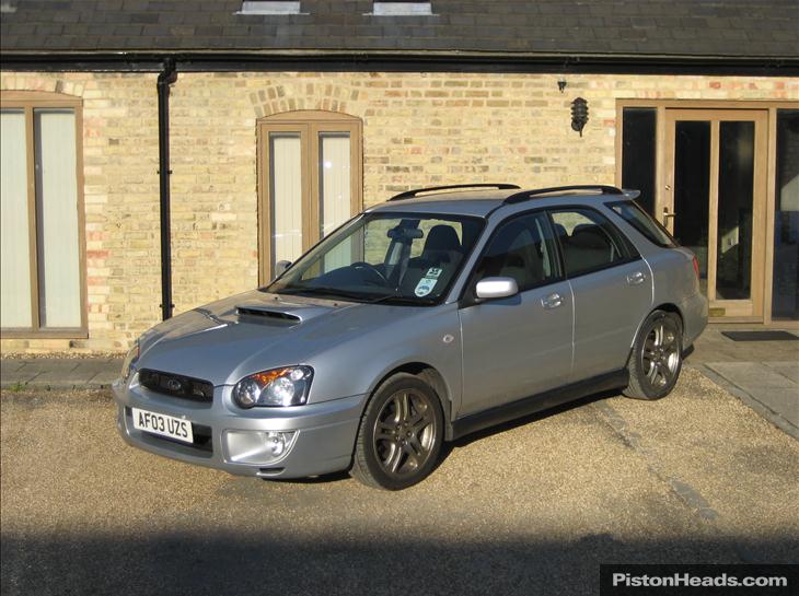

DaveDreads
How reliable are the classic wagons?
I don't want to swap one unreliable car or another.
This is my favourite shaped wagon, but good ones are the same price as old STi Wagons.
I just want one that's comfortable, reliable, and is capable of doing a journey of a few hundred miles with ease.
This one looks alright though.
http://classifieds.pistonheads.com/...aru-impreza-sti-v5-estate-fresh-import/939730

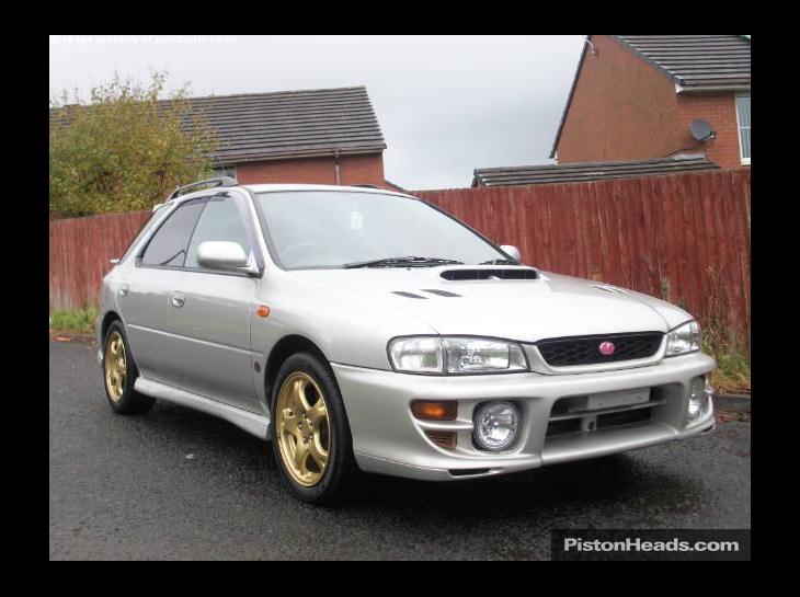

TheEvilGiraffe
South East - Essex
There's reliable and unreliable ones out there.
My old one was a royal pig but the current steed is alright so far!
Equally immensely helpful as well.
You're welcome.... :eek:
DaveDreads
That is exactly what i'm after,
my favourite shape with some decent mods, I want it now!!!
Sadly it'll be March by the time i've got the money,
i've a few photo jobs lined that should get me back on track with saving.
