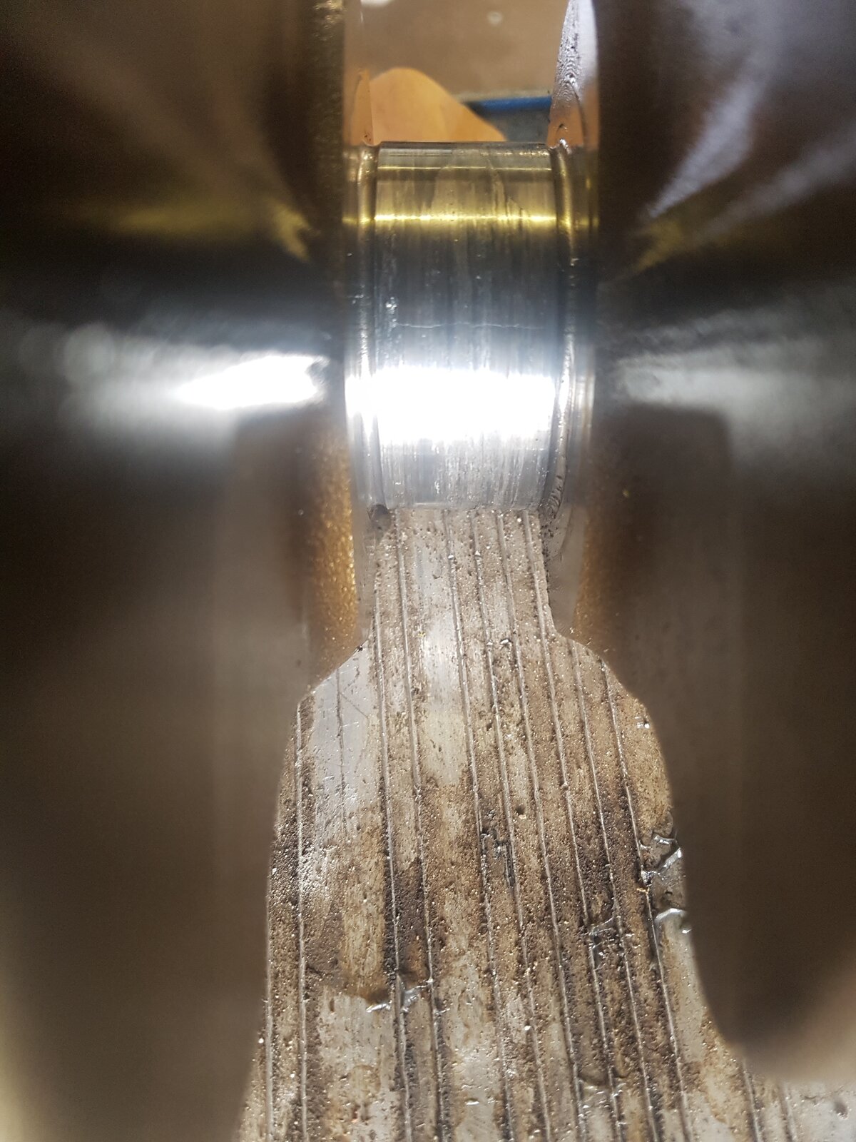

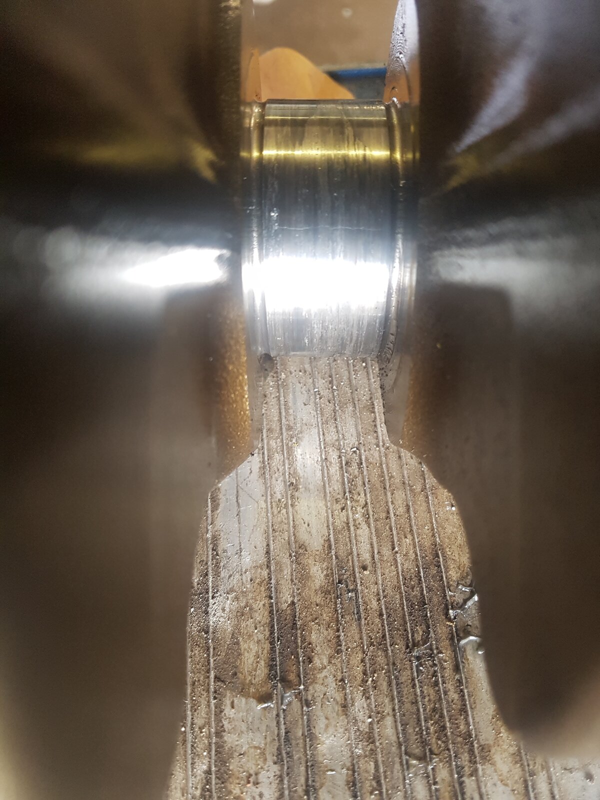

4th crank i've pulled out inside a year that's cracked across the big end journal!! no blueing to the rod and minimal on the side of the shell.
sorry pic isn't the best.

What’s the mileage?
Has the crack marked the bearings, or is there a chance the crack would go unnoticed - if the engine wasn’t pulled apart?
  dan's cast offs.
Was meant to of been a low mileage engine, came out for a boost conversion.
Crack wasn't there before it picked up on the bearing. Was the one thing I checked for before I even thought about using the crank.
If you weren't looking for the crack it's very easy to miss. Forst one I had wasn't spotted until after the crank had been polished.
