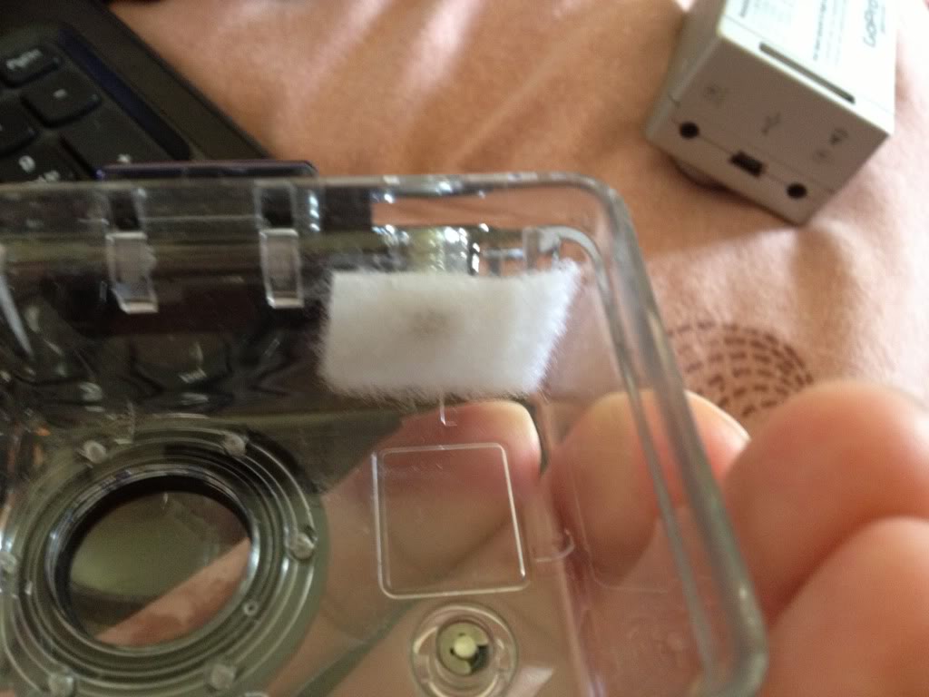

I noticed this noise on my Hero 2 and what I did was cut a piece of cardboard and placed it in the sliding / squeezing Clip bit and it's wedged in now , but it's as quiet as a mouse - none of that clicking noise over the recording.
Did a track day in Dec and annoyingly the clicking was still there.
Original HD hero. I know the big knocks are the mount on the bumper which I understand. Im starting to wonder now if its the start/stop button on the top thats vibrating as ive seen a few videos online! Its very frustrating and a very irritating noise!
I have some really good furry tape we use on the cars , I'll try and pop some under the button and test this theory.

It is the start stop button, I sent mine back to GoPro and they sent me out a new unit but it's the same! I modified my case with the fluffy part from Velcro like this and it's a lot better!

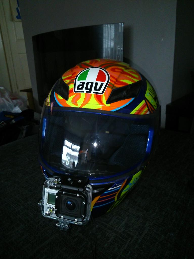

this is my 'chin mount', only used it once on the bike so far..
