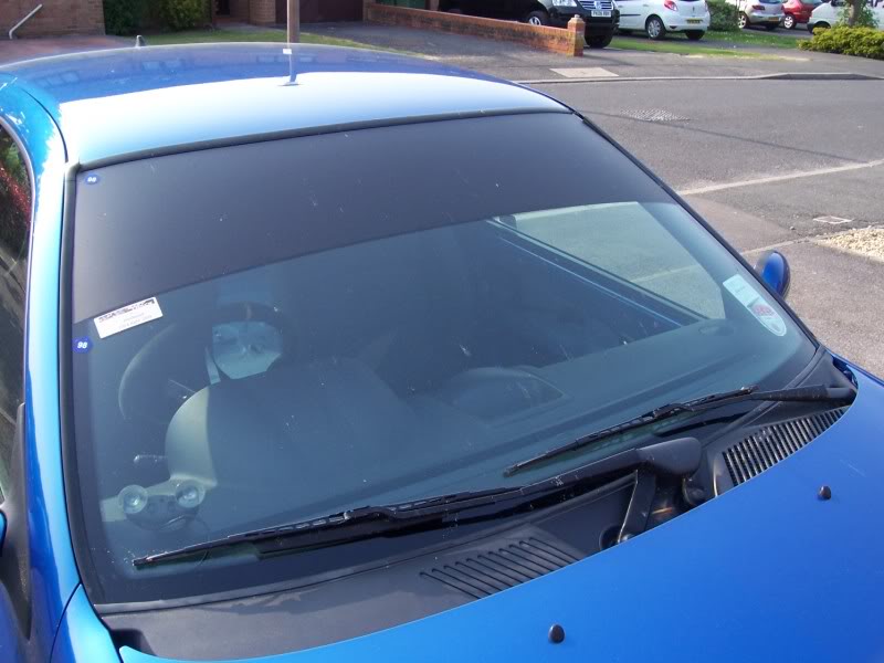

I personally went as deep as I could as I had my arse on the floor of the car, came down the windscreen almost half way.

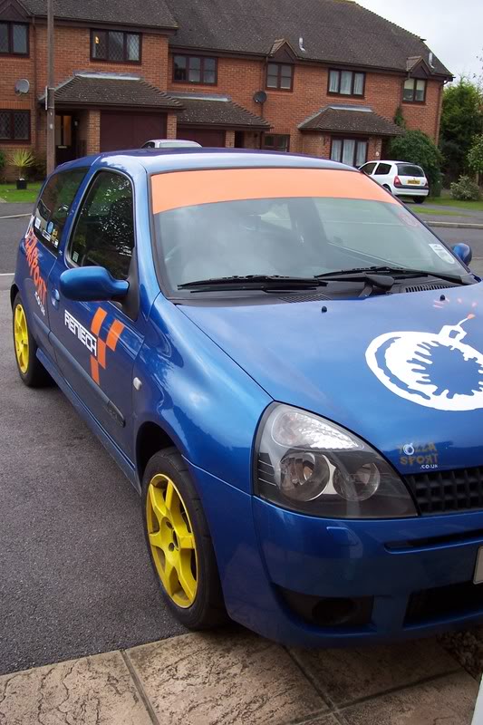

I ran opaque ones, started with yellow, then orange, then white, then decided to go for matt black so it wasn't so noticeable.

If you only go as far as the visors do then I can't see it being too offensive. However I really do advise going for a black one.
