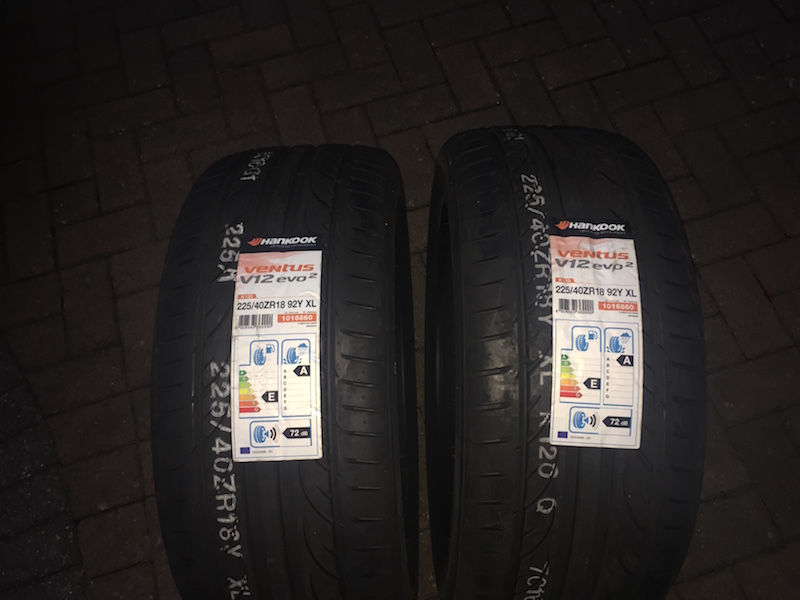

Just bought a decent set of tyres for the front as the cheap ditch finders are no good.
I know its silly but I'm going to stick the ditch finders on the back as there is still 7mm tread on them and it would be a waste just to throw them out.
Putting these on the front.

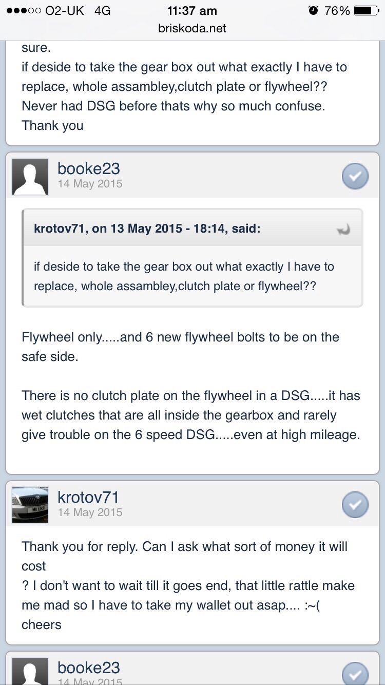

Also just had a new rear door lock fitted , boot solenoid fitted and the biggest problem of them all . . . . . . . . . The DMF !!
Just had that done today at an Audi Specialist , Never went with the Solid flywheel and just stuck with the dual.
Was a genuine LUK unit & bolts that where done.

Keep the Ditch finders on the front
You want the better set at the rear

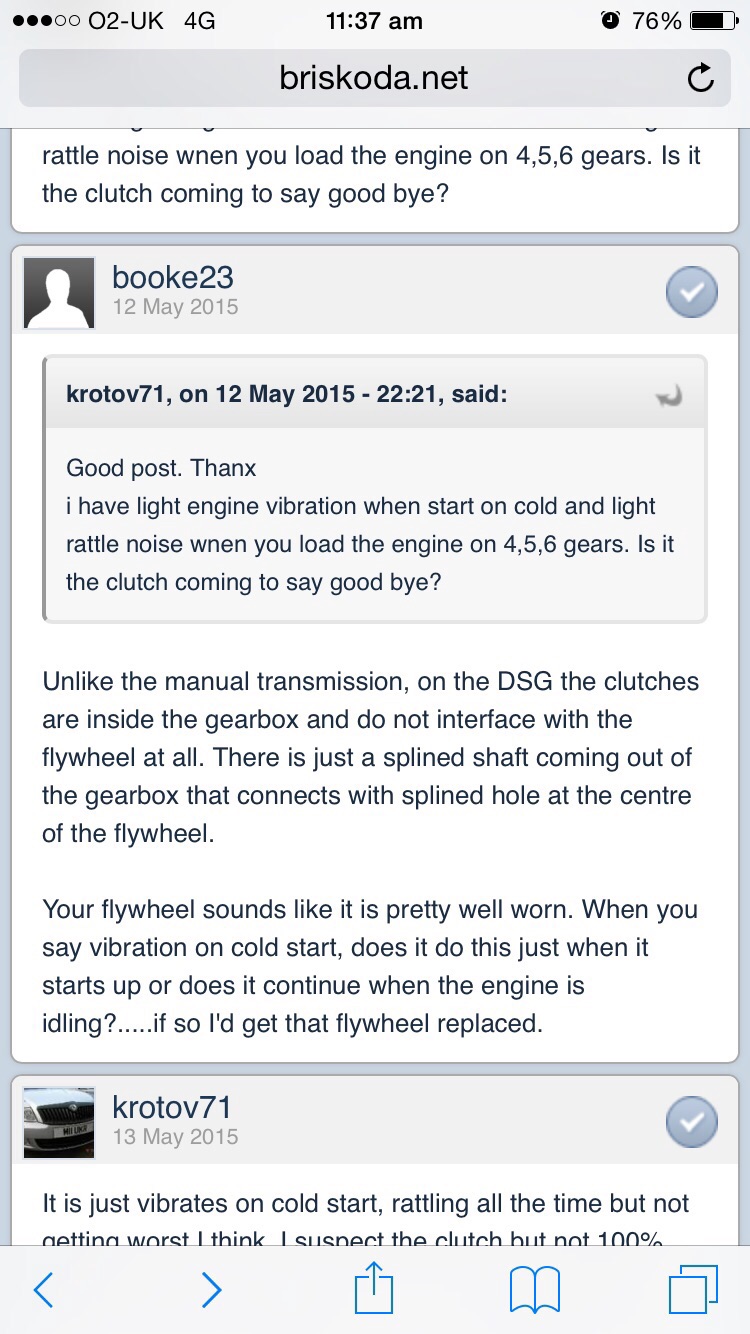

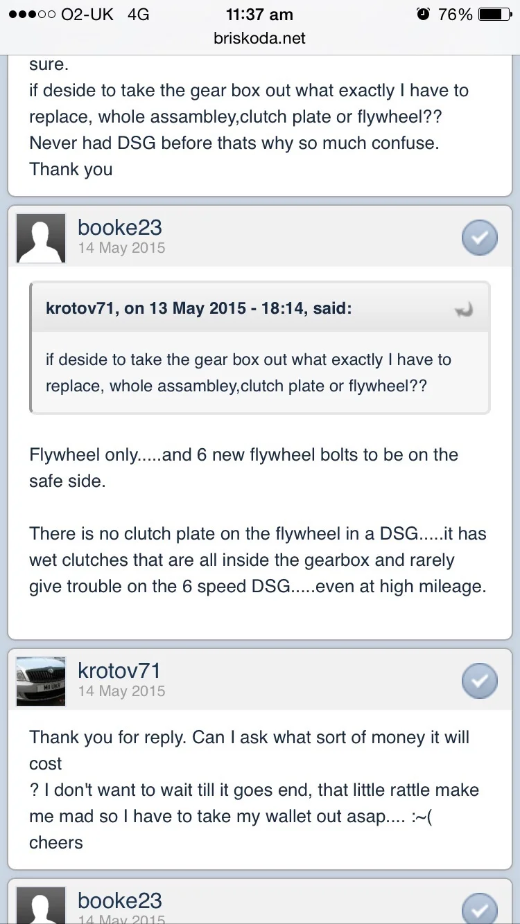

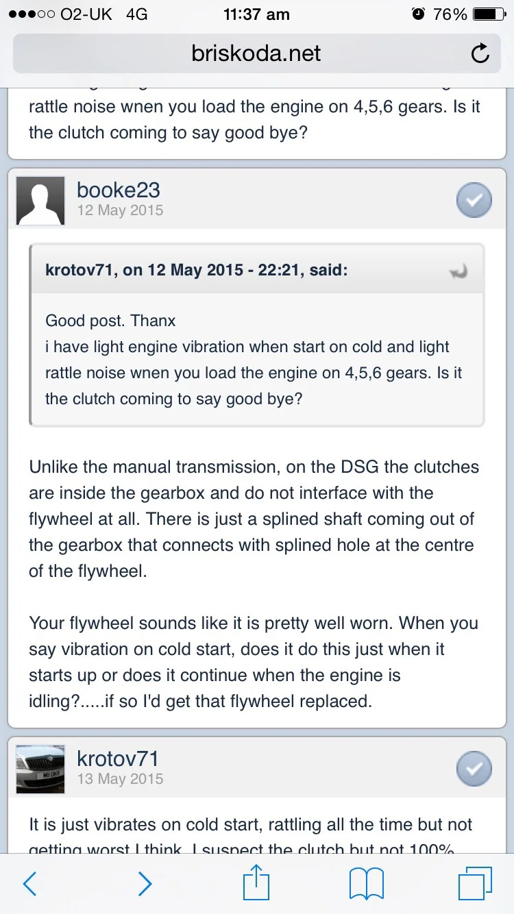

I knew the dual mass was on its way as I heard it and as I worked for Audi / VW for 6 years I had a good idea.
The clutch does not get changed on a DSG box as its a wet clutch inside the box and not a standard clutch.
It was all covered under warranty and I never paid a penny and I even got to choose the garage it went to to get repaired.
The two ditch finders are only on the back for a month and I will buy another two tyres to match the fronts so all 4 are the same
Dual mass and new starter motor fitted and now its perfect.
