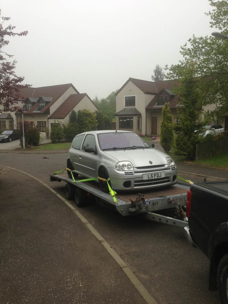

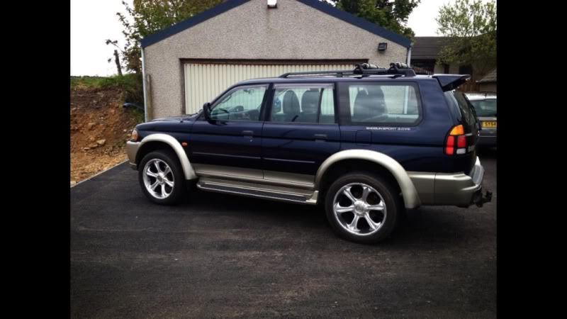

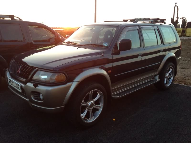

How I received it just over a week ago, not a fan if the 20" alloys.

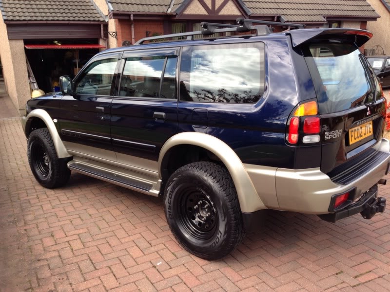

I got rid of the dubs for something a bit better IMO.

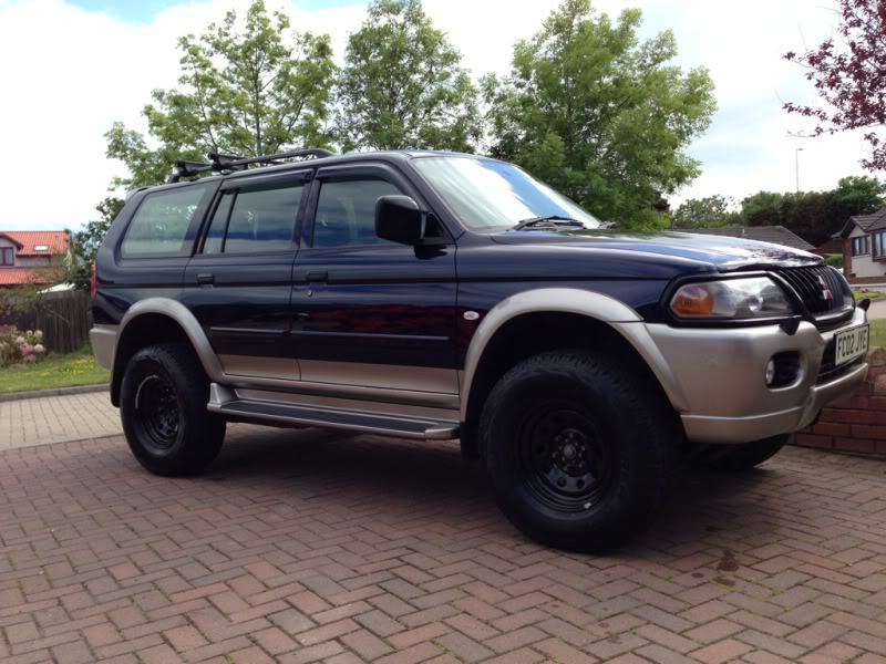

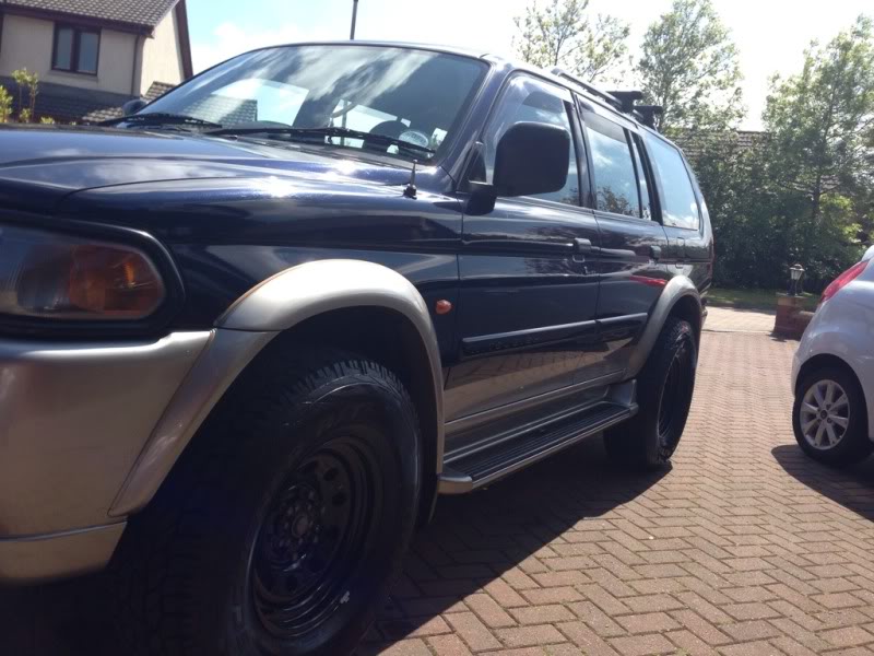

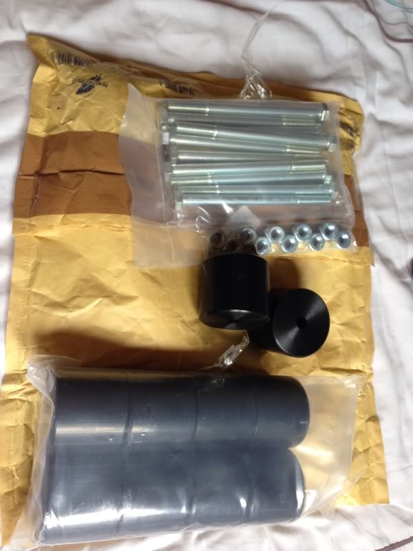

I then done a 2" body lift to accommodate the tyres a little better.

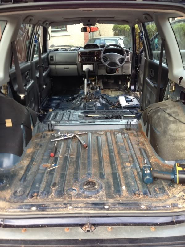

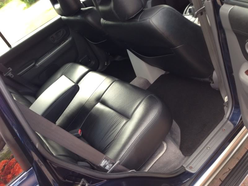

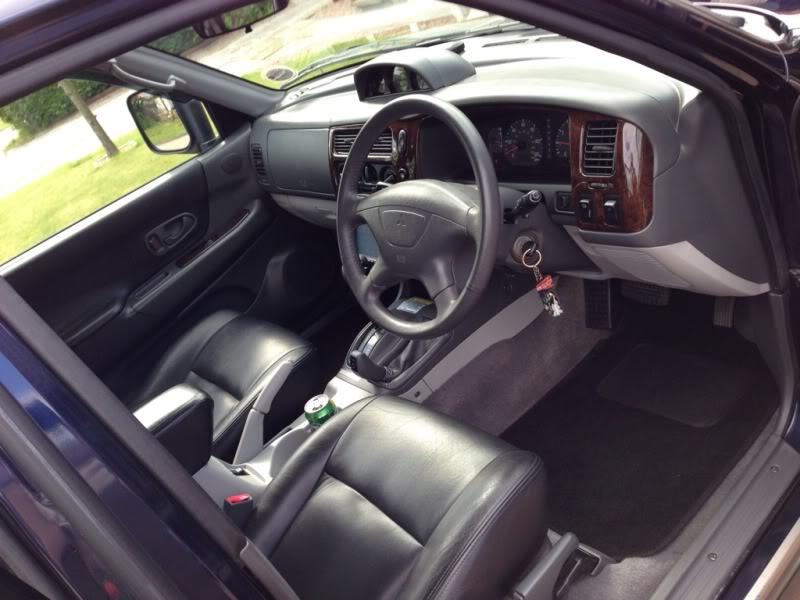

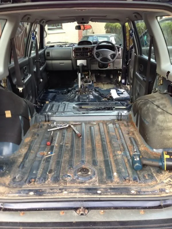

While doing the body lift I whipped out the interior to give everything a wet vac.

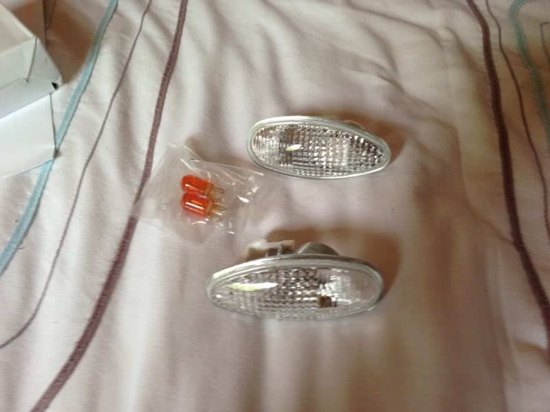

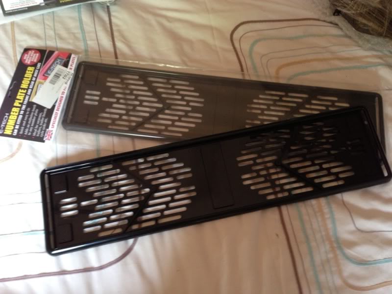

I polished it up today including new plates and surrounds, clear indicators, new tinted wind deflectors, new fitted mats.
I then cleaned and conditioned the leathers.

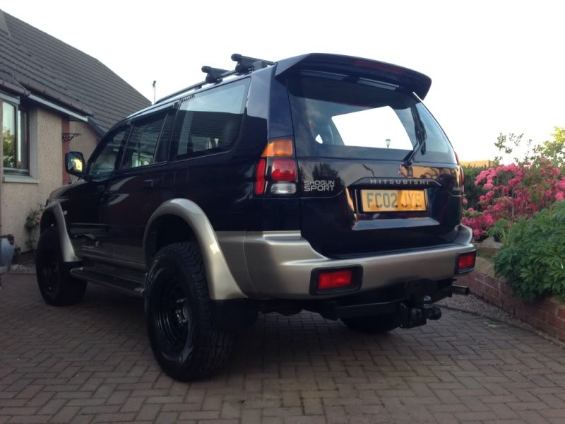

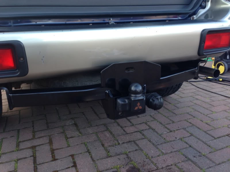

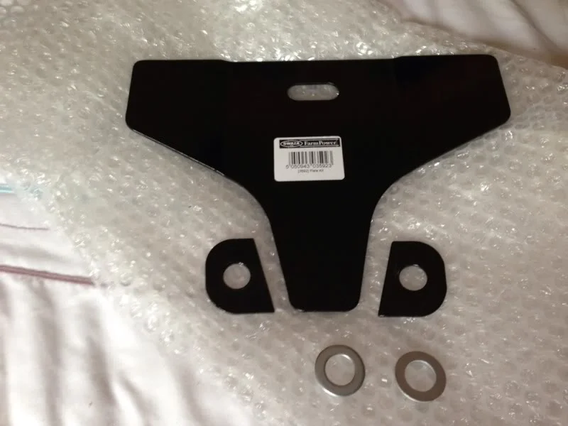

And finally I sorted out tow bar electrics, fitted new bash plate and plug holder and gave everything a paint.

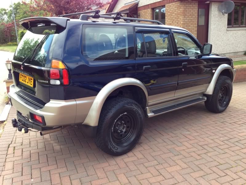

How I left the car tonight, all that's left to do is a top ball joint, lambda sensor for the MOT in August and fit a full new decal set.

I quite like that, loving the lift also!
Yeah looks alright considering the two tone.
This makes Range Rovers look like hairdresser's cars!
Towers over them, its great on the road.
Much better now the wheels have been changed.
dedication removing the whole interior for a clean.
Changes it from a chelsea tractor to a mean looking 4x4 i think. Dedication or sad, you decide. I usually do it to older cars, especially if they have had dogs in like this one.

Will you not need to drop the towball down a little further though to tow with it? Those tyres and lift dont look much different to what I had on my hilux and I had to drop the towball quite a way to meet a normal car trailer.

​I thought that. The trailer will be scraping the floor at the back!

re tow bar. I had the trailer hooked up the other night and it was slightly rear axle heavy, I'm hoping when the weight goes on it will even out. I am in the top hole on the bar just now, when I get the car on and it looks funny I will drop it down. Its a 2" body lift so the chassis stays the same height and the radius of the wheel has only been increased by 1" over standard so not massively different in height which you wouldn't think by the stance.

Extra weight on the trailer is going to compress the tyres on the trailer and drop its height down, thus making it further from the car not better, so I think you might be onto a bit of a loser in terms of thinking that will make things better.
Just a case of trying it and measuring up though really.
It will tow pretty horribly if you get it wrong.
Yeah it does look like more than an inch, maybe its just the pictures!
Thing is though even a lot of standard off roaders still need drop brackets.
  Cup In bits
Yeah see how it goes, the rear of the jeep drops a good bit just with the trailer on so it will sit down more with the car, trailer tyres dont move much as there up at 80psi ( GTW 2600kg trailer)
I will definately take it on a short test tow Friday before I head of on Sat to Knockhill. I last towed it with a defender and that drove like a cruise liner, was real hard work and dropping the tow hitch might have been the answer. Luckily enough this one has multi holes on the tow bar :)
  182/RS2/ Turbo/Mk1
If you drop the back of the car with a load of nose weight from the trailer, that will make it tow poorly too, front end going light etc.
No drama at all though if its got extra holes, I would just lower it a bit straight away before I ever tried it TBH if you have that option.

Get it done, not sure how easy it is compared to the lift on this which is quite easy as all the pipes, linkages etc are long enough thankfully.
I think the way to do it is load the trailer, put up the jockey wheel and centralise the car untill the trailer sits horizontal then get your tow ball height as close as possible then hook up to tow car?????
Yeah and then you can tweak the car forward or back a little on the trailer if needed for getting just a touch of nose weight.

Great work, especially impressed with removing everything to get it spic and span, Id defo buy a used vehicle from you sir

That looks cracking. I was expecting a shed, but that's a luxury living room in there!!
Muts even got a touch of walnut detailing (plastic)
Yeah all my cars are kept as immaculate as possible, having a known fault or being dirty plays on my mind. I guess it comes from being a mechy to trade.

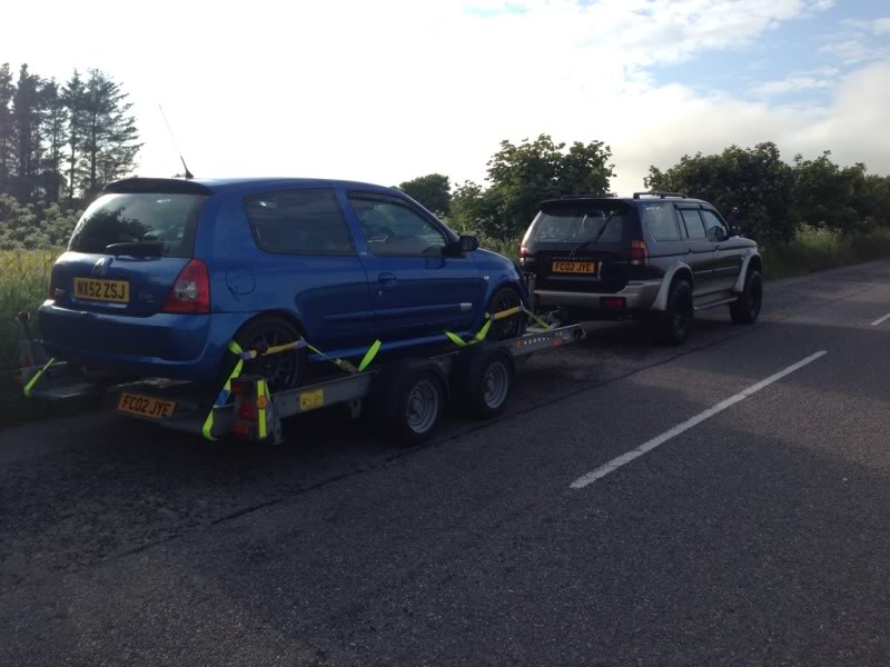

Balanced it detached from the jeep untill I couldn't quite pick up the trailer by hand and marked it for future. Jeep looks like its ready to wheelie haha. Its got a full boot load tools, spares and everything to camp including blow up double beds, 6mx3m tent, crates of beer, food, barbecue the lot haha. Tow's like a boss though.

Same as how I load my trailer but I normally have a rack of 8 tyres at the front making things even worse lol
Yeah i bet. Thats a good point, can you fit 8x 15" 7j wheels on a Brian james high level rack? I'm looking to get a BJ one and retro fit it to my IW as they don't offer one.
