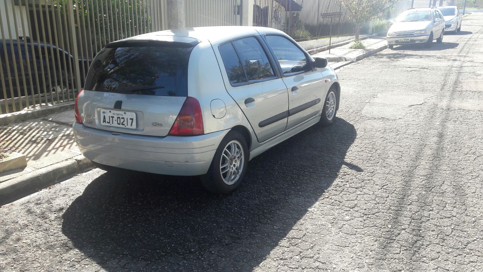

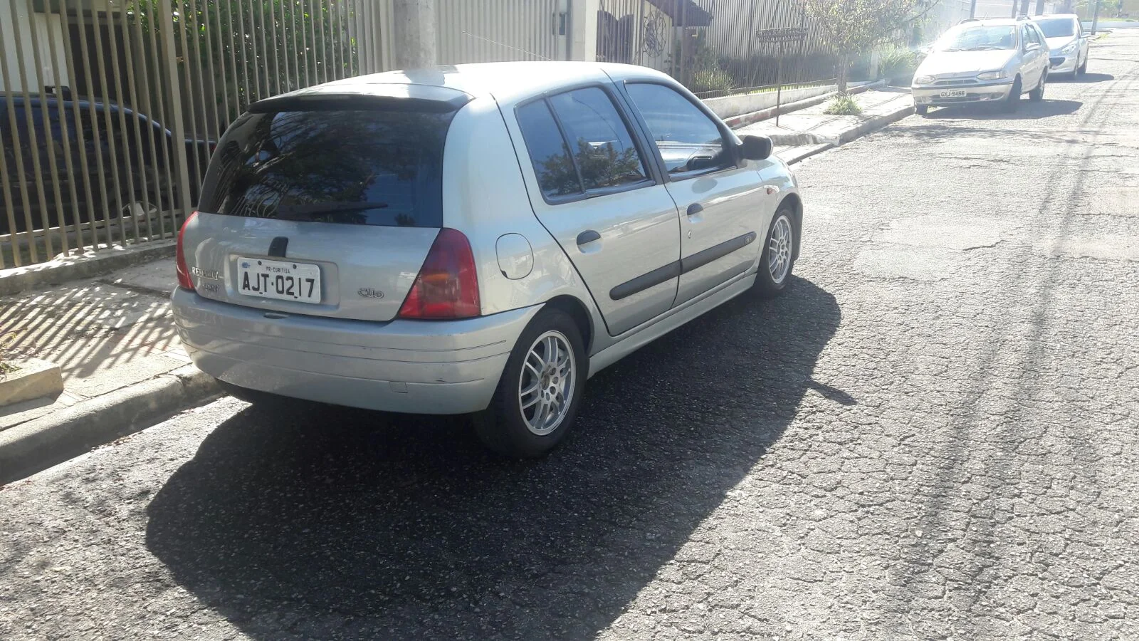

I'm just a fan of Renault Clio RS, and I dream I could have something similar to that one day. I had others 1.0l Clio and Dacia Sandero before I bought this one:

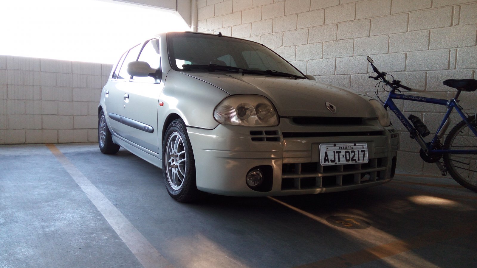

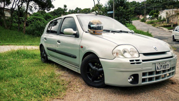

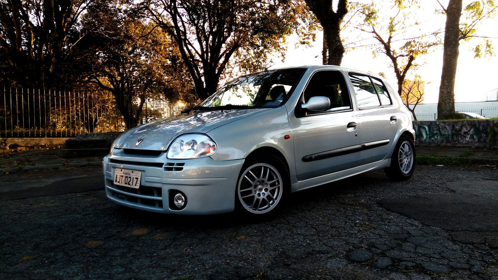

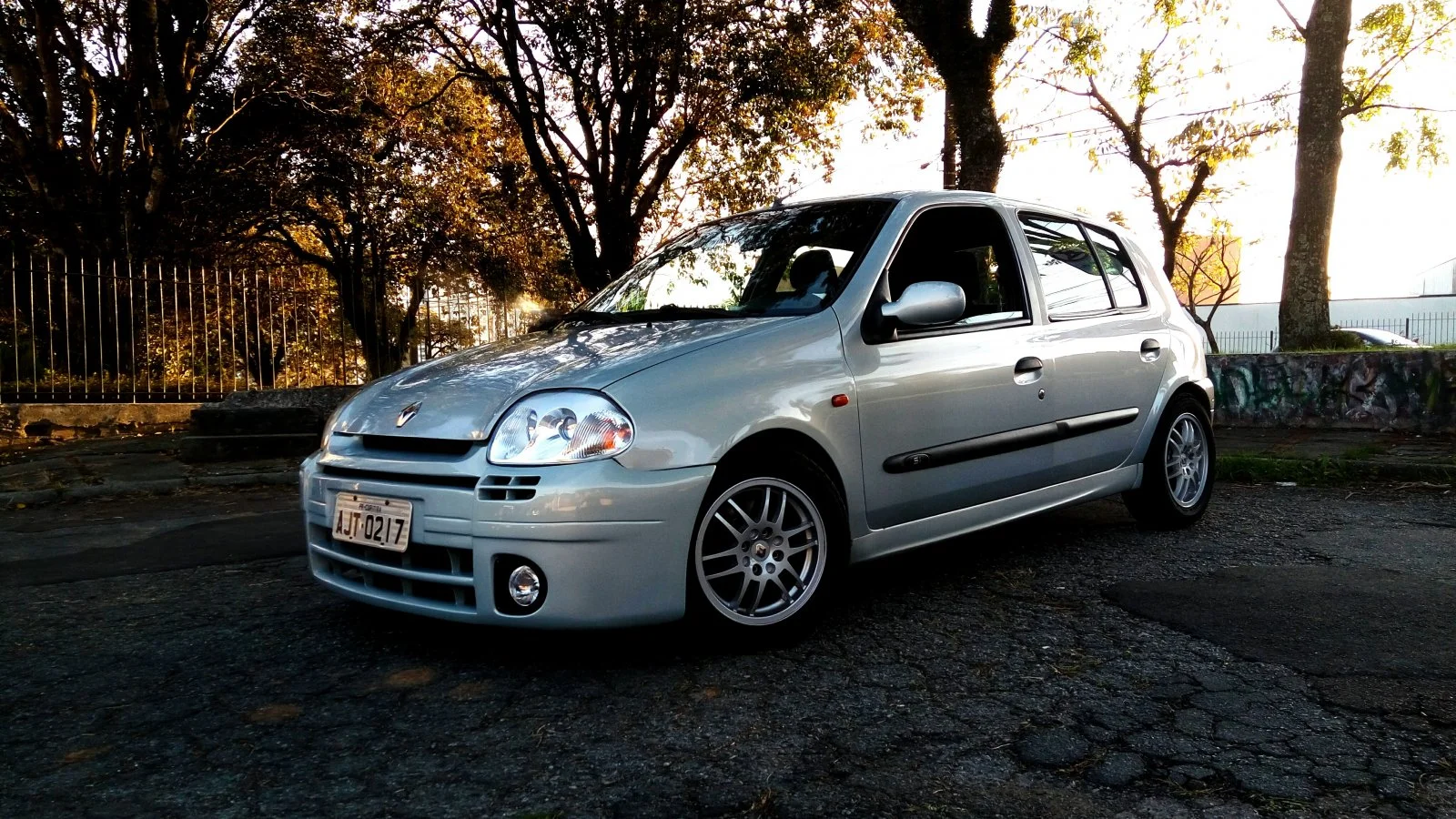

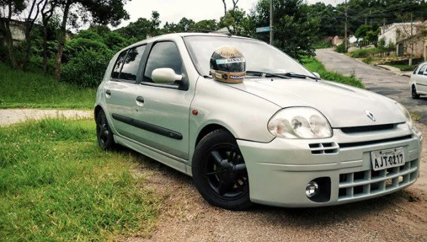

This is a "Sport 1.6" K4M engine, and 4 door :( the best Clio mk2 offered here. I decided to make it more sportive, the first step would be new bumpers replica of RS, and painted the wheels:
Now for mechanical upgrades I don't have anything similar to RS. It's using K4M, I installed a JB1 gear box for a higher ratio, eibach springs, polyurethane bushing on suspension and minor stuffs: new exaust, perfomance air filter (those simple crap things).
The big stuff I want to do is change the car side to 2 door. It would be remove 4 door and sold the car side of another (phase 2) Clio. Is it too much?

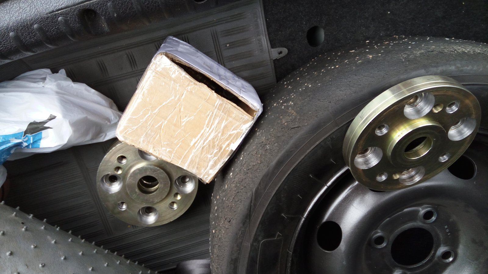

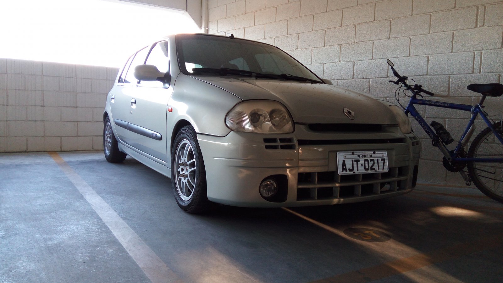

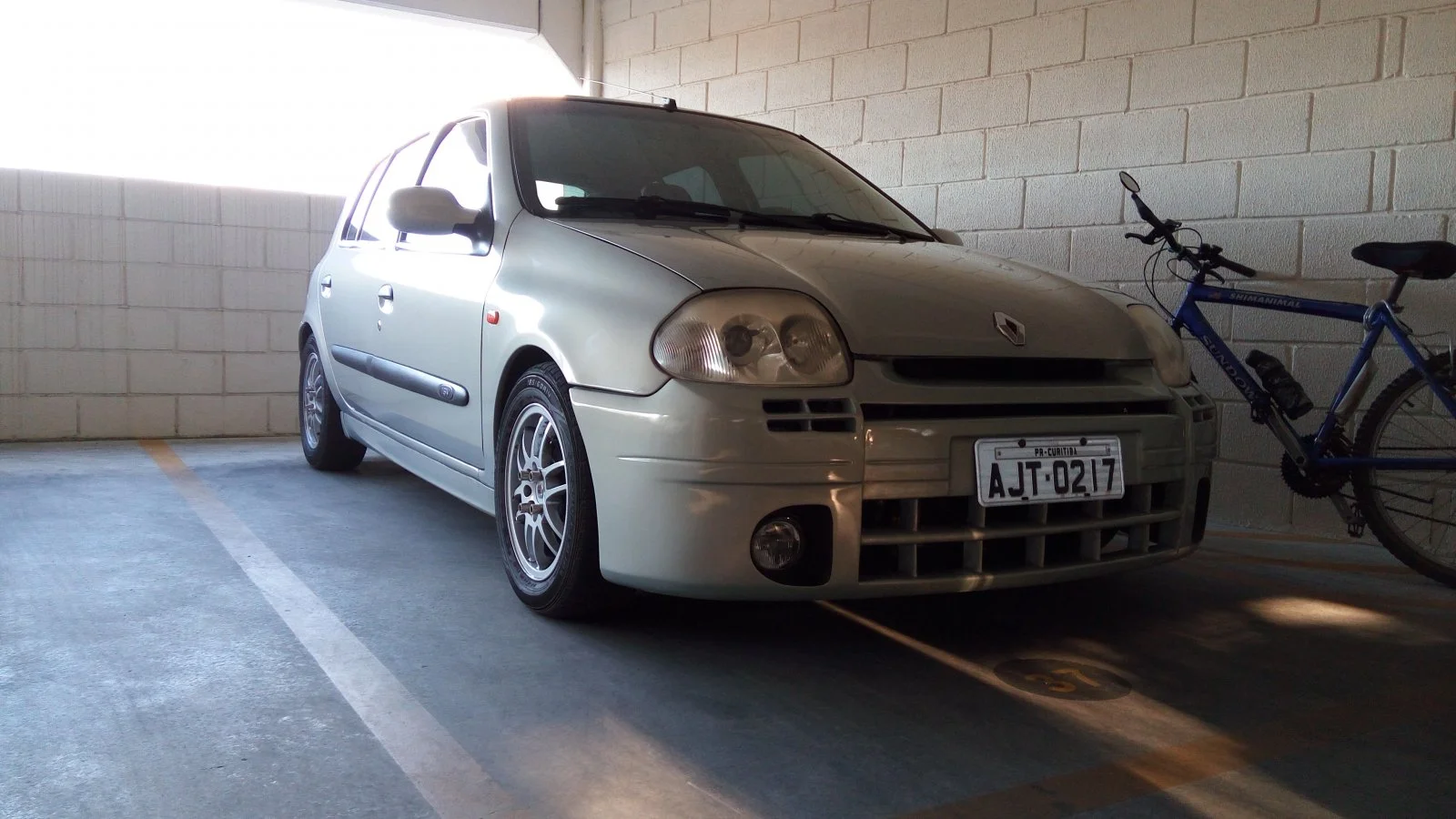

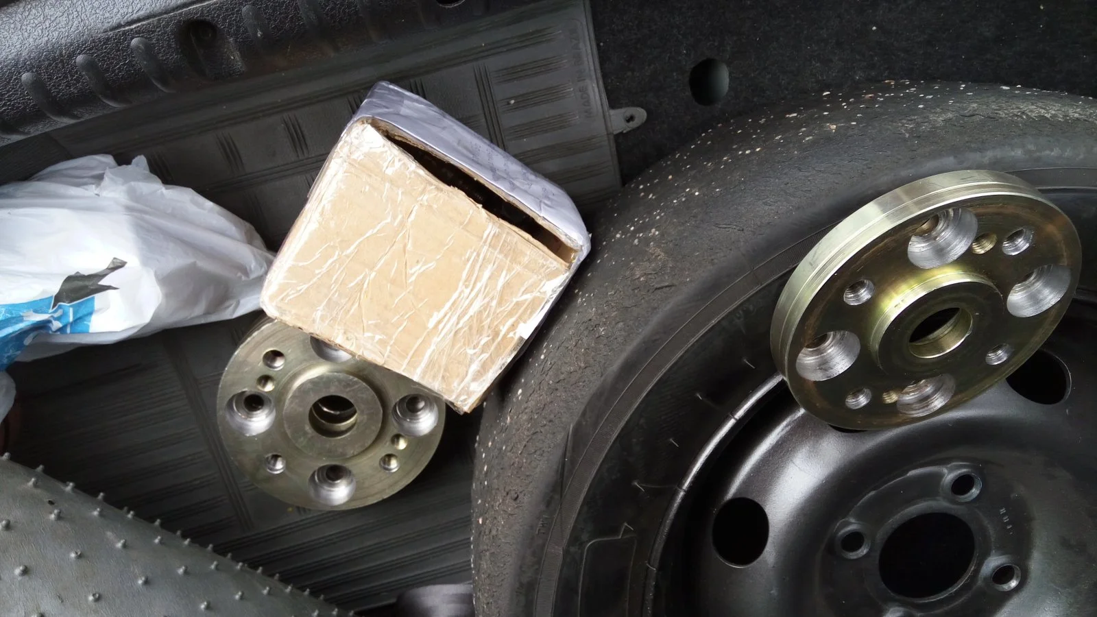

I bought those spacers... The problem: used Parts.. these are Steel spacers(s**t 10kg the four discs). And the center bore (the neck) are too short. .. for aftermarket Wheels you put those plastic rings and centralize the Wheels. But my wheels are OEM Renault, and the result was wheel jumping out the car in a trackday. And dusting the screews holes. I Will GO to a mechinic torner to make new aluminium spacers with screws and porks.. not these s**t spacers I tried to install. So for now Im using none spacers.
With 20mm spacers:

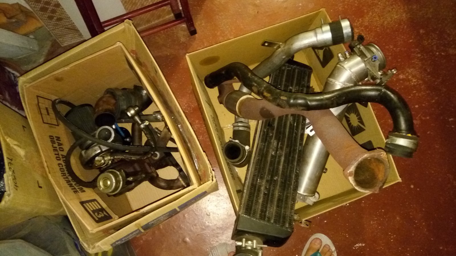

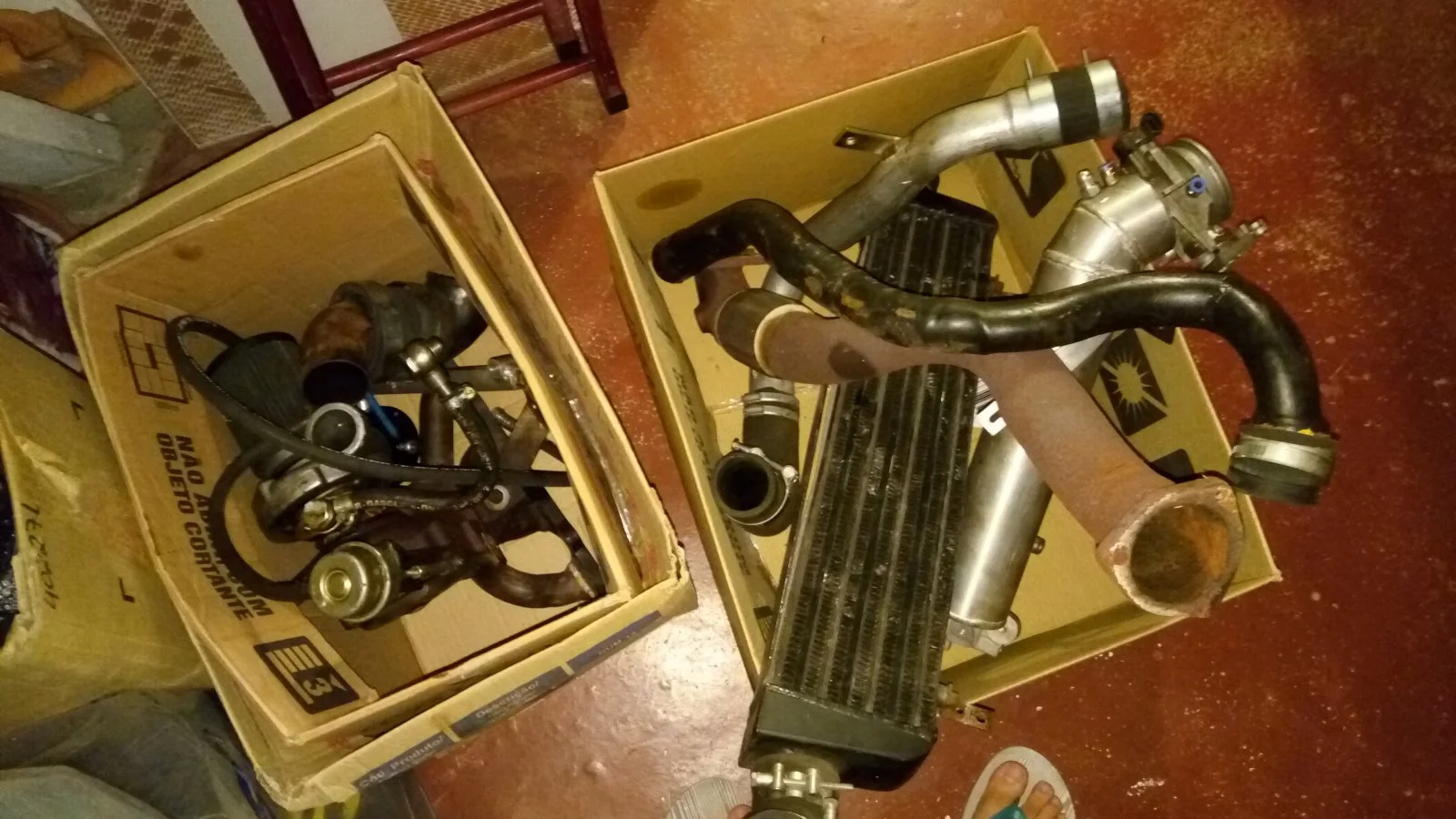

After some rework on bumpers the visual looks great now... the next step is put this turbo kit to work :D

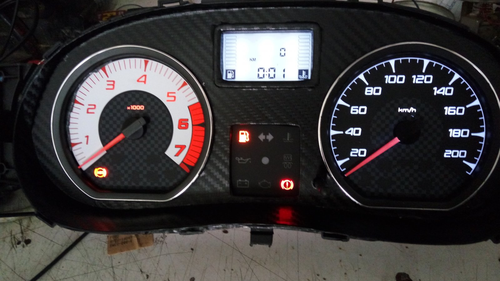

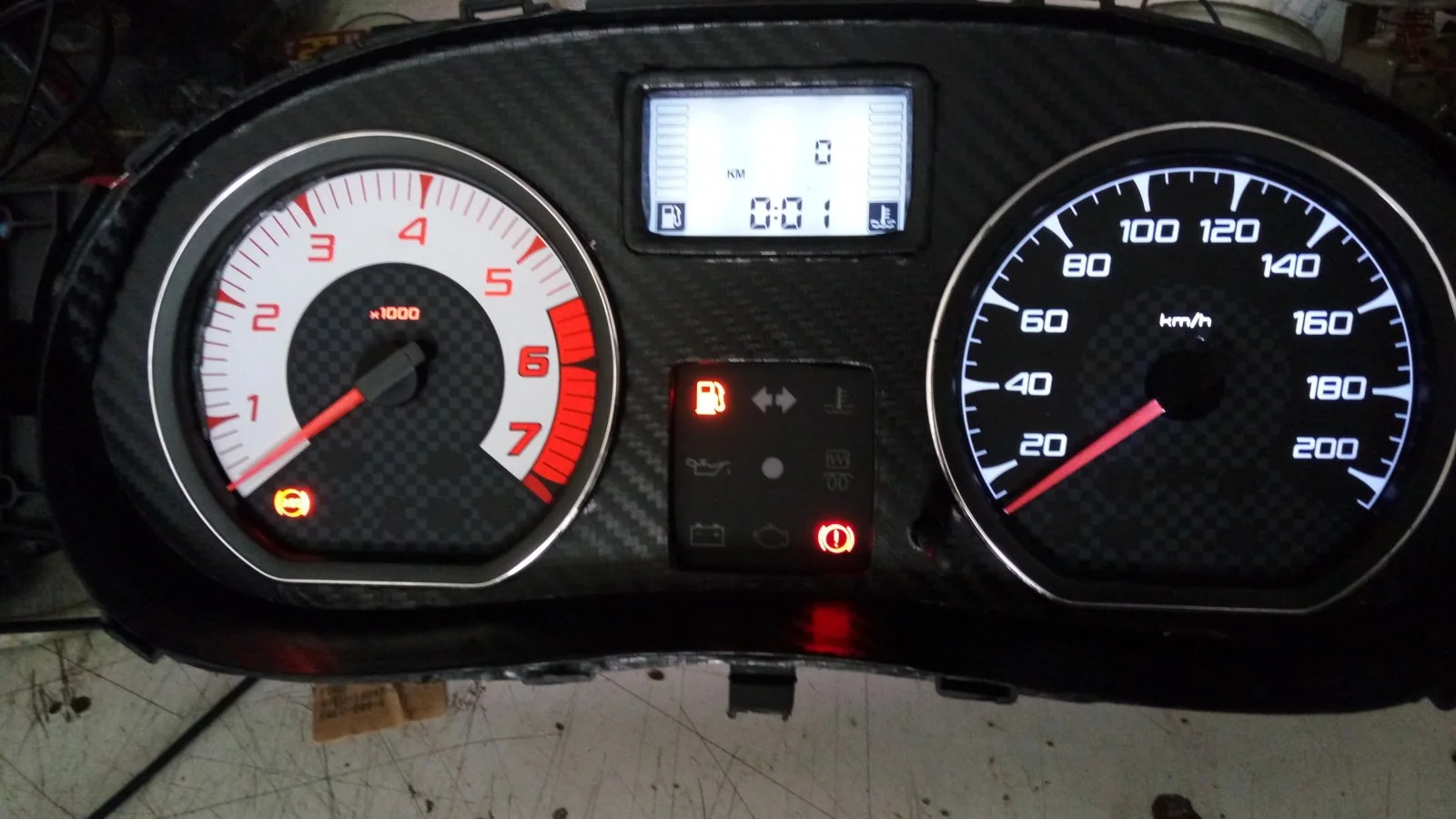

My plan is install this intrument panel comming from Sandero GTline. I've painted as carbon fiber texture and changed the led colors.. on next days I'll change the cables and wiring...

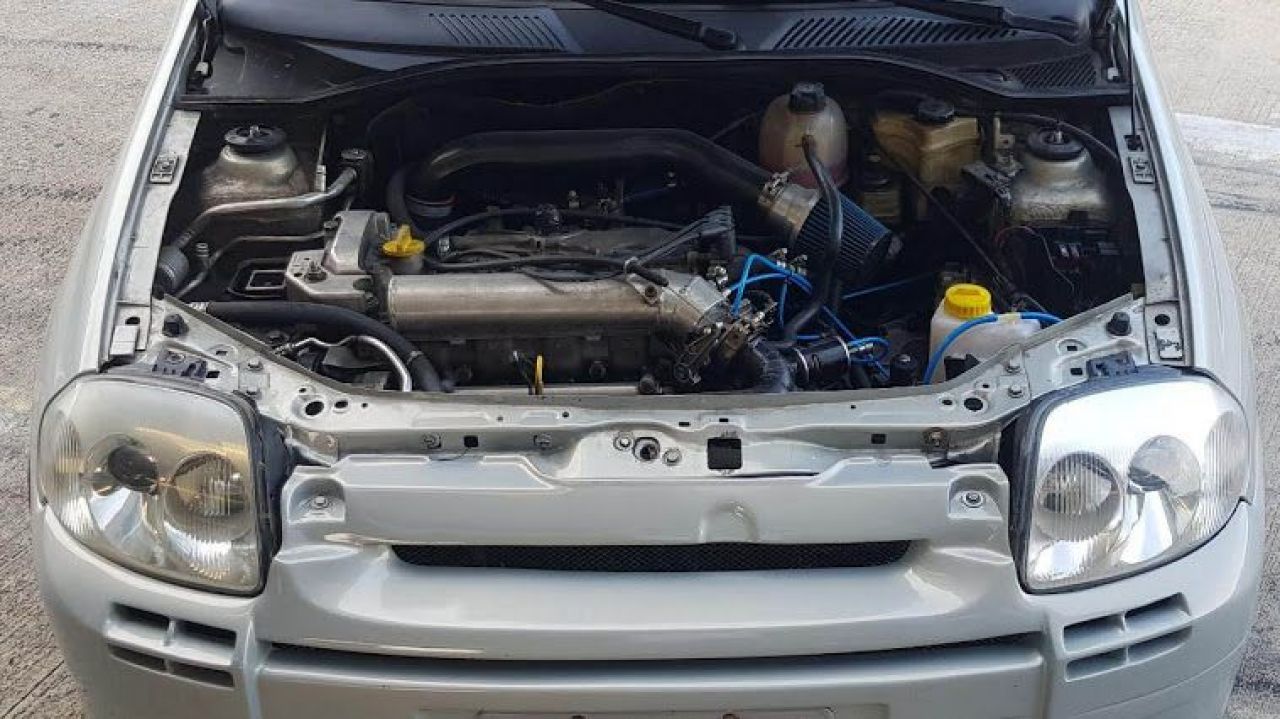

Also forged piston and rods installation for turbo

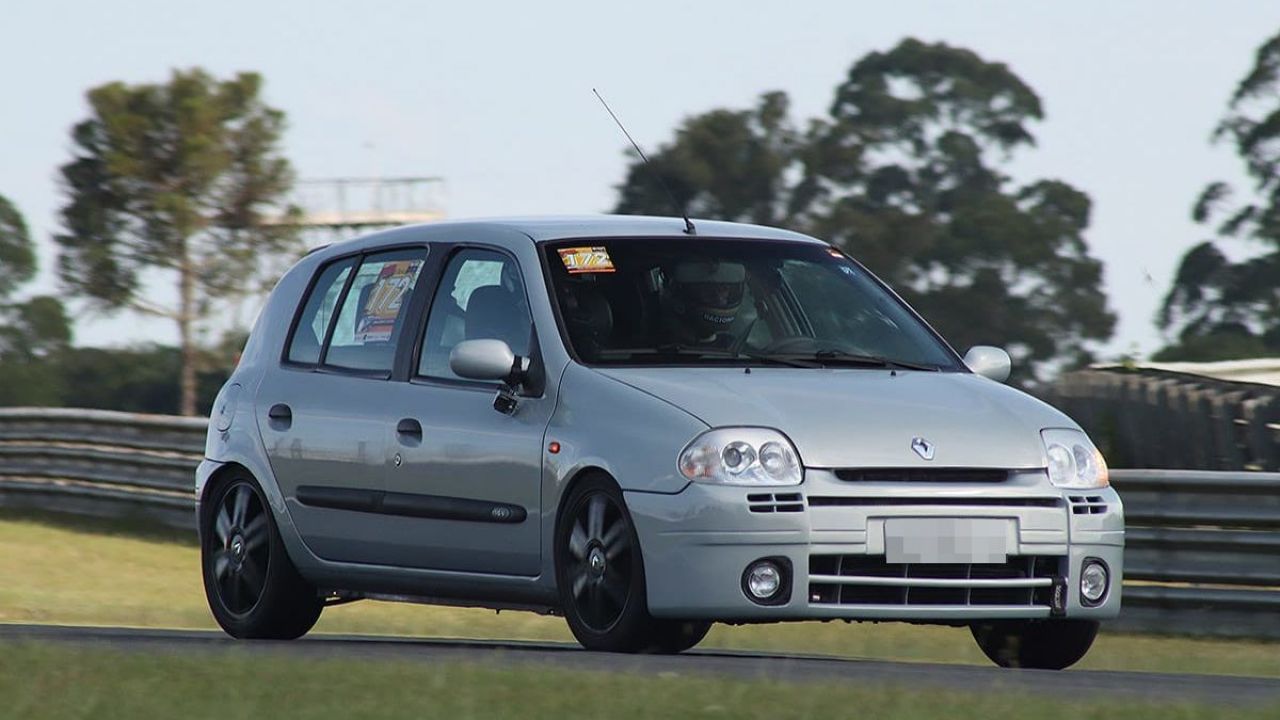

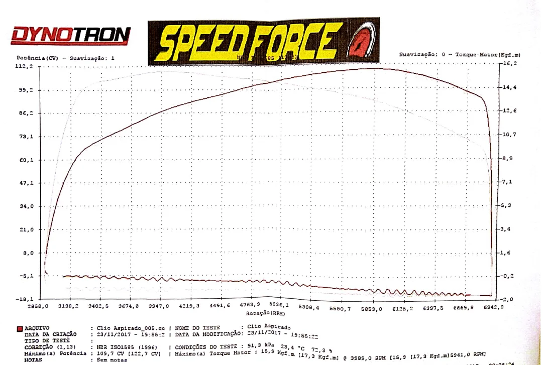

Justs installed new aftermarket programmable ECU, new exaust system, new and bigger fuel injetors...running in ehtanol and using aspirated k4m it's measuring 110 whp, ~123 bhp .. with the JB1 gearbox it's a very funny car now to run..

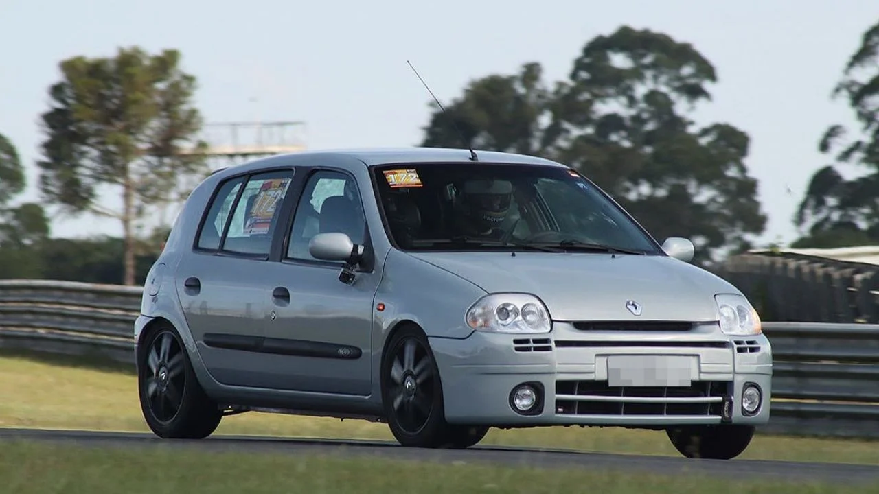

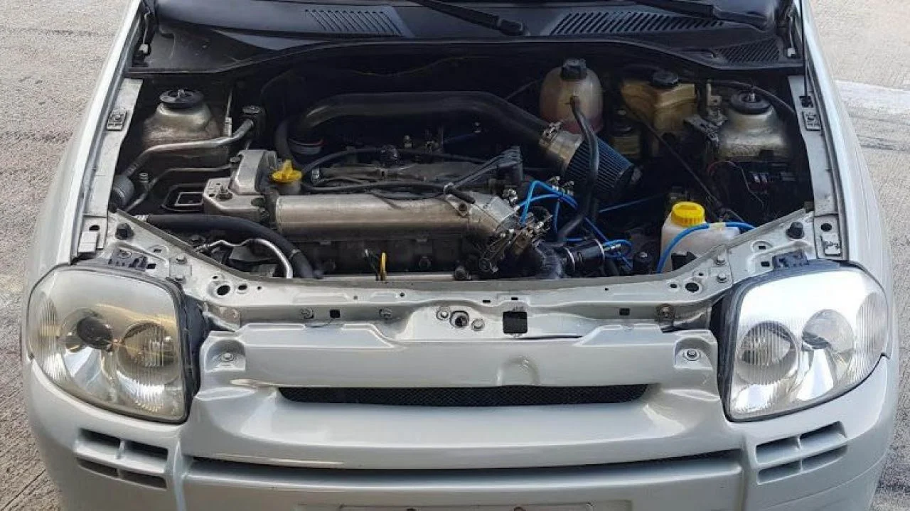

After 4 years (and also a World Pandemic) my Clio is just like finished to me.
K4M 850 engine turbocharged 12 psi running Ethanol E100
Performance:
185 whp and 23.9 kgfm in the wheels
Ford CHT (Cleon engine) piston rod, forged piston
Jb1 gearbox with jb3 diferential ratio (torsen diferential)
Sequential injection
All aluminium inlet manifold and fuel lines
Megane r16 Wheels
Coils H&R Sport
Tires Momo Run M3 205/40
DS4 breakes calipers and disc 302 mm
rear calipers and disc from GranScenic 284mm.
