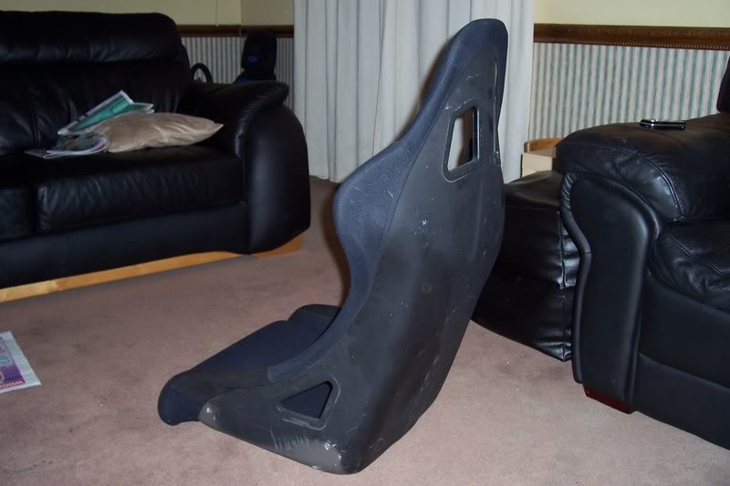

I worked on a standard Cup seat being around 20 kgs.
I've got this to go in, which with its steel mounts comes to 8 kgs all in.
I always thought I'd leave the passenger as is, but if there's another 15 kgs to be saved...that's put me at about 920 kgs.
Another 6 bhp will then give me a nice 200 bhp per ton.

Cool...so about 20kgs saving with the seats I have (plus subframes etc). I still have my door cards but have removed all the rear stuff and carpet/centre console etc.
So that would make it about 85kgs lighter than standard...I'll have to see if I can get it weighed next time it is out for a play
