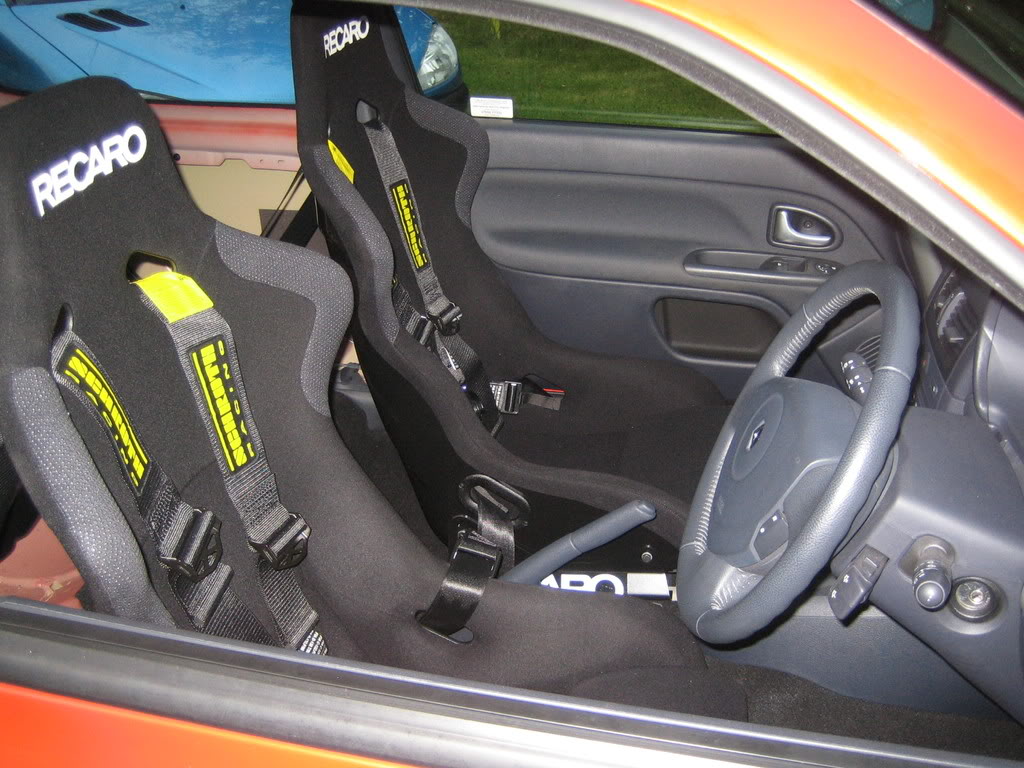

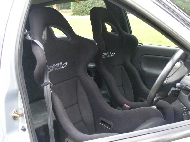

The first are fixed buckets. They are highly supportive and can give the car that real 'go-kart' feel. These are some of the best quality and value for money that I have seen personally:
©JamesStone
These seats tend to trade off day to day usability for ultimate driving feel by being nonadjustable and being permanently set to your desired position. Their lack of tilt etc means that practicalities off a 3 door car like the Clio is reduced as it is nigh on impossible to get people in the back. However probably most importantly they lower the seating position by around 60mm onwards. Ideal for a trackday weapon!

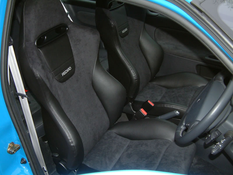

The last alternative are the Recaro and more specifically the trendline variant, and its probably clear why. They match the interior of the RS perfectly and look the bees knees. They combine sports comfort with day to day usability having a single tilt and reach handle to get people in the back. Also they they have the RECARO logo - probably what makes them so expensive :rasp:
©Red Cup
Straight out of a stipped Trophy or direct from the manufacturer the lowest I have seen a pair of these seats go for is around £800 second hand without frames. New from the supplier they are around £1358.00 yes thats £1358! with frames which is a huge amount of money for a pair of seats.
©JamesStone

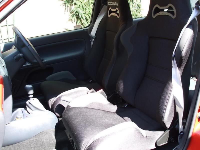

The second main alternative for the Clio are sports seats made by companies such as cobra. The seats below are one of the best examples I have seen fitted by another user on cliosport:
©Paul
These 3rd party seats are often cheaper than Recaro alternatives, but don't offer the tilt function to get people in the back and do often contrast with the interior of the RS clios. However unlike the buckets they still offer the slide function so when wound right forward there is usually eough room to get someone in the back, it just take a bit longer than the standard RS seats. These seats are fitted to the car with replacement frames specific for the seat. These frames will also often lower the seating position.
©Red Cup
