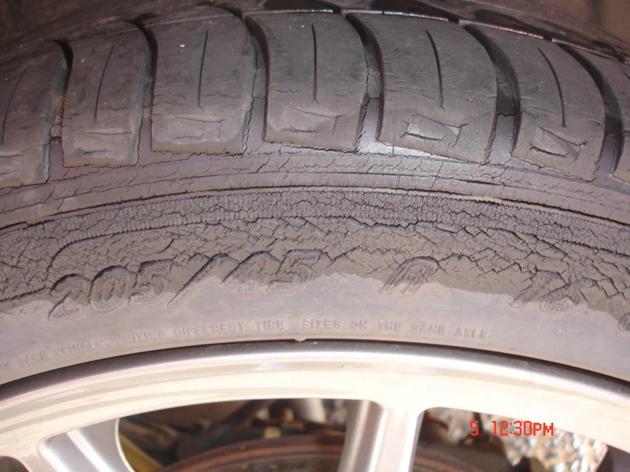

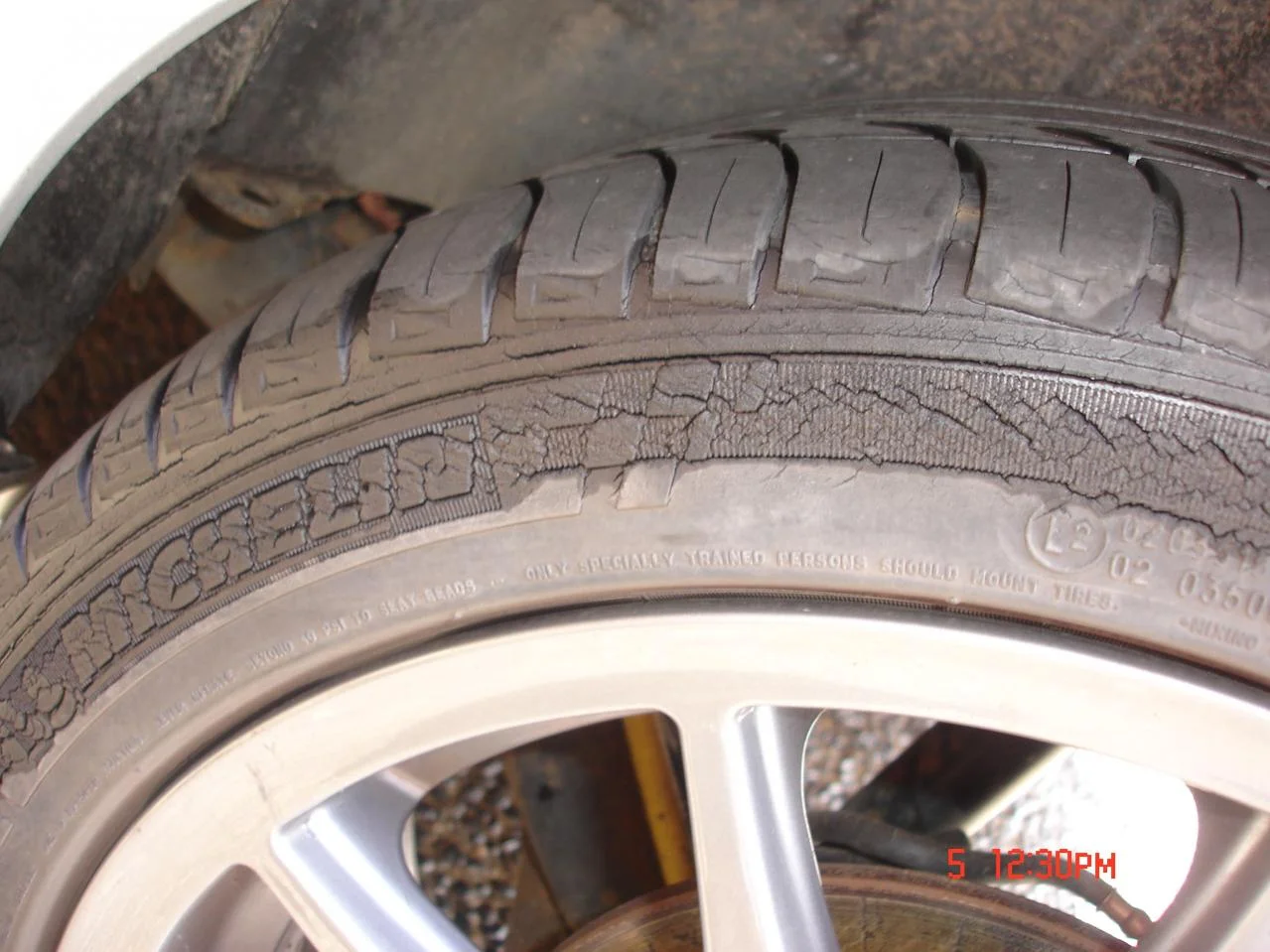

My rear exaltos are looking a little worse for wear. They have plenty of tread, just the cracking round the sidewalls concerns me. Ive heard Michelins are bad for this, is that true?
The cracks are about 1-2mm deep at most, but go right round the sidewall.

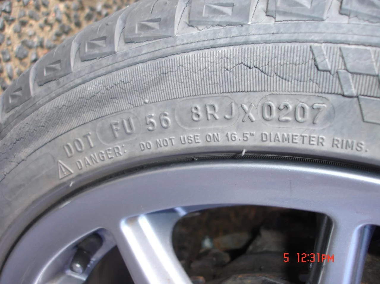

Just after some opinions from more experienced people. Also looking at the DOT code, seems they are over 6 years old.

If they are over the age id not use them - there is a date on them for a reason imo and I'd not like to be driving hard on them - especially when they get hot and have another 5+ psi in them

My rear PE2s have some light cracks starting to appear and yes they also have lots of tread.
Ive just bought a pair of fronts because they where getting low but i will be replacing the rears soon.
Id get them replaced ASAP, tyres are the only thing keeping you on the road mate.
