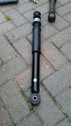

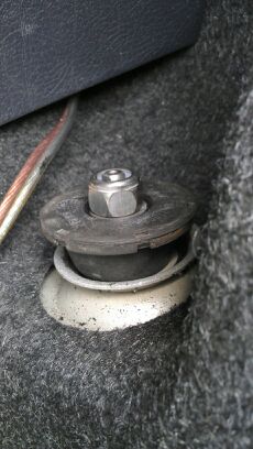

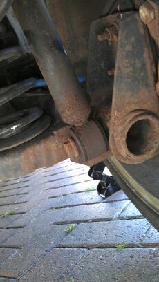

Fitted the rear shocks today really easy and only took me twenty minutes, my ride is do much better now, everything is very stiff at the rear and does not slide out when turning on damaged roads, only my driver side shock was fooked but replaced then both.
Jacked the car up on the side I was replacing the shock.
Loosened this nut in the boot.
Took the bolt right off then took the nut in the boot right of and it fell off.
New shock, sticker goes outwards facing.
Car is proper stiff at the back, it is what it was like when I first got the car. The front seems bouncy, I wonder if the front have also gone.
