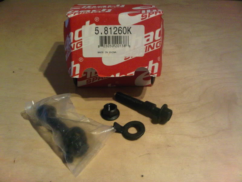

think these camber bolt are wrong ( inc pic)
  CLIO PH1 172
got sent these camber bolts but iv got a feeling there not for a sport?
can someone confirm if they are or not please
any help thanks

They sure look small in the pic, have you not got a ruler?
Think RS Clios are M14 and non sports are M12
  CLIO PH1 172

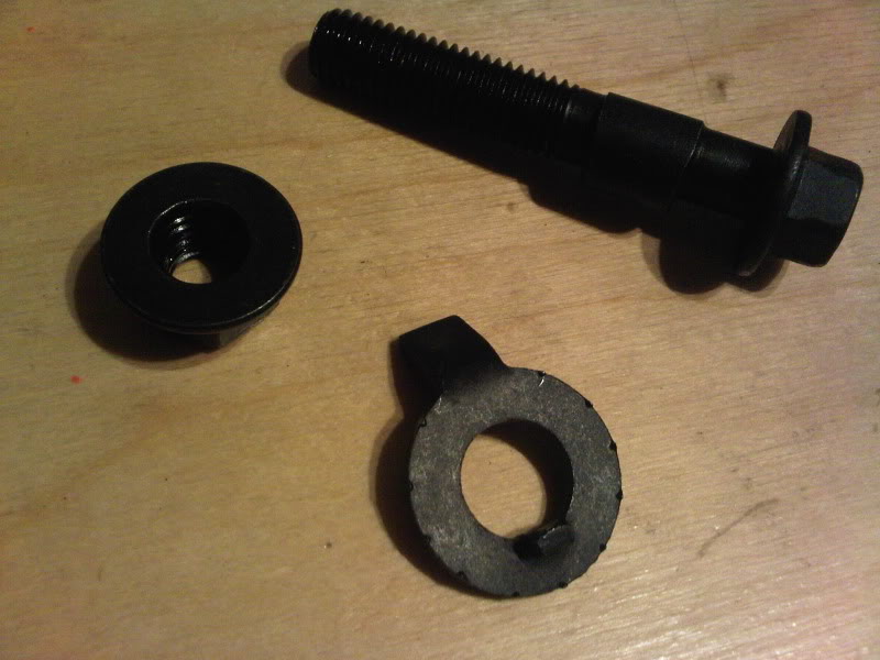

when measuring do i measure across from outer thread or just the shank?
inner is - 9.5 / 10mm
outter is - 12mm
  CLIO PH1 172
thats what i wanted to here i just thought they looked a bit small.
might give them a try tomorrow after work
they pretty straight forward to fit?

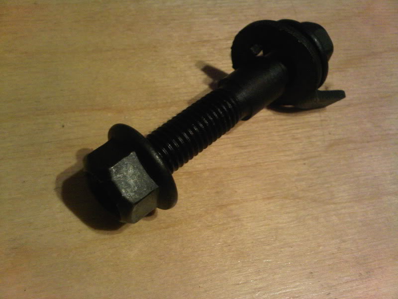

Bought a pair of these from kamracing (best price-15 quid) and wanted to set things clear with these bolts. I know I had some questions about these...
So here's what I know
They work on standard shocks, if you have coilovers with elongated holes they're useless
Don't be scared by the diameter of the shaft, it's supposed to be smaller than the original- 10.5-11mm for the sport camber bolts
They are longer than the originals-no problem, plenty of thread
Heard questions about them being different from sports to non sports. They are. For the sports they have to replace a 14 mm diameter bolt, non sports have 12 mm
I made some research in the way they work (acad drawings and stuff) and a good way to be sure you bought the right ones for a mk2 sport is to measure the lobe on the bolt shaft which should be aprox 14mm (like the original)
Or... the part number should be 5.81260K
