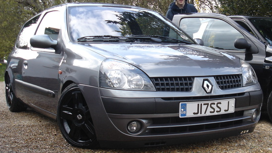

Any one ever done or hurd of any one doing this? Its a nippy car as it is at 100bhp and is lighter then the 1.6 and 2.0 clios. Think i will put the same supercharger as the one in the Mini Cooper S! Why you guys think?

I agree, it would be a waste of the money IMO unless you have a way of doing it on the cheap. Having said that, if your car doesnt fit into the cliosport stereotype most people will tell you its a waste of money. So if you want to, do it, interesting project.
Your cars smart by the way.
