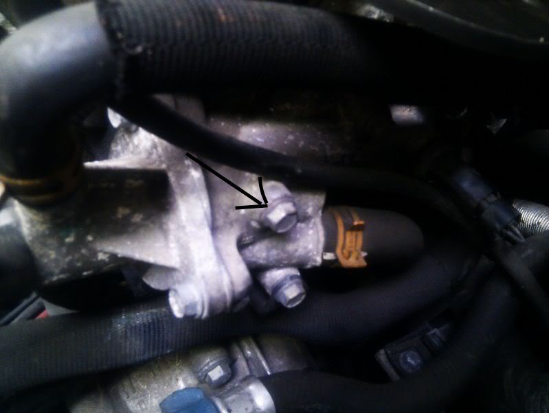

top it up again,
set the heater to hottest setting,
open the bleed nipple on the thermostat housing until coolant flows, (in the picture)
close bleed screw again,
run it for 10 minutes,
leave to cool down for half an hour,
bleed again
