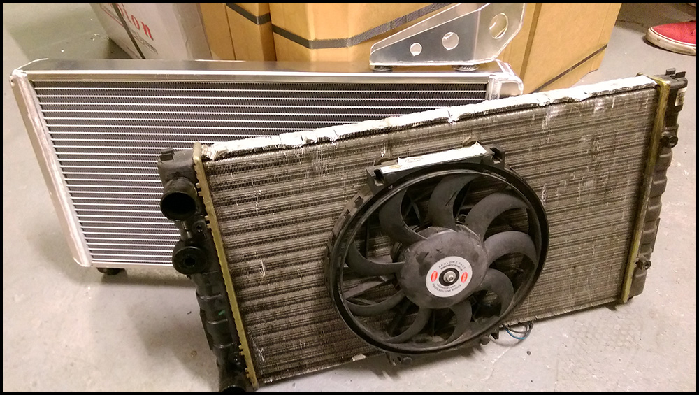

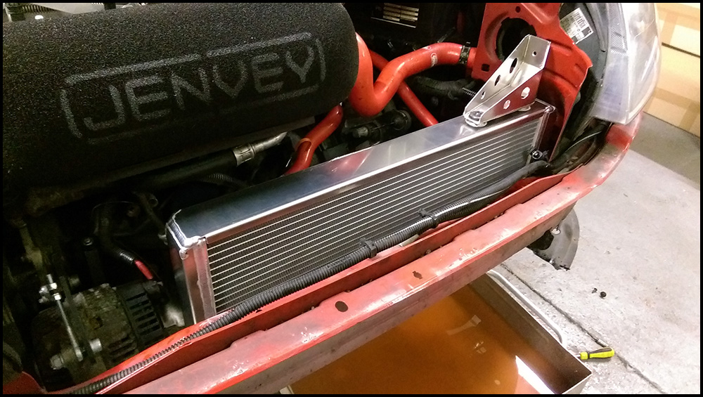

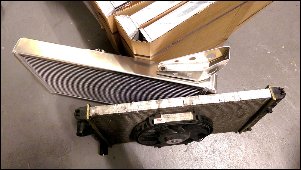

AH Fabrications do a nice rad setup... but depends on how much you are looking to spend and how highly tuned your engine is. I was getting overheating issues on my old setup (ITB's, cams, forged, high-compression) so went with a solution from AH. A fantastic bit of kit but I also appreciate it may be overkill or overpriced depending on your specific needs / budget, etc.
Yeah that radiator is nice I've seen a few for sale on here they were pretty pricey tho is it the same size as a standard one high wise as I can see it's a good bit thicker
No mate, it's smaller than standard. The 'old' rad in the picture is the smaller VW Polo radiator that it was replacing. It's not far off double the thickness.
