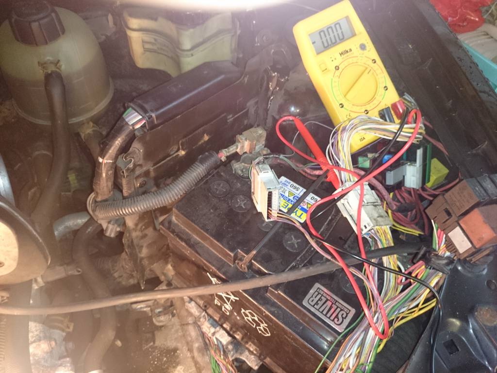

Chances are the problem will be in the wiring, either corroded or broken.
Thanks, yes I’ve read some threads where they mentioned the wiring. Seems more common on the cup? What’s the name of the specialist you recommended that are used to sorting this issue?

TBH, it a problem common to all Ph2`s, regardless of engine size, as they all very similar wiring in that fuse box area.

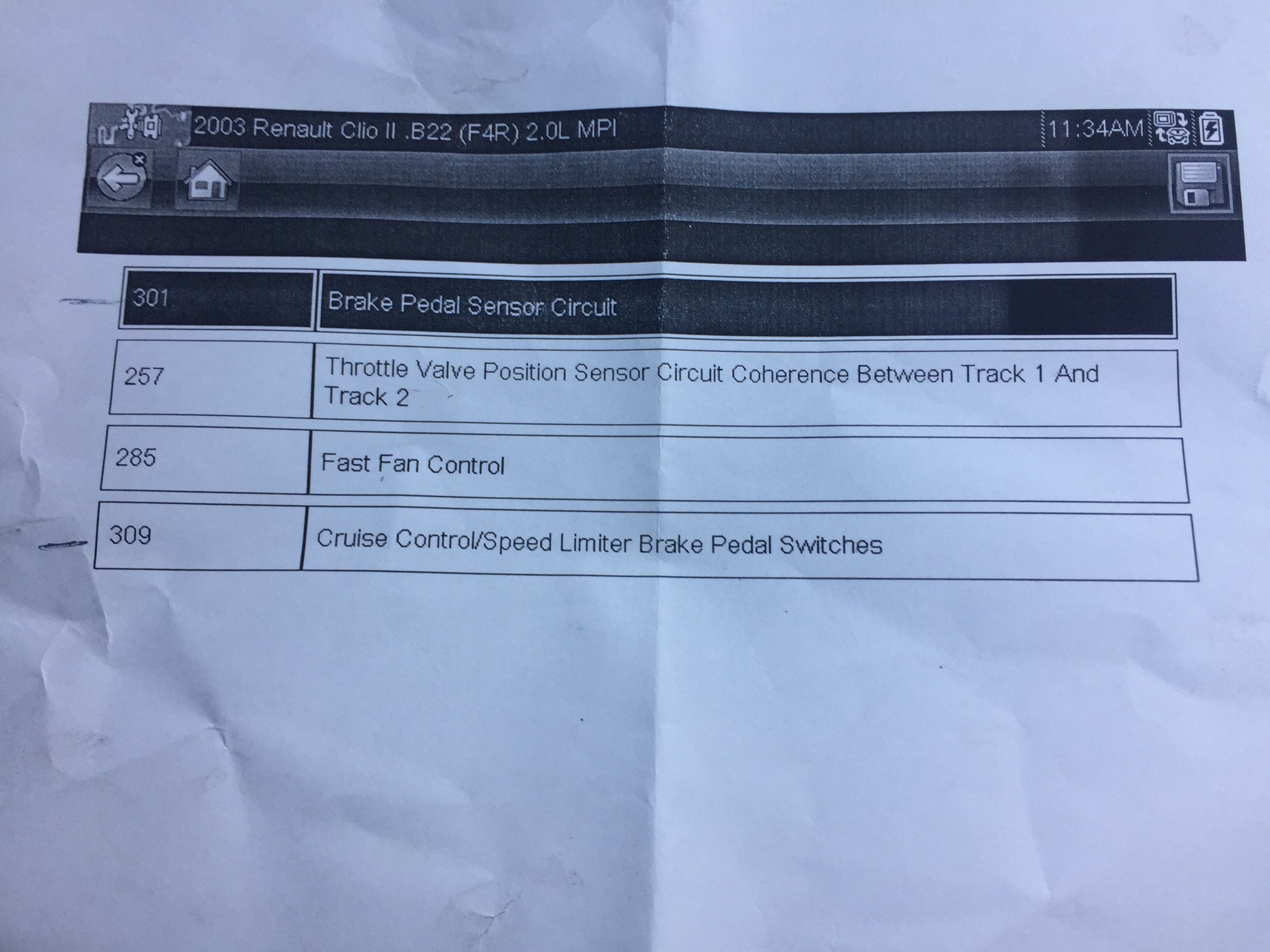

Yes it turned out to be the throttle body :)
I bought a used one for £20, fitted that and haven’t had this issue again. I have done about 1000 miles since I fitted it.
The error code and limp mode can still be due to a few potential issues though so this may not be the cause and the cure of your particular issue I.e it could be the pedal or even the wiring.
If it’s of interest, this is what the diagnostics showed when I used to have this issue:
