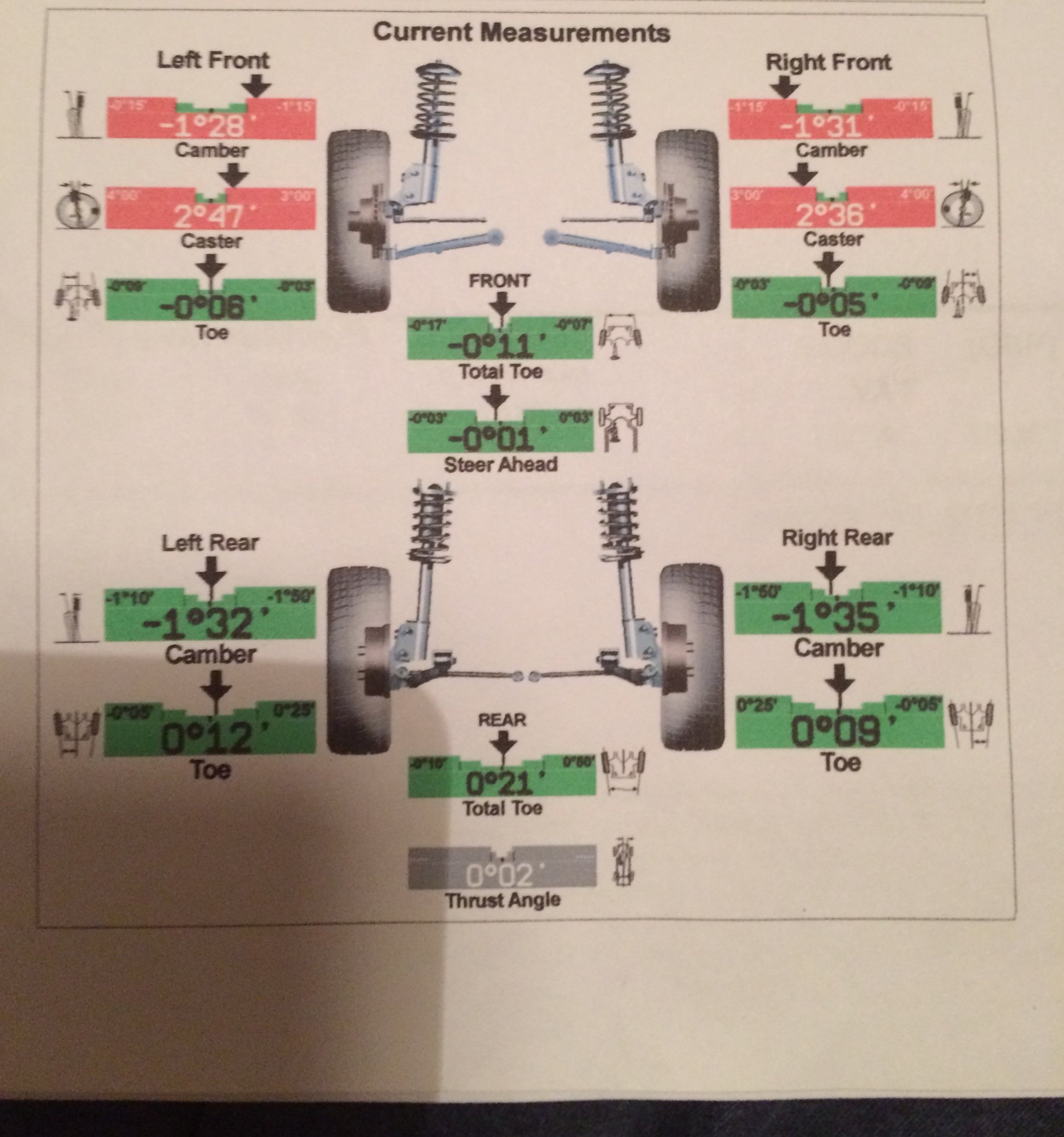

How low you can get the thrust angle on the rear is how well the car will drive been trying to sort mine out think it’s as near as I can get it was flickering between 0.01 and 0.02
Think it was a thread you replied in making me ask the question. Never looked into it before.
How have you made it lower?
It’s all done with toe shims mate from pms best off emailing your printout to nick and tell him what size wheels your on and he can work out what size you need , if it’s a road car go for a smidge of toe in or if it’s track some people like it zero toe but will make the rear end more lively
Drives spot on tbf. So unless it was massively (none placebo) noticeable I won’t bother.
Was just curious tbh mate.
