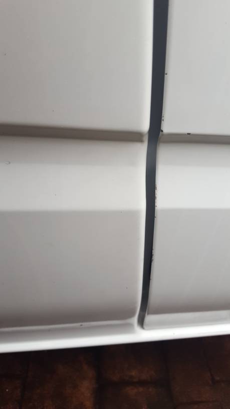

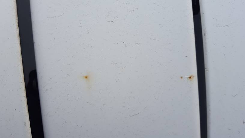

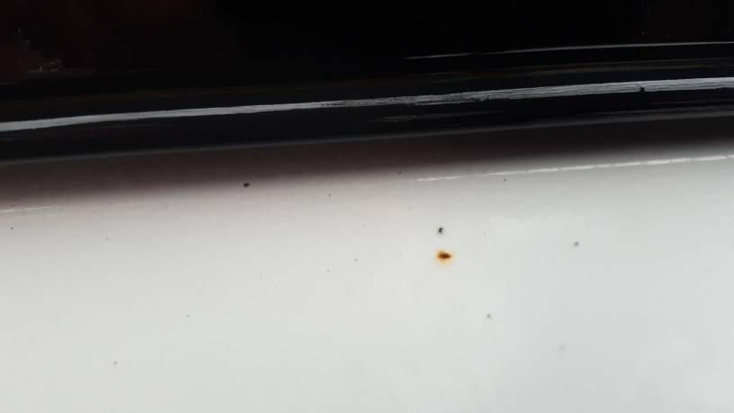

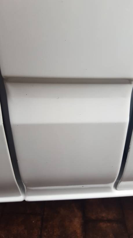

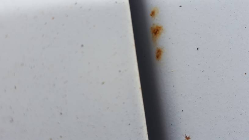

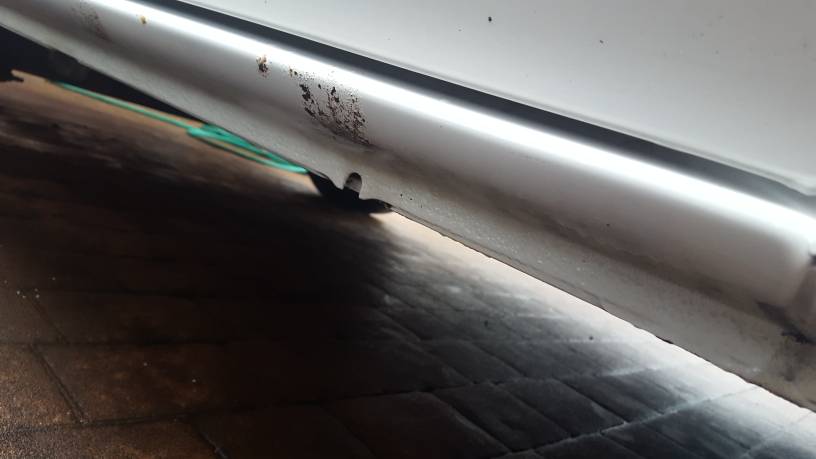

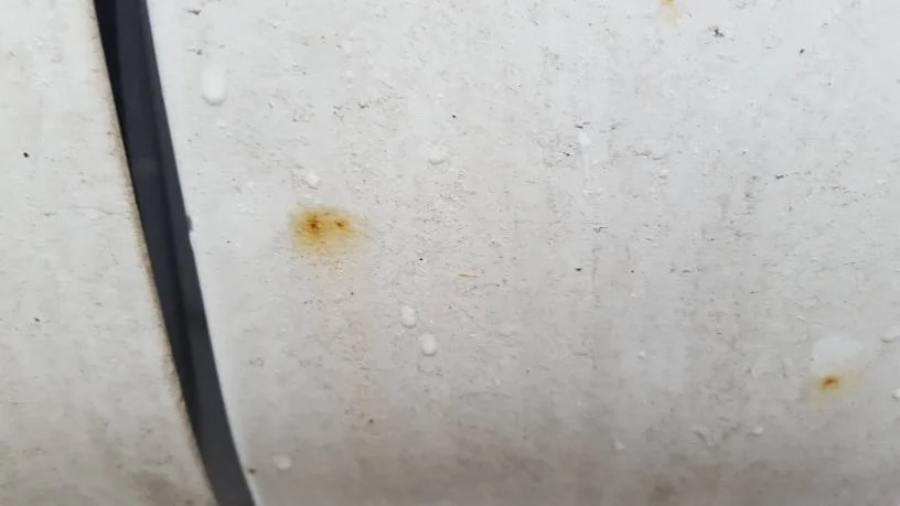

some shitty pics to give an idea

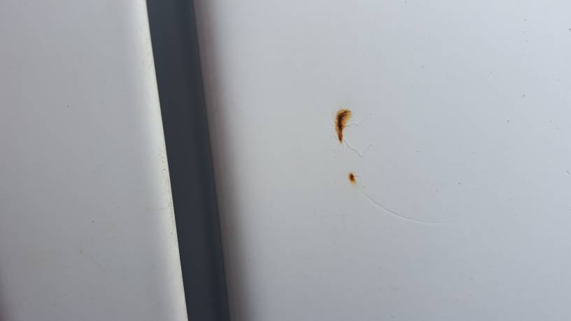

  535d / t5 caravelle
even the tiny ones, theres smaller ones than pictured

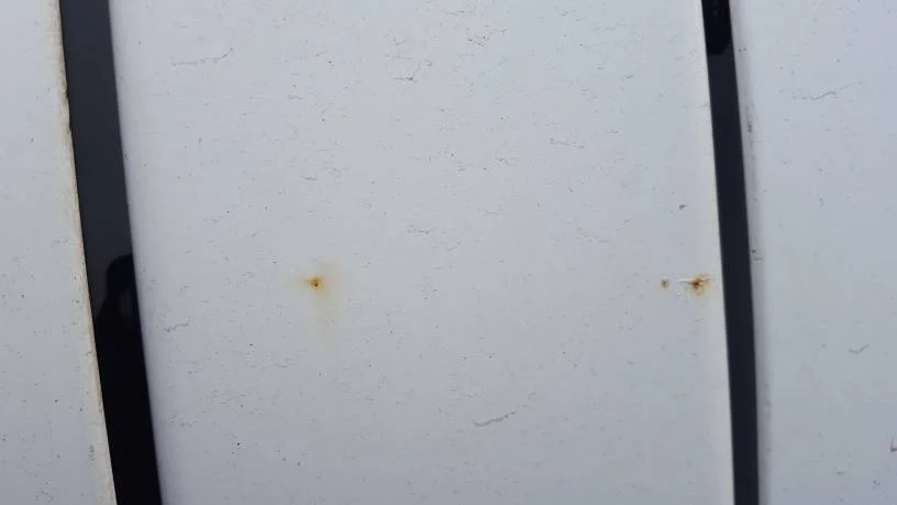

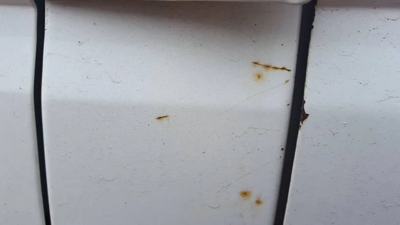

Them spots are nothing really, i was expecting big rust bubbles. Your best off using fallout remover, clay then polish & finish with a good quality wax, keep on top of it and probably last quite a bit longer.

Isn’t that just fallout from brakes etc that’s stuck to the paint surface? I’m not following the doom and gloom scenario of a rust bucket here. The van itself isn’t rusting, it’s the fallout that’s stuck to it.

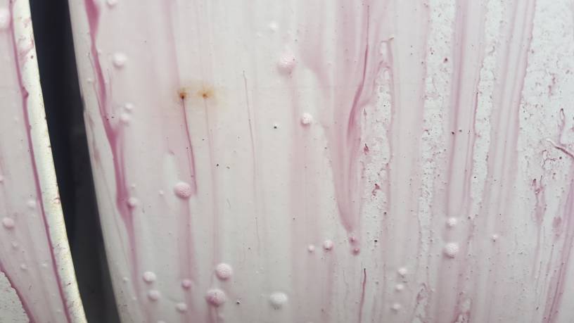

yeah looms like your right, bilt hamber korrosol landed this morning, had a spare 20 minutes so thought id try it, WOW!
sprayed it on, left 5 minutes power washed it off, f**k me its good stuff. van looks 100 times better than it did. wish id taken some photos of the arches and sills, as i actually thought they where rusting quite badly, not any more, there not perfect, but there white now. and good enough for me to treat with some kurust and then slap some stone chip paint over.

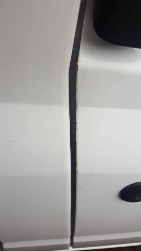

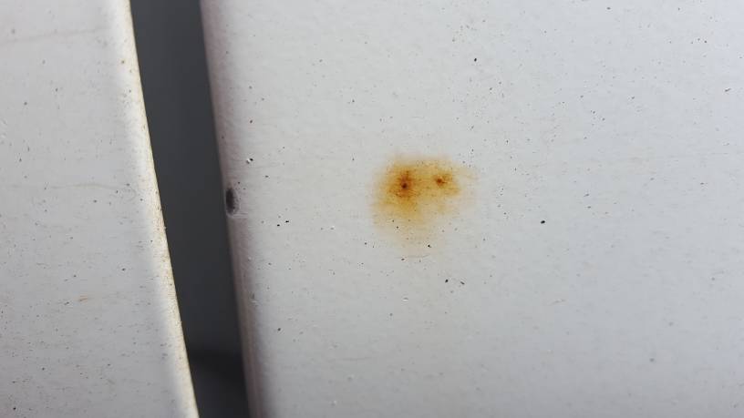

got a few more pics of the little rust marks on the van, will get some after pics.

after pics, will give them another go tomorrow and agitate it a bit, should come up better
andybond
Try it on rust and see what happens, rust stains rinse off. It does not cure it however but can sort out very minor spots like this. Bilt Hamber Korrosol is awesome stuff
Best stuff on the market. Smashes through rust / grime / fallout
