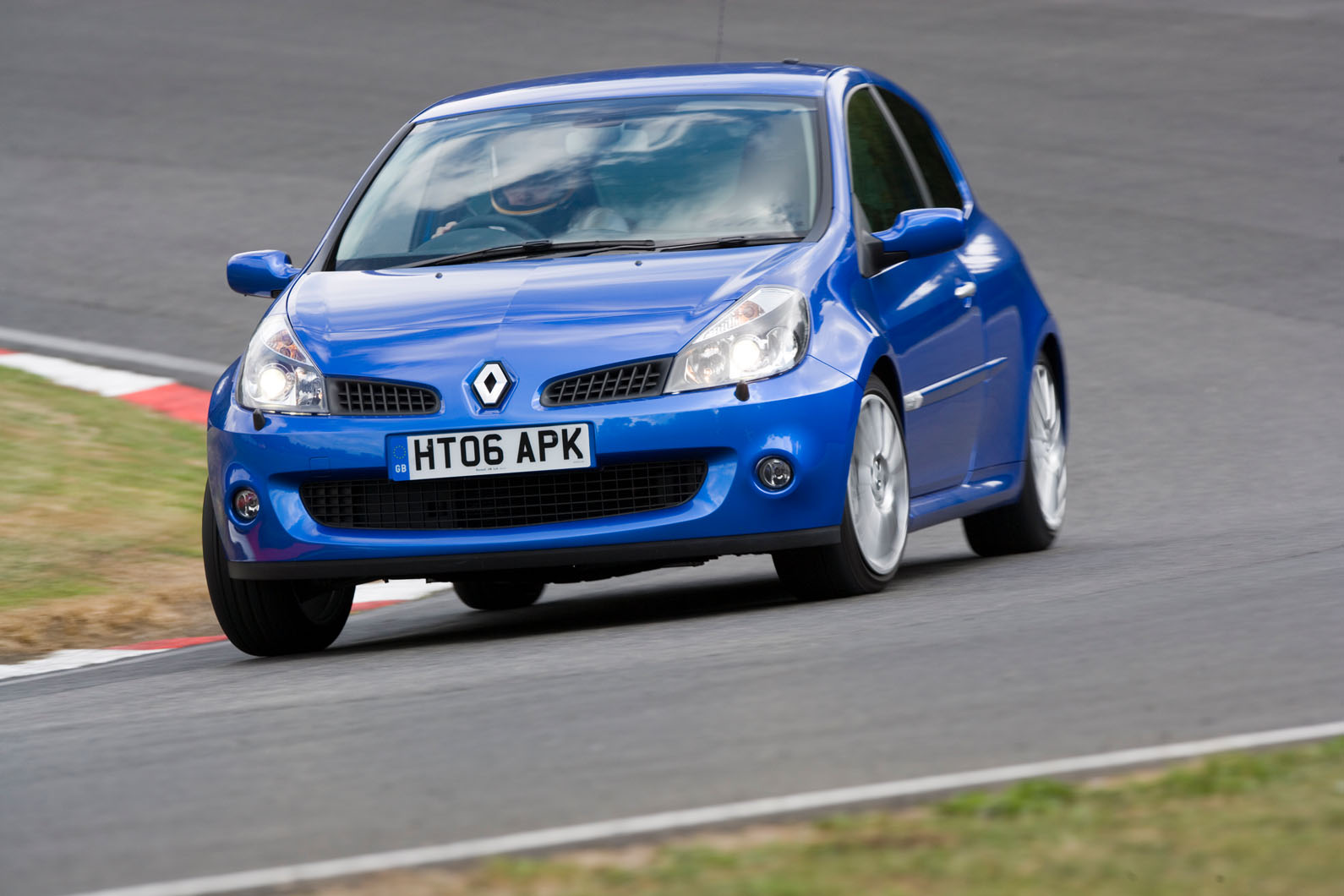

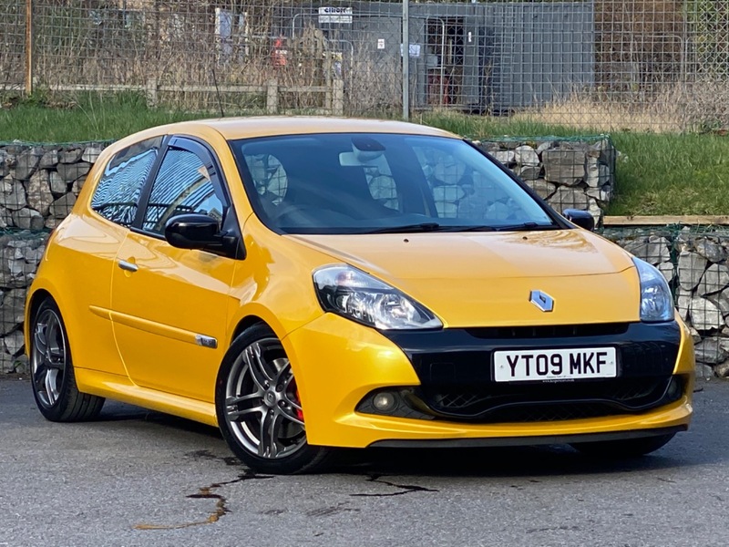

Any mk3 RS clio will have a TL4 -
197:
200:
