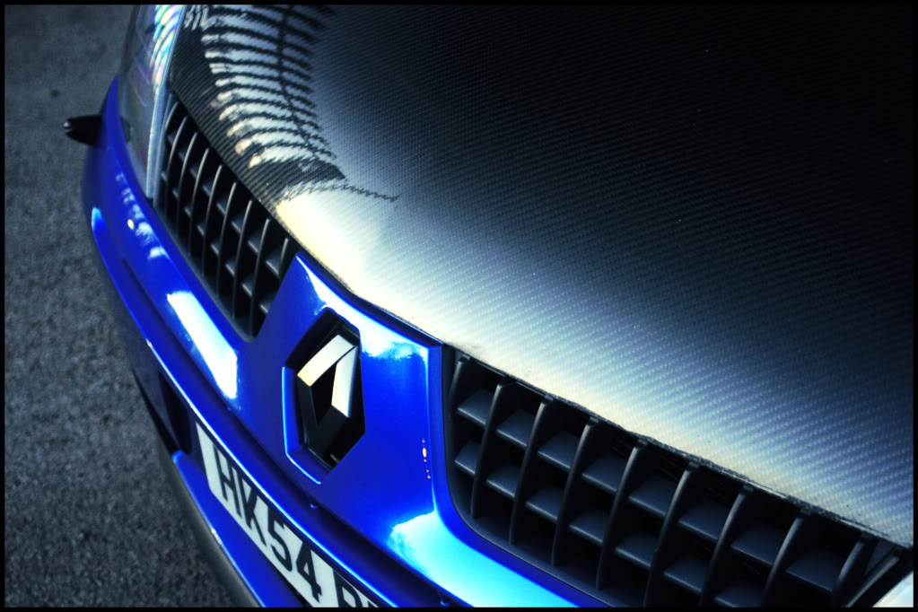

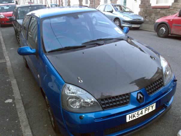

Fitted a carbon bonnet

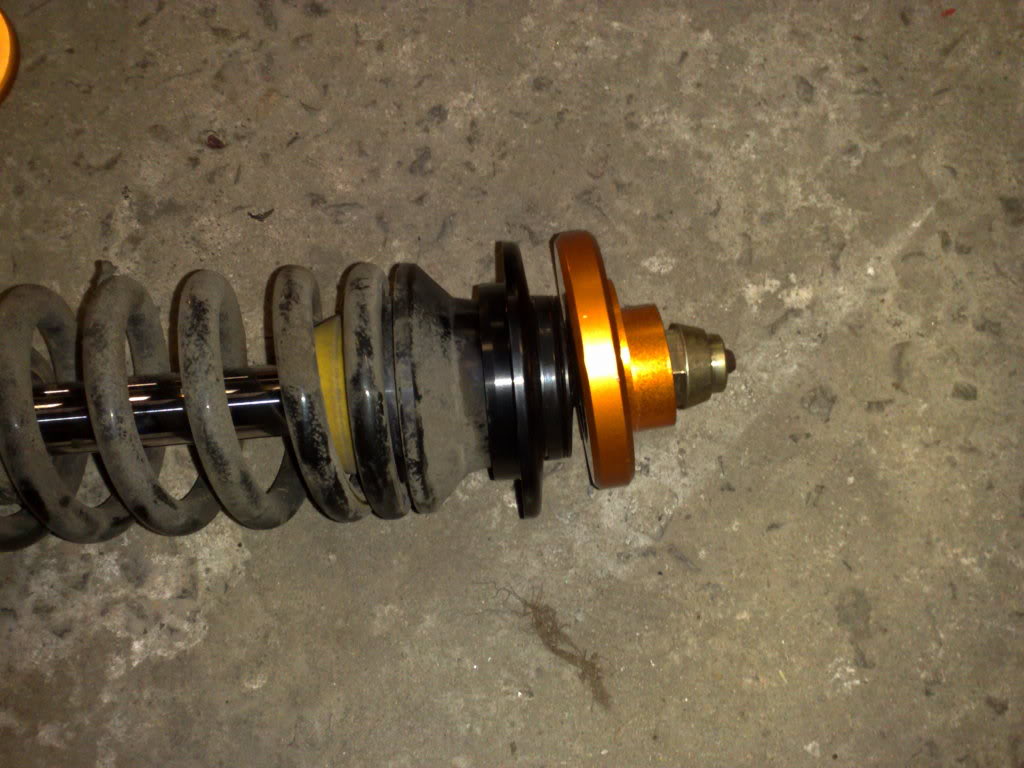

Then went about fitting my ast top mounts, can anyone clarify if this is the correct way they go?

Is it proper carbon bonnet or just coverd in carbon.
weight?

Dont like the clips, love the bonnet! was gonna see if someone had fitted carbon bonnet to an artic blue, as i plan on doing this. Was it hard to do? Have you used the original locking mechanisims or is it just via the clips now?

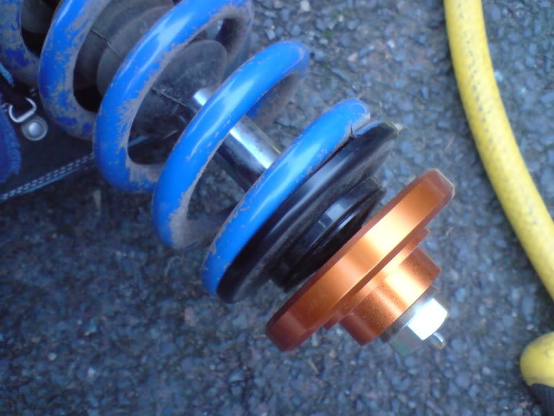

ast top mount is wrong i think. the original black carrier (above the spring) needs to be removed. the spring then fits into the bottom of the ast mount nice and smoothly. the middle bit you have fine, but the nut is also on the wrong way round ;)
think i have a picture somewhere.......

I don't know if anyone already said this, but the car would look much better with those 'flat' pins..
like these
  106 GTI
I did buy it with those in mind but im not sure if I would have holes showing etc from the current pins
