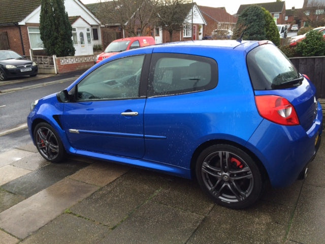

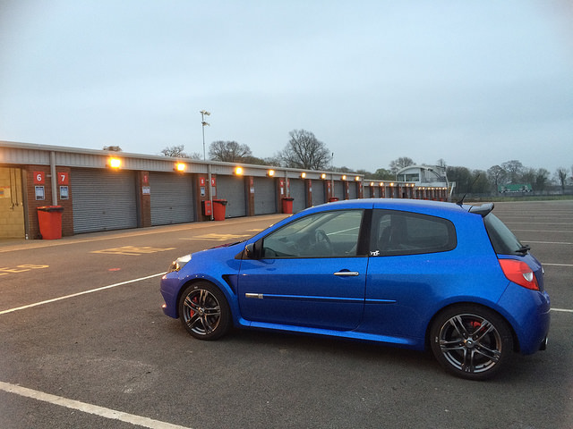

Here's a photo of the car when I got it 12 months ago.

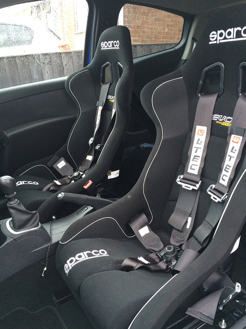

Sparco Evo Seats with 6 points racing harnesses.
Rear seats removed

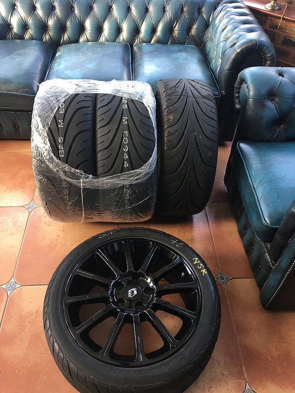

Rainsport Uniroyal - Wet wheels
Federal RSR - Dry wheels

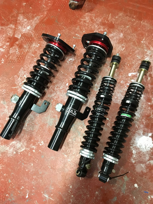

Gaz Gold Coilovers with 600/350lbs springs

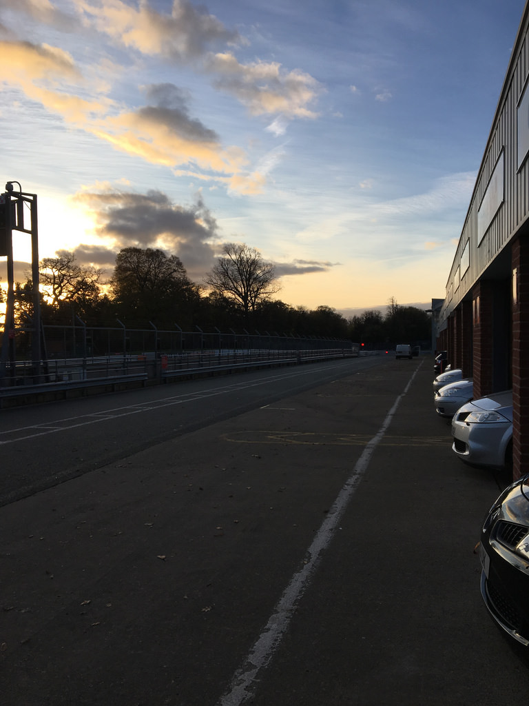

Where it all started in 2016 with the Renault Sport Track day at Oulton Park.
Few more track days along the way from Anglesey, Oulton Park and Snetterton.

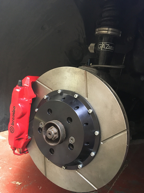

Well here's an upgrade for this week. I have been meaning to get around to refreshing the brake set up on this car for a while.

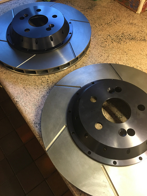

I've been working on a 330mm bolt on brake kit for the clios.
While i'm doing this I've ordered some Hel Braided brake lines, some new motul brake fluid and longer bolts and washers to accommodate the bracket to space the calipers out further with the new two piece disks.
Going to put in a set of brand new brembo pads I have spare in my tool box for the time being but i'll be ordering some CL RC5+ brake pads before the next track day.
  RS Clio 200
Tiny update for a big job.
Got the 330mm brakes on today with new braided lines, fresh Motul fluid and a new set of brake pads.
There is about 3mm clearance between the outside of the caliper and the inside rim of the wheels. Had to remove the wheel weights and will have to get them rebalanced with the weights in a different location.

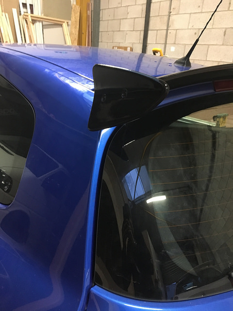

Also fitted the cup spoiler this morning. Finishes off the back of the car nicely.

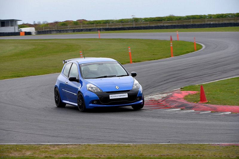

Reporting back from Snetterton from Easter weekend.
I'll start by letting the photos do the talking...
Hounded this Caterham like this for 2 laps and still wouldn't let me past while I was out with an Instructor getting some driver training.

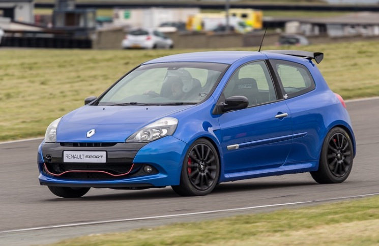

Car looking and feeling so much better now it's lowered on adjustable coilivers, changes to geometry in the afternoon really helping on track.
Love this rear view shot showing off the new rear spoiler and the Renault plates really finish it off.
Snetterton was absolutely fantastic once again, certainly worth the 4 hours drive. Luckily I was able to tow the car down on the trailer and sleep over in the Campervan on the Thursday night in the paddock right outside of our garage.

Overall the suspension changes such as black Polybushes, Gaz coilovers with a track focused set up and the big 335mm brake kit combined with DS1.11 brake pads made a massive difference to how the car performed on track. Carrying much more speed through the corners and being able to brake much later than usual. In the afternoon I added a few more clicks of compression, added some more camber on the top mounts which in turn added some more toe out and the car was going even better, much better turn in, staying much flatter through the corners enable the inside wheel to maintain grip and allowing me to get on the power a little sooner. All in all the Clio was going really really well.

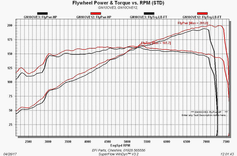

So as a few people knew I had the car booked in at EFI for 12pm on Saturday for Tuning. Got there had a chat with Chris and the job he had started in the morning had ran into a few issues and was going to overrun. I had keep all saturday free for the visit anyway so went off to get something to eat with friends for a hour while he finished mapping the kit car without any pressure from waiting customers. When we got back he was just finishing up and then ready to put the Clio onto the Dyno.
Had a chat about the cars current set up, what was changed, what the problems were, what fuel I run the car on (99Ron) and talked him through what had been changed, too much to list here, while he was strapping it down onto the Dyno, I was expecting inital pull of something in the mid 180's as I know this dyno reads very well compared with others. If i remember correctly the first pull was 193bhp which I was really happy with to start with and it was running reasonable well on the standard map with the breathing mods which had been done.
Chris set about putting on a map from a very similar spec'd car and started the process of live tuning the ECU with a wide range of dyno driving simulating a range of condition, Partial throttle, 50% throttle and full throttle driving on the dyno all at different points in the rev range. Then started doing some more full dyno runs and looking at the AFR and the power/torque curves. He then went back and changed the map and repeated the cycle over and over again for about 2 hours making fine adjustments to the map and at the same time lifted the rev limiter to 7750.
Really happy with the shape on the graphs and the figures. 201.5bhp and a really flat 160ftlb across the rev range. The only thing that did come out of it was the VVT was responding very slow at 2800RPM, but was fine else where. Got a few things he has suggested I try which will just help smoothen out the driving of it at that rev point.
Another graph from EFI from one of the many runs but this one gives more a direct back to back comparison between before and after, this wasn't the final run on the dyno but it gives a good indication of the changes.

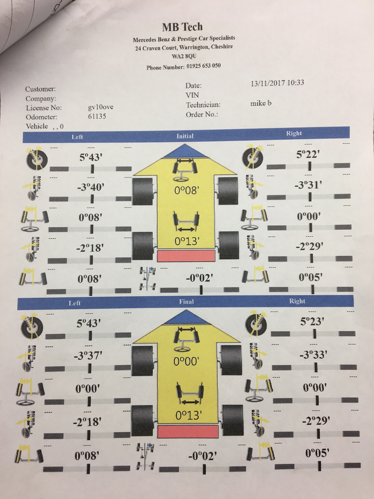

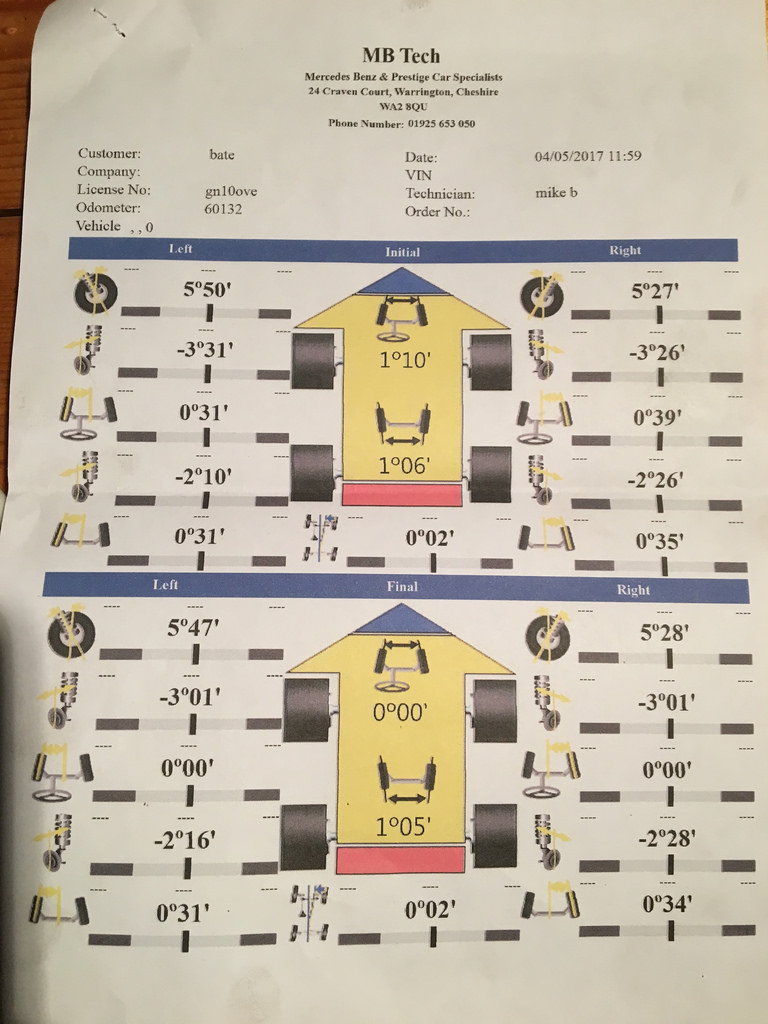

Got the car booked in for a full 4 wheel alignment tomorrow while i'm at work, be interesting to see what the new set up is like, much more camber going on.

Got it booked in for a proper full alightment set up on Thursday before loading up for the Renault Sport Day at Anglesey on Saturday.

I had changed a lot of suspension set up, heights, springs, top mount rose joints, rotation link, drop links and a track rod before this Anglesey day so got the geometry checked and set at something I was familiar with. Straight toe and 3 degrees of camber.
Going to have it adjusted towards 3.5 camber and slight toe out for Anglesey at the end of the month.
However I with the lowered rear end and the adjusted camber on the rear i now have 1deg of toe in on the rear. Looking at moving this towards 0 degrees to assist with a little more turn in and playful feel to the rear of the car.
Anyone got any thoughts?

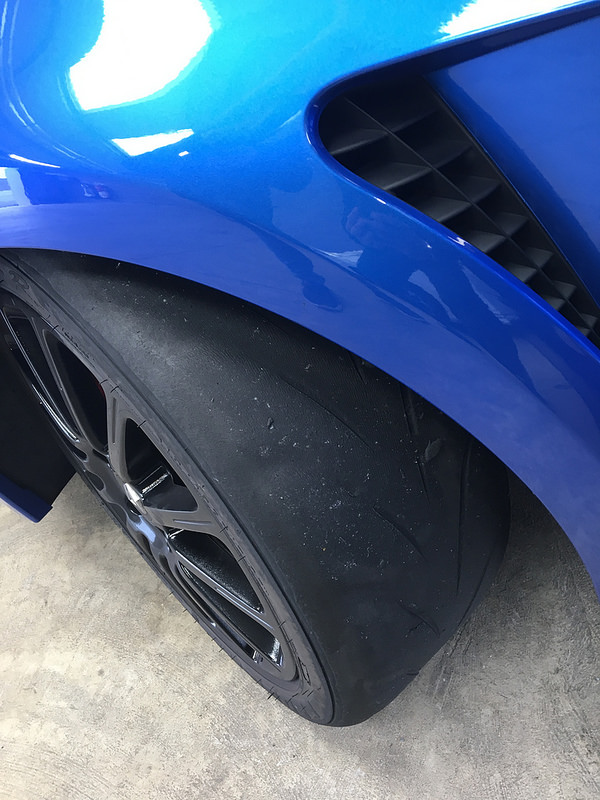

I was now running 225 fronts and 215 rears with no issues or rubbing and the car is lowered considerably. I'm tempted to say I had slightly more grip on the front with these with a slightly larger contact patch on the front, My friend in his Clio 200also commented on this.
However for some reason I appear to have worn these brand new tyres down to the wear markers in one track day, normally a new set of tyres would last me 3/4 track days on the front but I can tell this set is going to be ready for the bin after two. Potentially the effects of all the suspension changes enabling me to corner faster causing more tyre wear or slightly spinning wheels out of the corners.

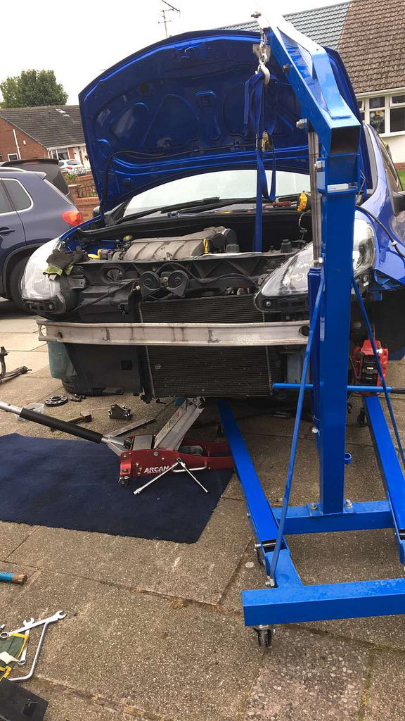

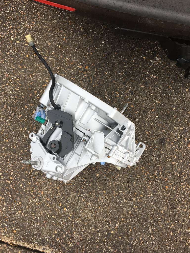

Clio 197/200 gearbox fitted with plated Gripper LSD also fitted with a shorter final drive (4.73)
Recently rebuild with new bearing, seals and syncros

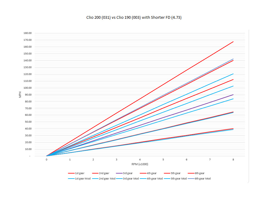

Put together a little graph to show the differences in Gearbox Ratios between the 200 box and the 197 with a shorter FD
It didn't take long to get the old box out and the new one fitted ready for Cadwell.
All Done and back together in an evening.

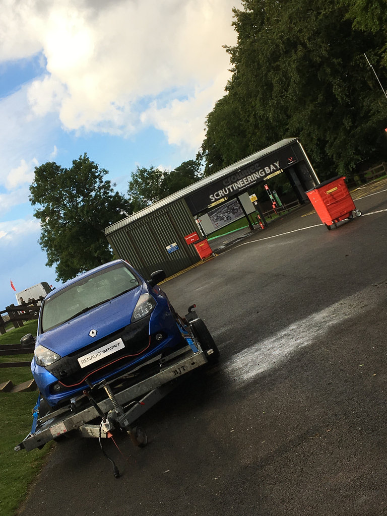

I set about loading up the van and trailer Wednesday morning and set off on the 3 hoursdrive to Cadwell Park Wednesday afternoon. I drove straight to the circuit and found a good location to set up camp for the next two days. Got my self nice and close to the pit lane entry point as close as you can be to the circuit.
I spent the night camping at the circuit in my van so set the alarm for 7am, I had taken the car off the trailer the night before so was pretty much ready to go in the morning, just a quick change of tyres to the drys and ready to go.

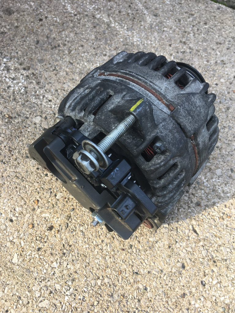

Only one mechanical issue on the day which was the alternator which decided it would stop charging the car after about 15 minutes in on the last two sessions and would only kick out about 12.5v. Let the car cool down and it was back to 14v for about 15 minutes on track.

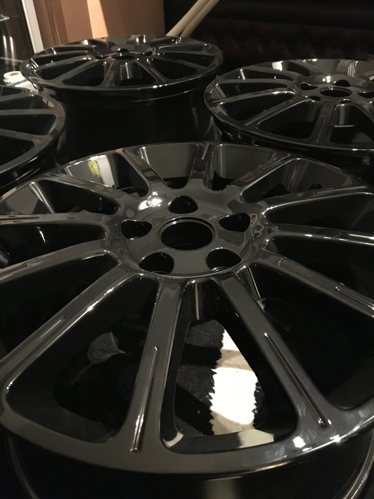

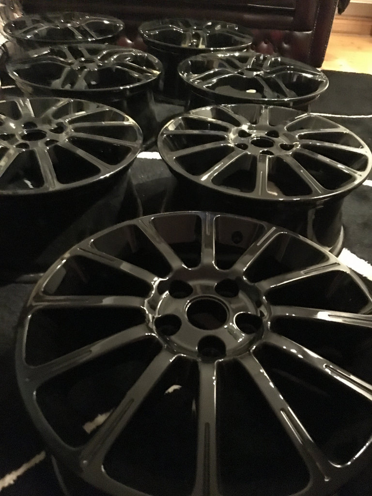

8 wheels went off for powder coating so the car was left on the driveway on axles stands. Perfect time to do some maintenance and some jobs over a period of a couple of weeks.

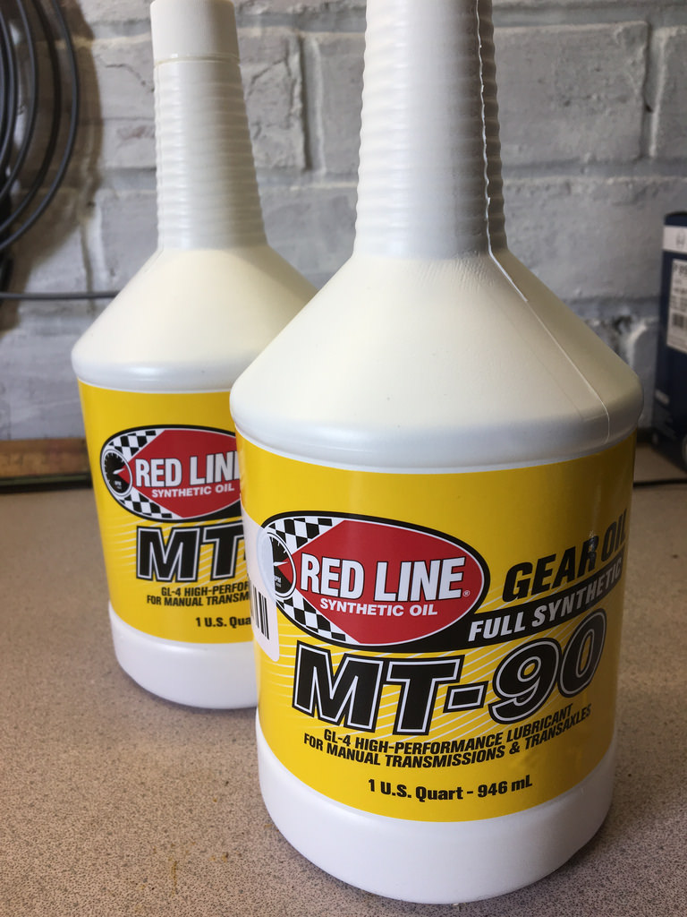

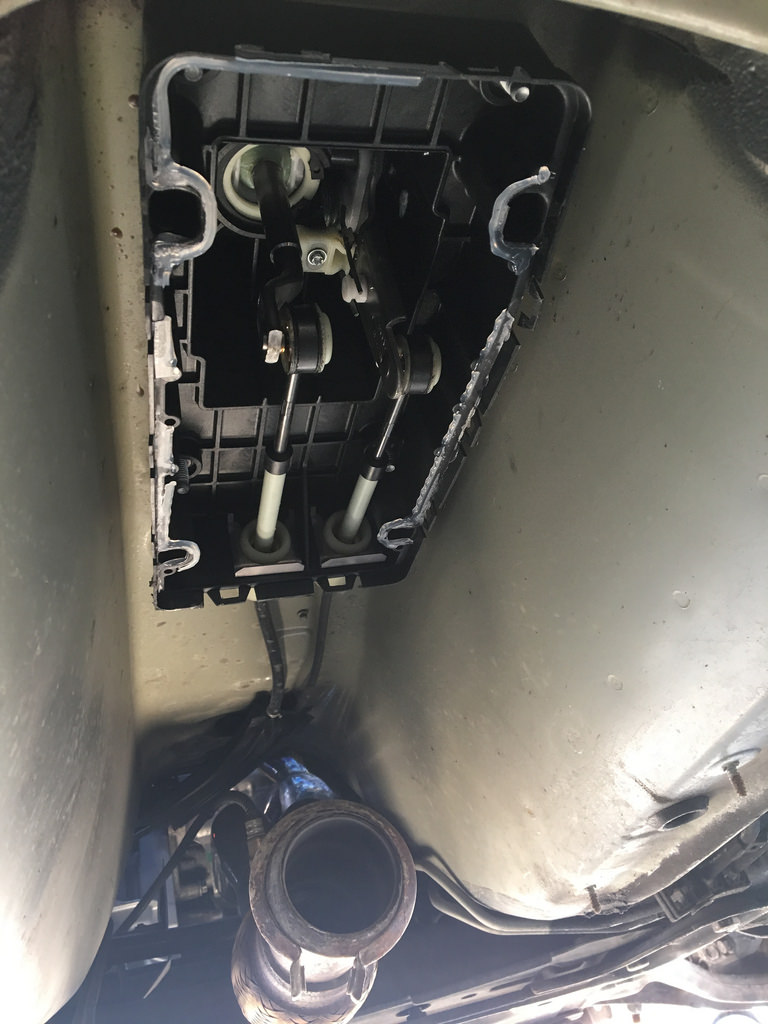

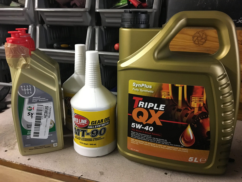

Changed the gearbox oil back to something I know is a proper GL4 fluid that will be best for the sycnros and if the box is getting hot handle the temps slightly better.
Fitted new gearbox cables ensuring that all the ball joints were correctly lubrated.

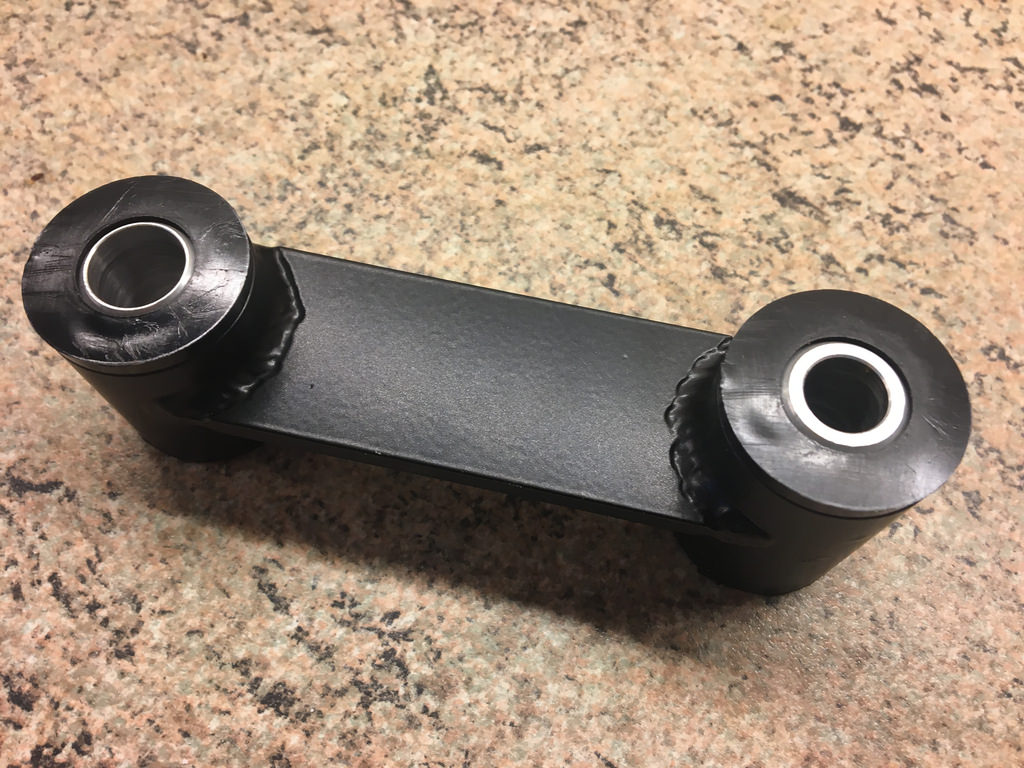

Stiffer and more substantial lower engine mount fitted to reduce some more of the engine movement. I did make up my own solid rose jointed version but It was a little too much for the time being.
Freshly rebuild alternator with a new Voltage regulator to sort out the charging issues.

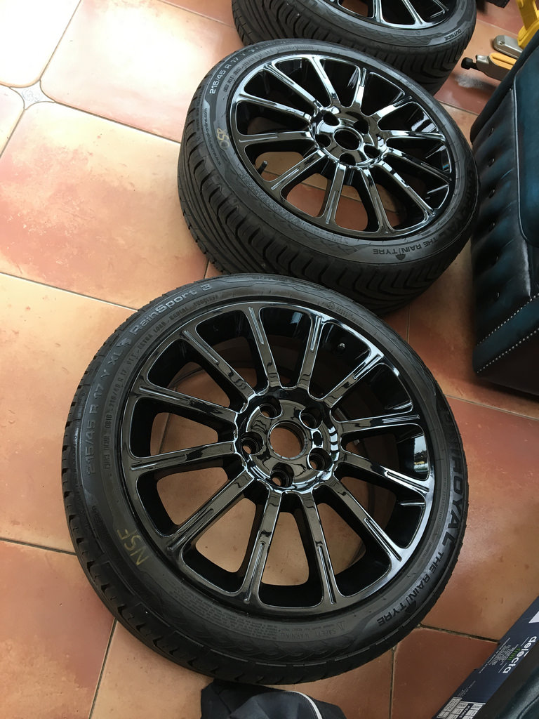

8 wheels back from the powder coaters. One set of Cup wheels and one set for 197 wheels. Took the time to weight them properly after they had gone through the same treatment of shot blasting, dipped and powder coated together.
197 wheels = 10kg
200 Cup wheels = 9kg (so a fair bit of rotational mass saved for free)

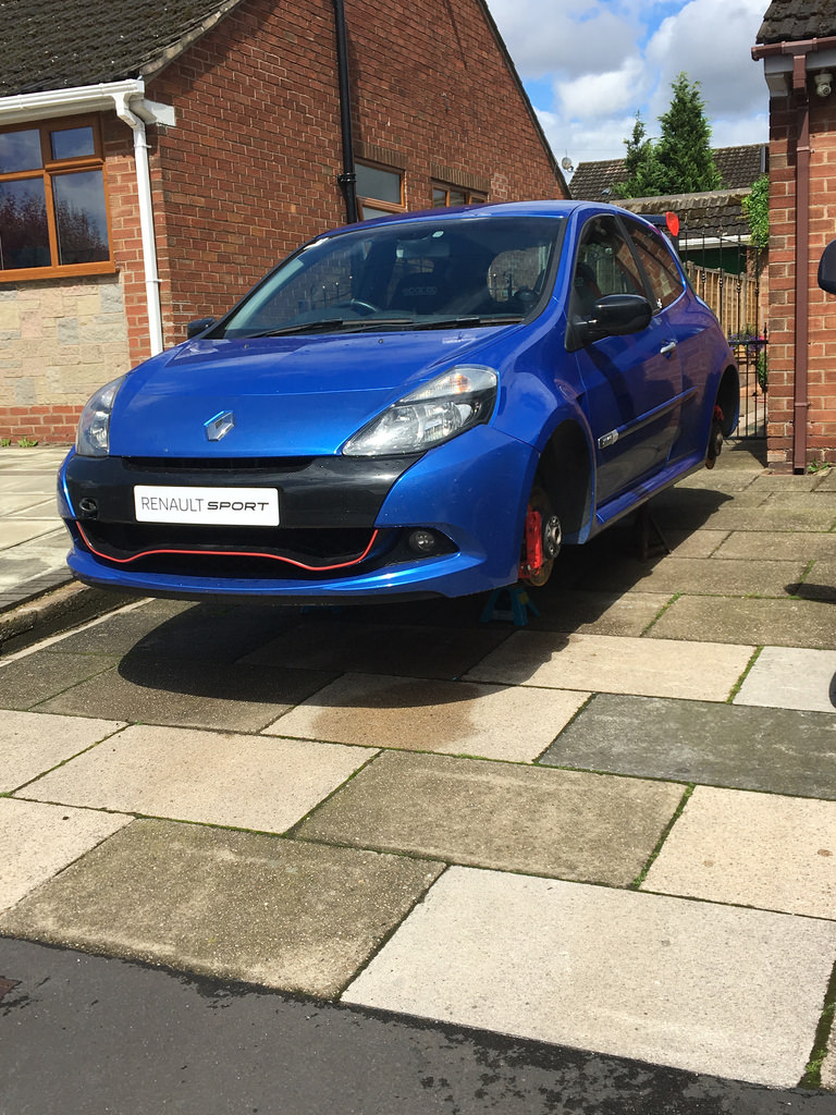

While the car was off the road on axle stands it was a perfect time to do something I'd been waiting 12 months to do with it...

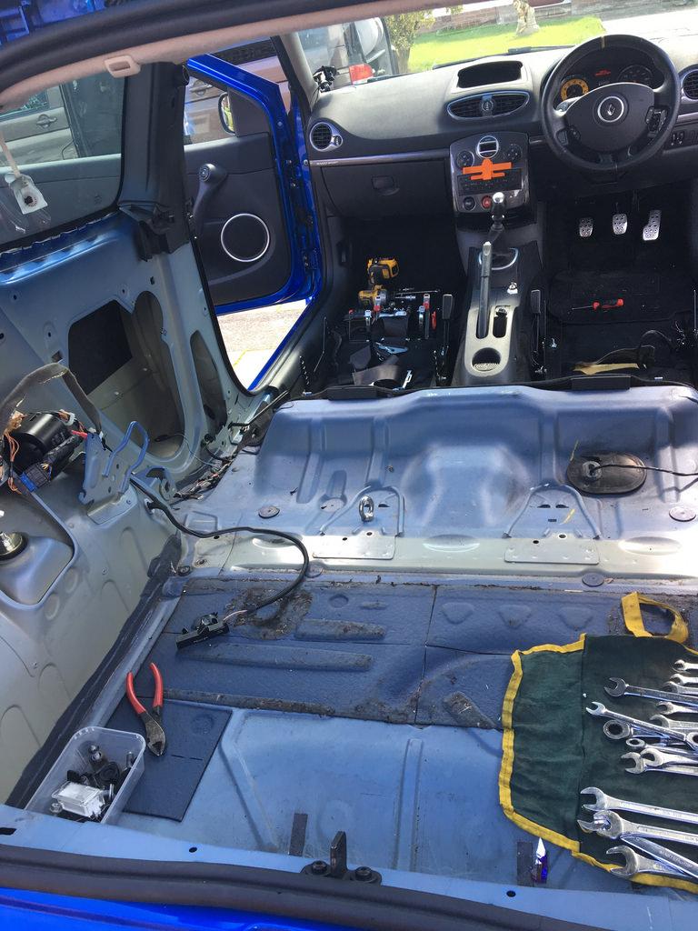

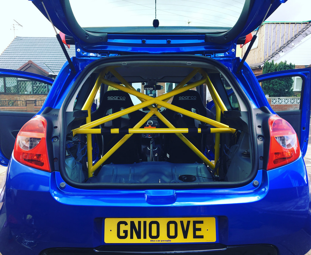

Out came the rest of the interior to make room for the Safety Devices cage. Powder coated yellow with double rear crosses and harness bar.

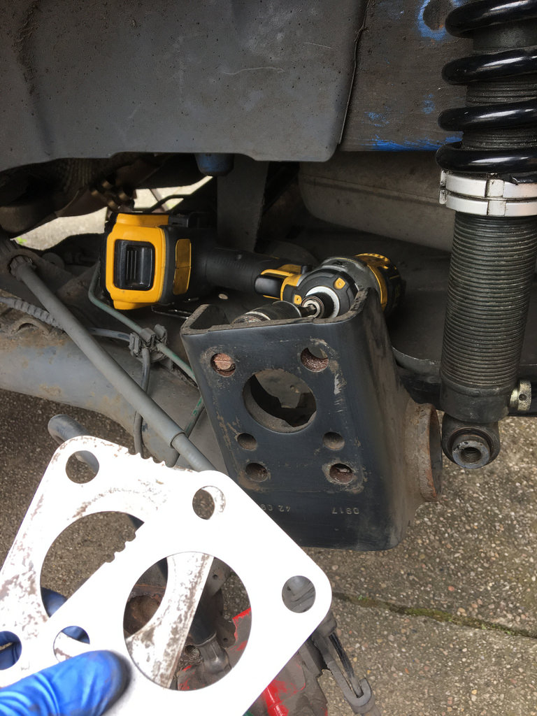

Rear beam shimmed to make the geometry a little bit more aggressive.
Print out looks a little bit like this now with parallel toe front, near parallel rear and 3.5 front camber and more on the rear.

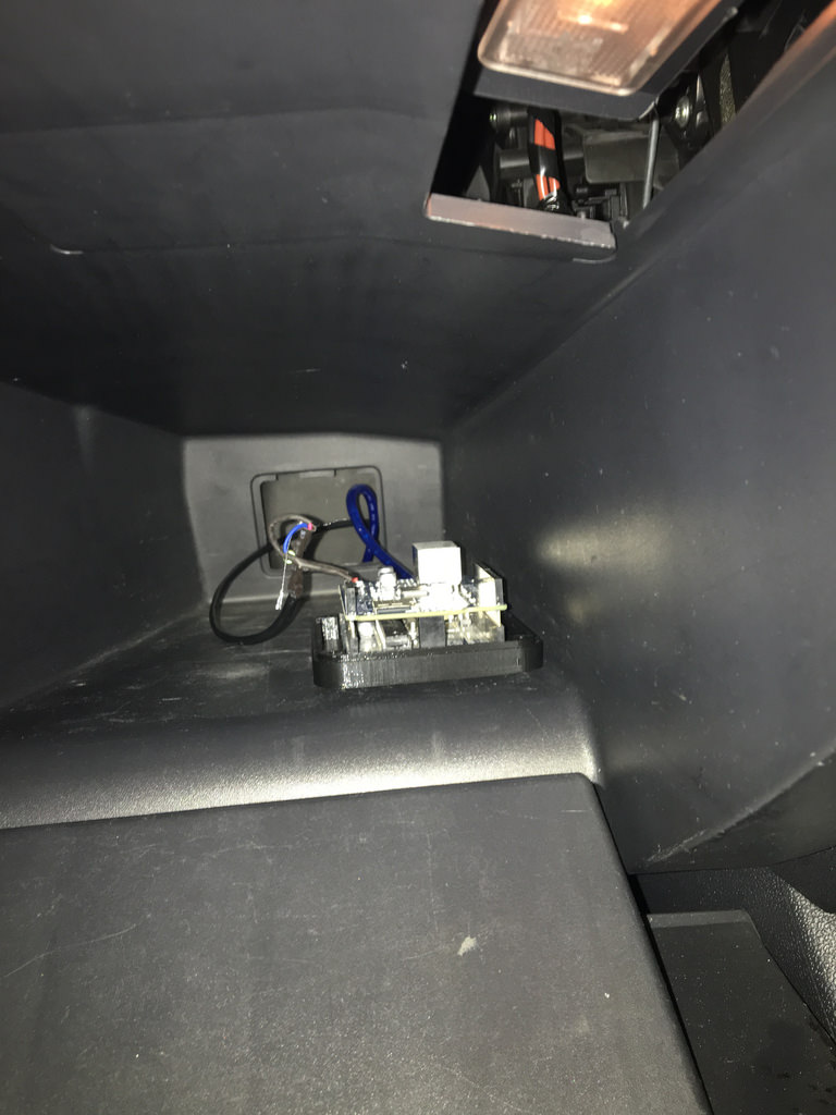

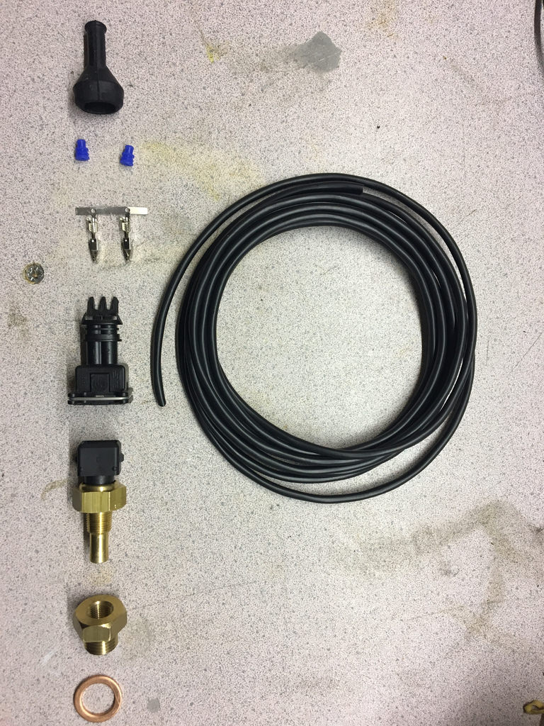

After starting to think about the gearbox temps at Cadwell I decided to start to set up something to monitor those temps in the box with the Gripper fitted.

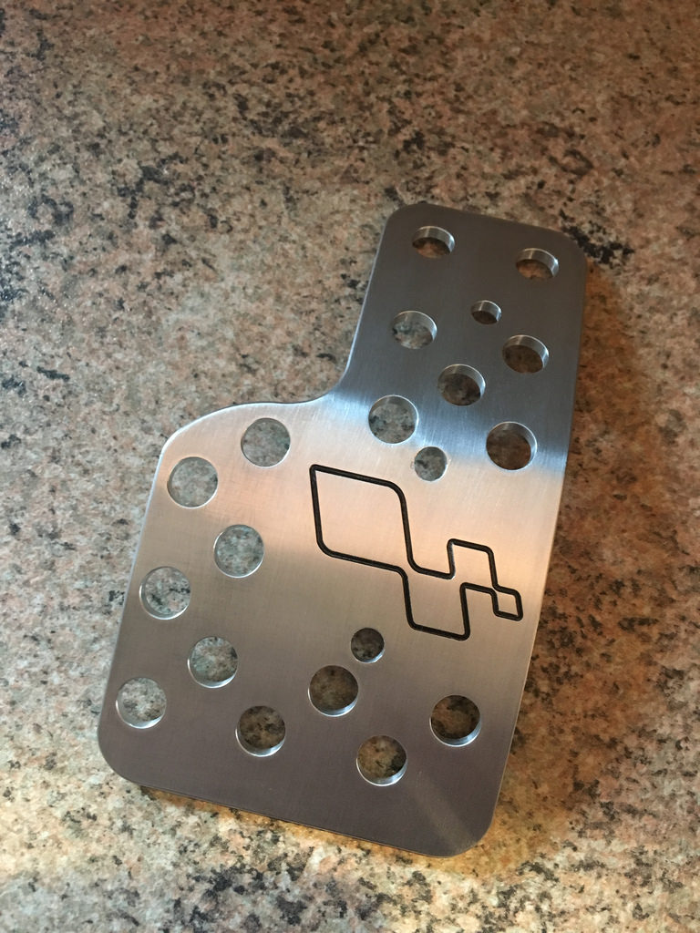

Heel toe pedal fitted to help out on track. I found the pedals slightly too far away for my own preference.

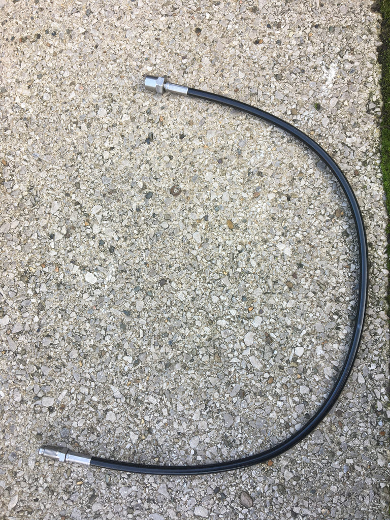

Also replaced the flexible clutch hose that runs around the engine bay and expansion chamber with a proper braided line and bled the clutch for good measure with all the changes i'd made.

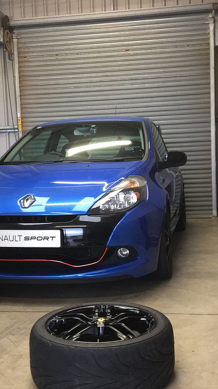

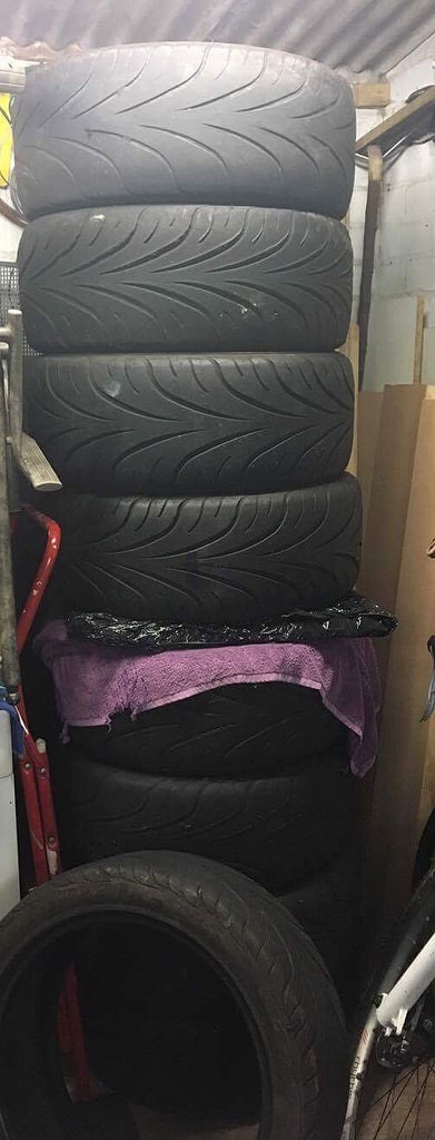

All started with the important tyre prep. Picked up another set of Clio 197 wheels and sent them away to be powder coated.
Also stocked up on some spare tyres for the additional set of wheels Id had powder coated and a 'couple' of spares too.
Had them mounted up to two of the new wheels giving me a total of 6 dry wheels with tyres, a set of wet tyres and two spare alloys in the loft for a rainy day. Can never have too many tyres in stock!
Also spent a little bit of time setting up a Arduino Data logger in the glove box. Wired in a power supply, wiring to the gearbox sensor and wrote a code for it to log the data of the inputs onto an SD card for viewing after the sessions on track.
Ordered some spare oils for the car and also some gearbox oil for the van. VW T5 which I use as a tow vehicle so like to keep on top of that too.

The weekend started with getting the car and trailer loaded up Wednesday and Thursday evening. I had managed to get all the little bits done like the gearbox temp sensor and the alignment measured the previous weekend so all that was left was to load up...
Friday evening was early tea and into be for 9pm. Tossed and turned for half an hour and managed to persuade my brain to get to sleep early.
4:50am Saturday morning I wake up a good hour before my alarm was supposed to go off considering I only live half hour away from Oulton. Decided to have breakfast, cup of tea and set off, a friend of mine was awake so we arrived at Oulton at 6-30
Plenty of time to unload and fit the dry tyres ready for the day ahead as the sky was looking promising.
The Clio in it's latest facelift with the Yellow cage and highlights, back with the fully gloss black spoiler now too.
The day was a great turn out of friends for the end of the year at our local track, We had enough people to fill 6 garages and lots of friends had planned to come down during the day as addtional drives/passengers or just for the catch up. This is what I love about these track days is the getting together of so many people. Random photo but really shows the buzz around our garage just before dinner.

I set the car up with the same tyres, tyre pressures and suspension settings from a known good set up that I'd been running earlier in the year at Angleysey followed by Cadwell, then set out on the first sessions of the morning. Interestingly the car was very tail happy even at half speed. Few more laps under the belt getting more heat into the rear tyres and it was settling down a little bit but was still having some brilliant oversteer moments without even provoking it.
Obviously these change in car was down to the fact I've re shimmed the rear axle close to parallel and taken a lot of the toe in off.
Came in for the car to cool down. Knocked the rear compression back a two clicks and dropped 3/4 PSI in the rear tyres. When the car was cool, quick check on the wheel bolts with the torque wrench considering they were freshly powder coated and off I went out again.
I'd managed to get the car really balanced and started to push on with the pace and start to use the gripper to the full potential. Putting on the power well before the apex of the corner pulls the front in nicely towards the inside of the corner causing the car to rotate and the rear end just break traction and rotate perfectly. This is the first time the car has left this balanced and was able to carry considerable amount more speed through the corner with the extra rotation rather than the tendency to understeer.
Combination of the new geo set up and the gripper diff feel absolutely spot on!!
Had a little play around with the gearbox temperature logger in the afternoon, wanted to test the set up and the program I had written, logged the temp for a good 20 minute session and the max the gearbox temp got to with the gripper diff was 90 deg with an air temp of about 5-7 degrees. Something I'll try again next summer but for the time being i'm happy with that temp.

Sometimes it's easily over looked the little changes that you make or the little things that people don't see. I've spent a little bit of time this week putting together a spec for the car. Interesting thinking back and trying to remember every little adjustment or purchase you've made.

Clio 2.0 F4R – 201.5 BHP 165 FTLB mapped at EFI Tuning
7750 RPM Limiter

Clio 197 gearbox TL4 003
4.73 Shorter final drive (137mph @ 7750RPM)
Braided Clutch line – Solid to chassis leg – Braid from leg to box slave.

Purple Polybush Torque mount
Purple Gearbox mount
Solid Lower Engine mount with custom PU Bushes.

335mm Compbrake two piece rotors
DS1.11 Brake pads
Motel RBF600 Fluid
Hel Braided lines

Safety devices R020 Cage – Double Rear Cross
Sparco EVO LF
L-TEC 6 Point harnesses
Arduino data logger

Cup Spoiler with black end caps

Geometry
Front Camber – 3.5 degrees
Front Toe – 0 degrees
Rear Camber – 2.5 degress
Rear Toe – 0.05” toe in
