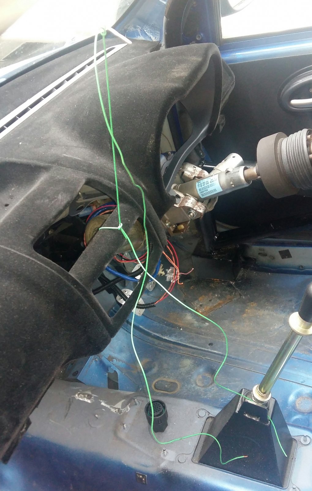

Hi all
I'm thinking of fitting just the top half of the dash to my Cup (sprint and hillclimb car) and was hoping that somebody who has done this can tell me if it supports itself without the dash bar?
Thanks
Wyn
I only have the top dash and no it doesn't support itself. However all it took to hold it up was making a small bent piece of metal from the steering column support to the hole where your clocks would usually bolt through. Hopefully that made sense, lol.
Thanks Matty. That makes sense! I'll need to make some brackets up to support the outer ends too.
