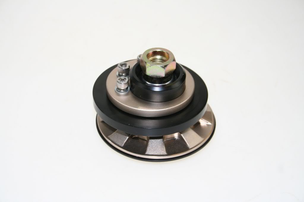

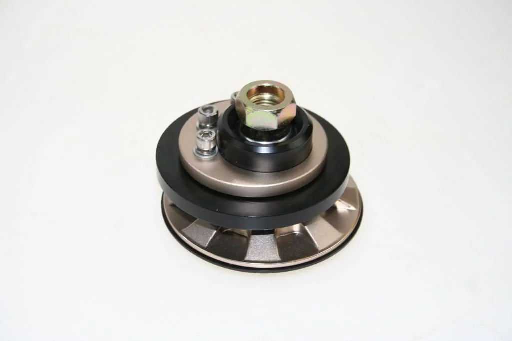

Thanks for the advice. Although what's your view on the below?
Didn't even know these existed. Has anyone had any experience with these?
I think we sold about 60 of them but not enough interest to keep running production and storing the parts. I think we will just focus on the BC racing ones as they do the job at a great price (I think £140 retail) and I dont have to faff with high volume production runs.
Even with the BC top mounts its not too much to machine a custom nut and sleeve if it needs to be done to work.
