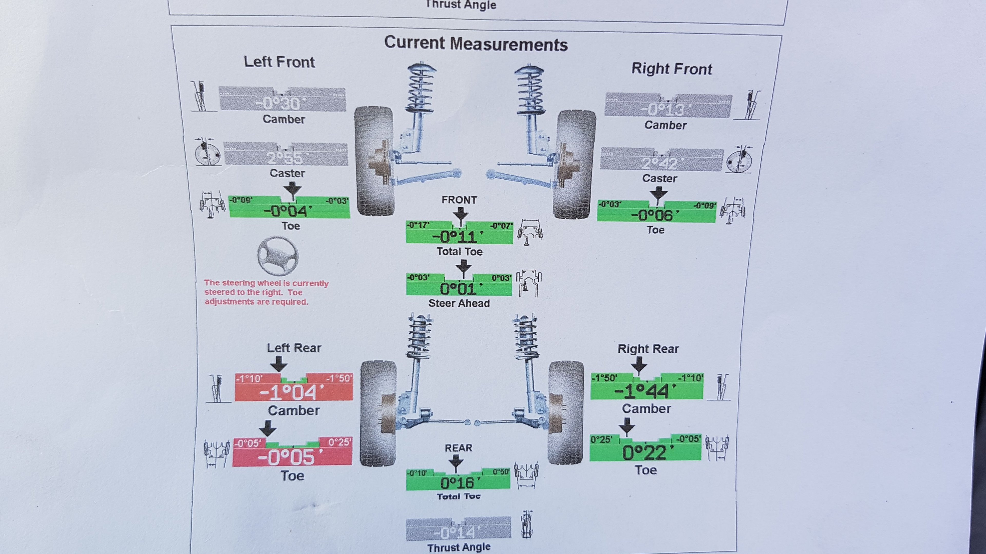

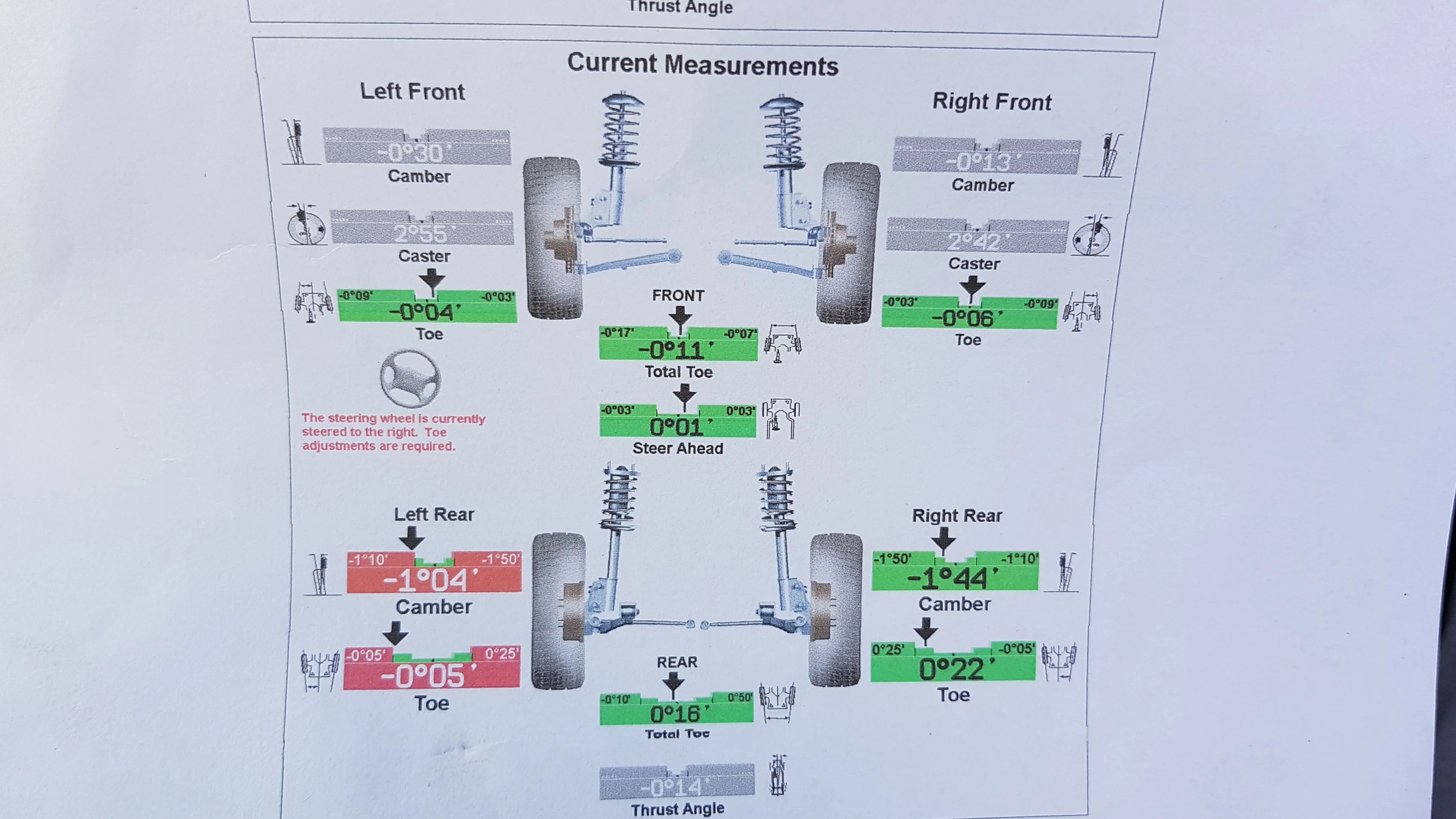

@hipwell
Yeh toe is ok now.
Front right could do with a bit more camber but if have thought if that was the issue it would pull off power too
