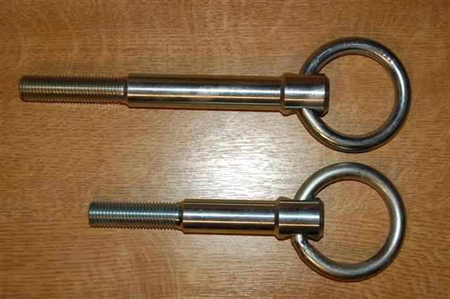

for ref... this is how the front and rear genuine towing eyes differ (top one being a rear towing eye)...
don't think you can get hold of them anymore. I've had a prototype rear towing eye made which i need to trial. just need to get off my ass n do it!

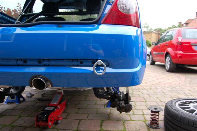

This is what D4ve's done with his rear towing eye on his 182...

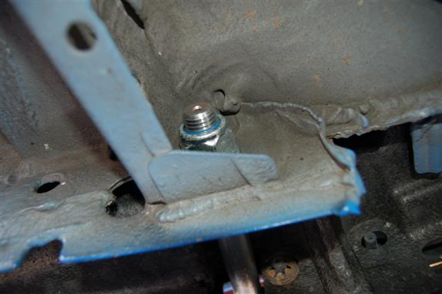

just bolted either side of that thin plate. Not sure what that area looks like on a ph1 but i'm guessing there's some re-enforcement and a screw thread.
this is how it locates...
