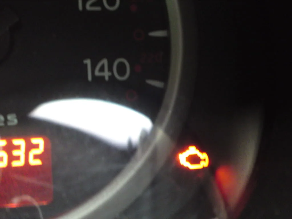

Toxic Fume Monitoring Warning Light...
Car  Combo
....has just come on and the car has a real loss of power.
Does this usually mean the coli pack has gone as I replaced it about 2 years ago.
I know the Clio is renowned for having coil pack problems but do they fail this frequently?
Thanks.
Always replace coil packs two at a time 1 and 3/ 2 and 4.
I had one go and replaced then about 3 weeks later another went. They all seem to start going after you replace one... :(
Flashing or on steady?
On steady.
Mine came on when the exhaust snapped.
f**k that!
But I don't think it will be this as surely the car would sound like some Halfords machine.
Thanks, will bare this in mind.
It's emissions. If it's not a spark problem but it very hesitant and jerky on part throttle then it's probably a lambda sensor.
If you've got 2 lambdas in it, replace the upstream first, or have it plugged in to see which the ECU is complaining about.
Yeah thats sounds like the problem.
Thanks Mark.
