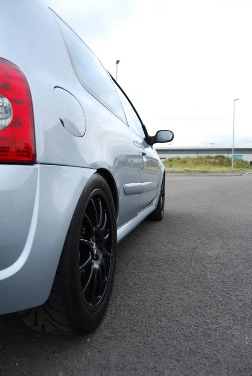

You're better off getting 195/50/16. With 205 width, they rub due to the higher profile.
the 195's are HOOOOOOGE! 205 will be to big as said.
195/50/16 is spot on.
ForceIndia
  Gentlemans spec 200
Read my post dude. They only come in 50 profile or higher. As they have a very square shoulder they are wider than a normal 195. I tried 205's, they rub. You want 195/50/16.
