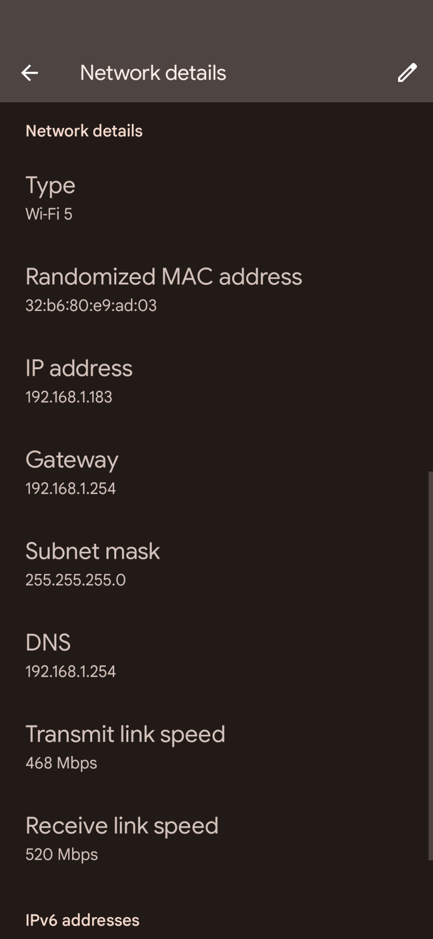

Check the IP in the WiFi setting on your phone or log into the new router and check the IP of the connected devices
This......
Gavin.
That’s why, the new router is running a different subnet, you’d need to get into the console of the new router and change the dhcp to give out 192.168.0.* addresses instead of 192.168.1.*
