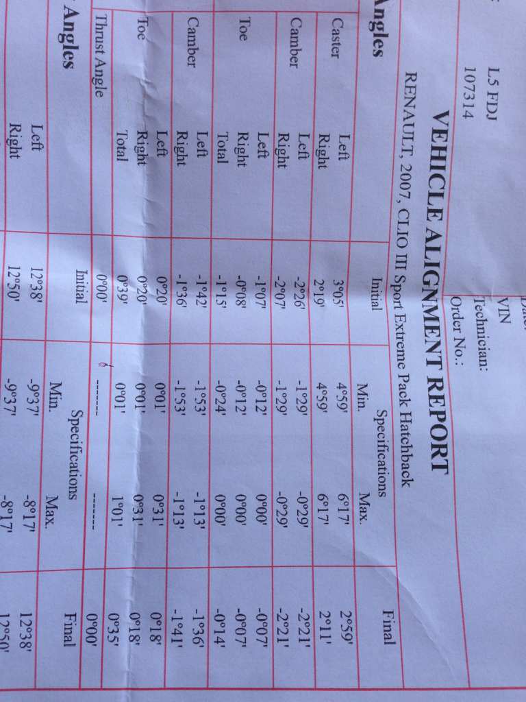

I run between 2-3 degrees of neg camber on the front normally and either parellel or tiny bit of toe out.

That's mine, and its a ph1 not a mk3 lol
