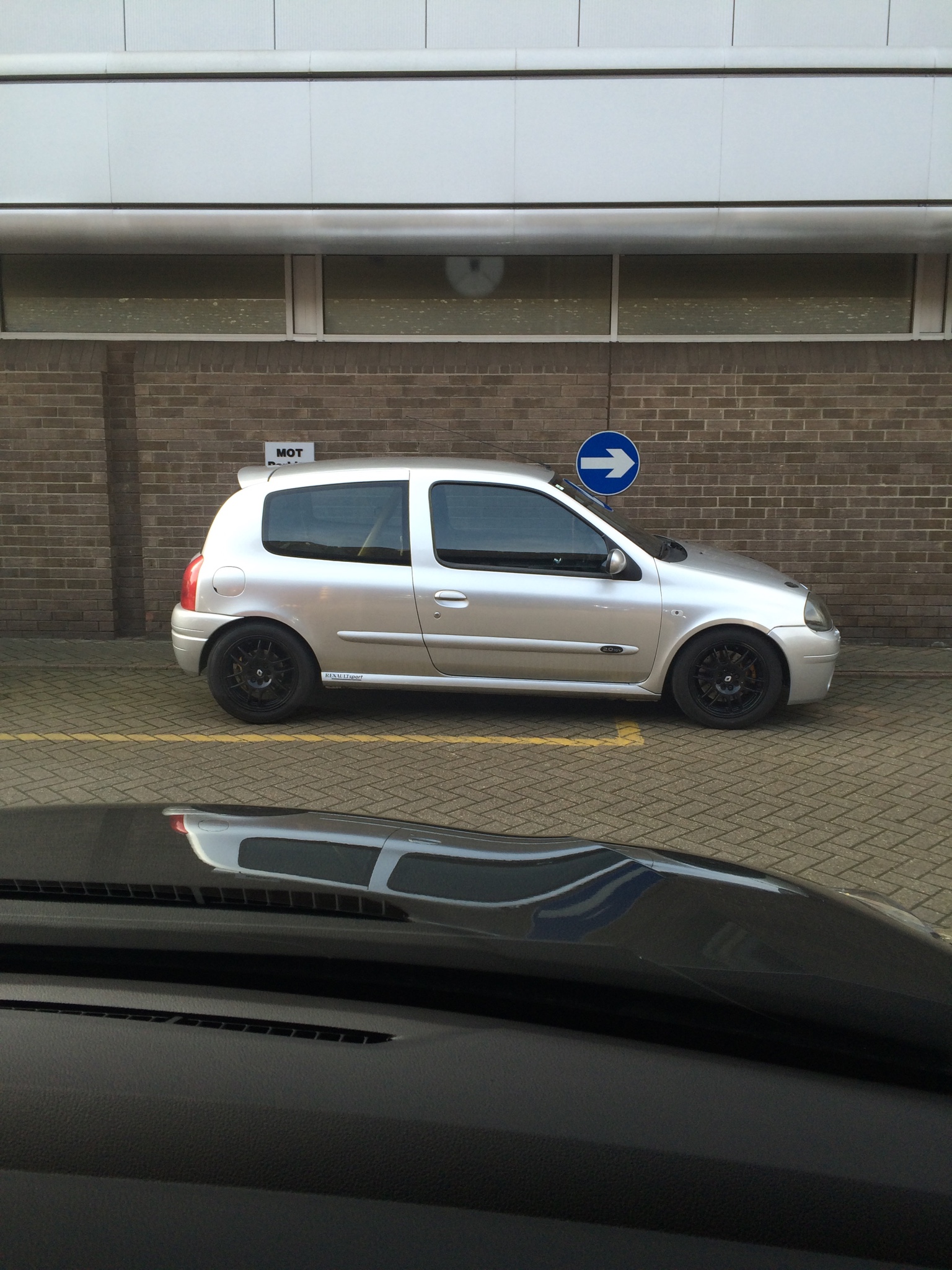

The only one I have . My motor has some forward rake to it .
Helps a lot with turn in.

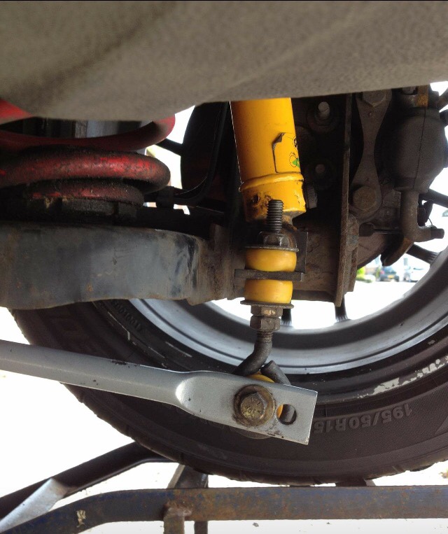

Are you running platforms at the back ?
  172, BMW 650i & X5
Was originally, I removed them to lower it more and she's still about 40mm between tyre and arch. Was thinking of full rear coilovers.

What springs you using ?
Can you see I have a 6mm gap to lower the platform still .
I think maybe a full strut coil over would be your best option , as you'll have more adjustment , only issue I see with running a full coilover is that the body weight sits on the shock and puts extra stress on that point .

Can't identify springs bud unfortunately.
Don't follow with the 6mm gap, can you elaborate?

Where the adjuster sits under the spring , so I still got a few turns left to lower it down before it stops . So the height you see in my first pic could come down a little further .

I've actually removed adjusters altogether to get down as much as possible and still high. Can these rear axles be pre loaded?
