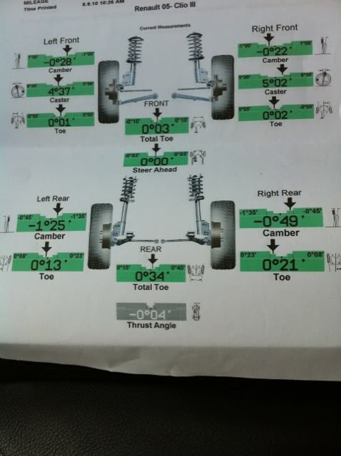

In standard form the car could pretty much stay in a straight line with my hands off the steering wheel. I've now lowered the car, I've also had the tracking done and had a camber correction bolt installed. On paper my tracking all seems well however the car seems to pull to the left/right when taking my hands off the wheel. Is this normal? What's the reasoning to this?
Printout of my tracking:
Any help would be appreciated, thanks!
right rear camber seems very different to left rear, don't think this is the way it's supposed to be
Anyone? I can tell the rear camber is uneven. I'm asking is it natural for the steering to be like this once lowered.
