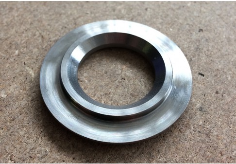

Did you make a point of swapping the rear disc spacers over, with flat side in contact with the wheel bearing ?
You may find something usefull in here too.
https://www.cliosport.net/threads/abs-esp-and-serv-lights-problem.791935/
Fitted brembo HCs think the rears were just normal brembos i cleaned the spacers up before putting them back on as you said with the flat side on the bearing. Will have to get it plugged in at some point! Cheers for the link.

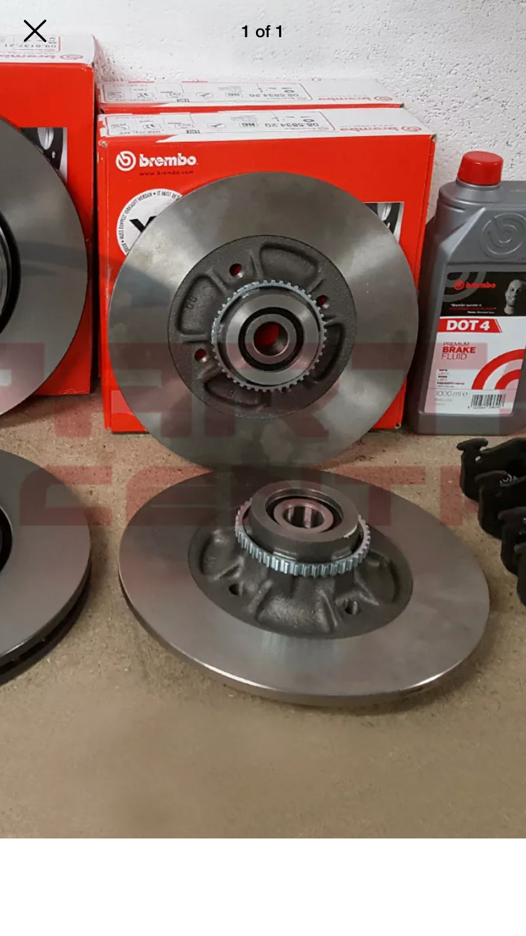

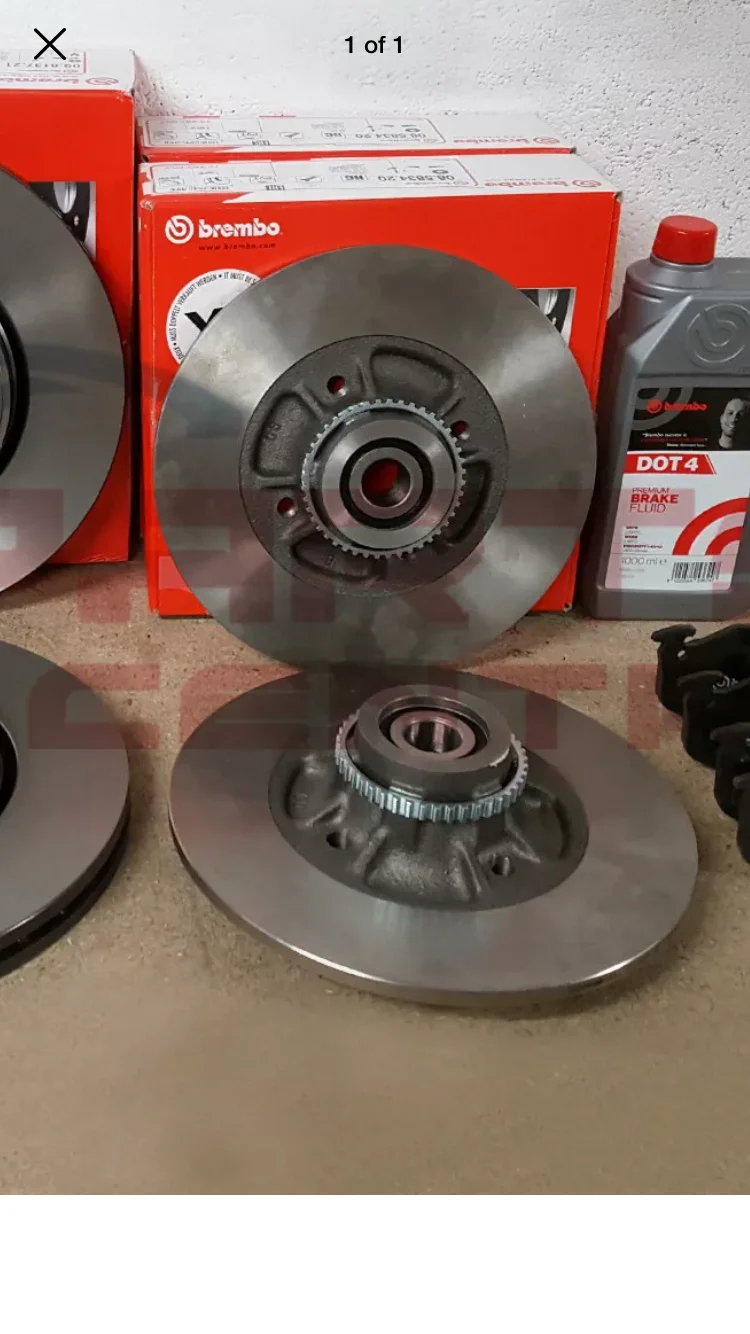

If they were Brembo, you would have needed to swap the ABS rings.
The Brembo Renault Clio rear brake discs (08.5834.25) are suitable for the Renault Clio with ABS and come complete with high quality rear bearings but do not come with ABS rings. Either the standard ABS ring will need to be swapped from the old disc or a new one purchased or if fitting to the Clio 172 CUP an ABS ring is not required. We supply ABS rings here. Discs sold individually. We do sell some cheaper options for rear discs. The Mintex rear brake discs and Renault OE rear discs. Both come with the wheel bearings and ABS rings fitted
This is what i bought - sorry if i’m being thick but I thought that the abs ring was fitted to the rear disc as per the picture?

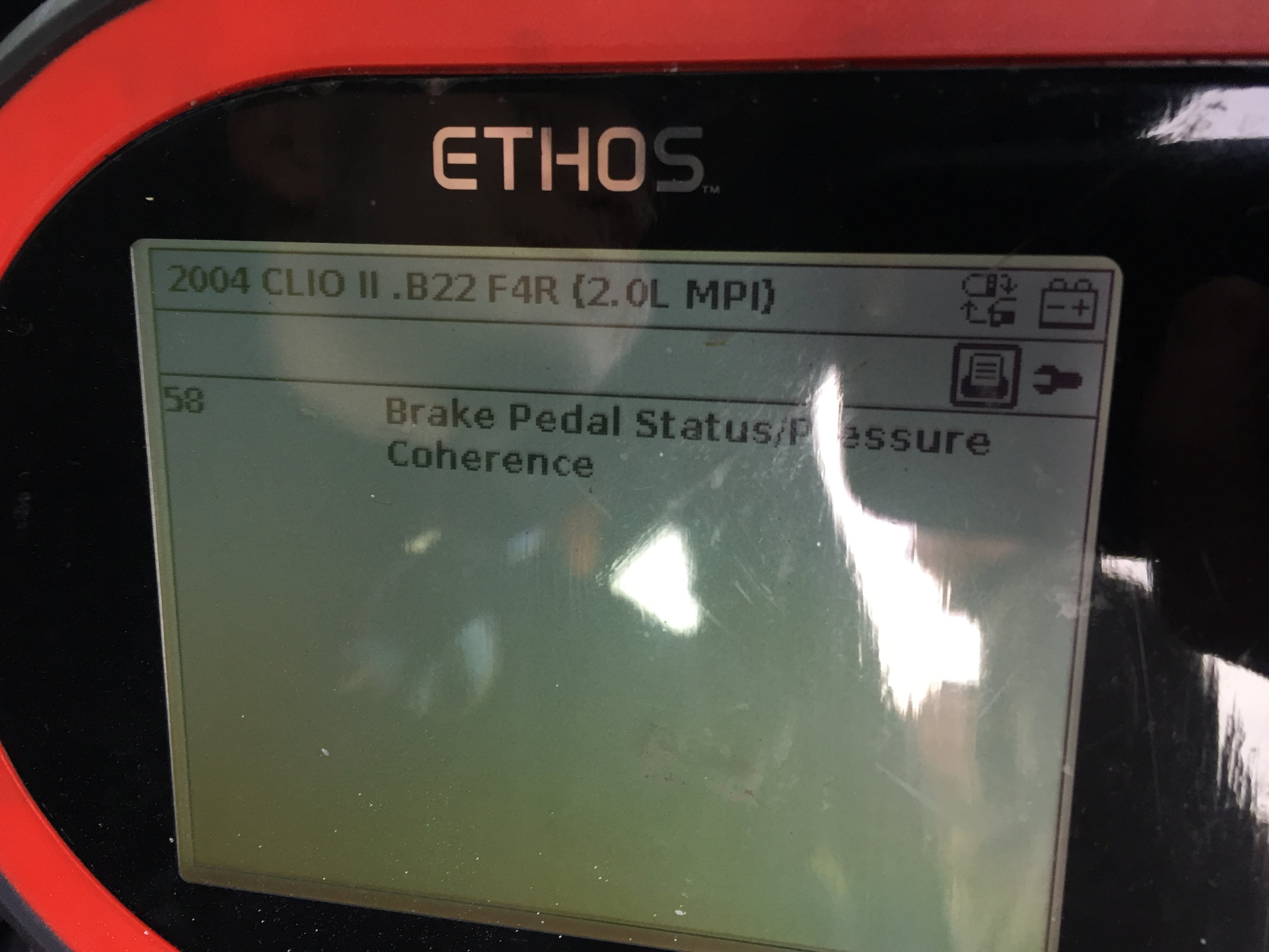

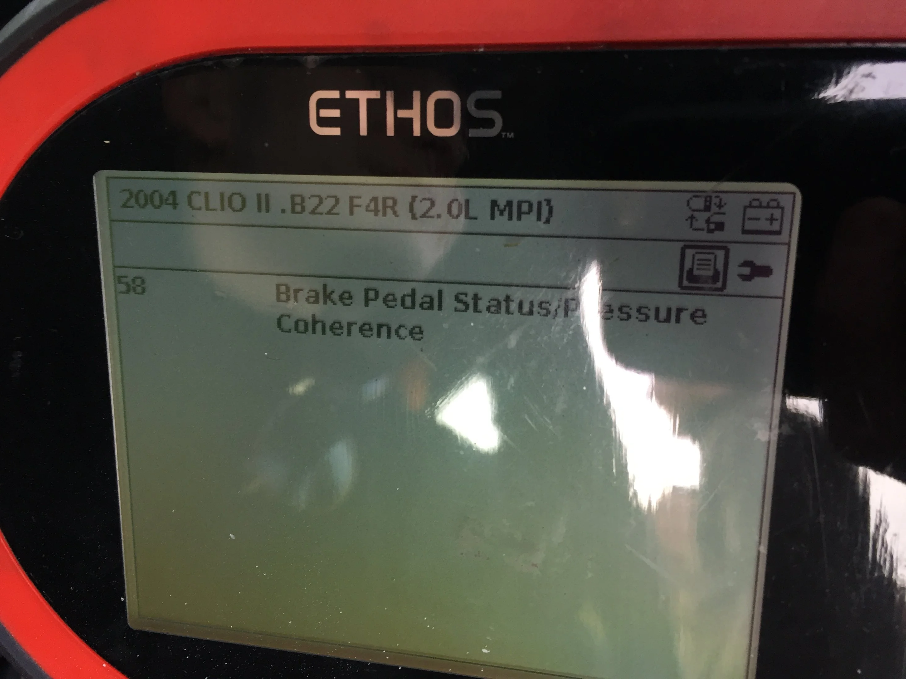

When you say plunger do you mean the little black tab bit at the bottom of the sensor or do you mean the actual whole sensor where it connects to the main wires? Had it plugged into a snapon code reader yesterday this is the fault i’m getting.
Also had a check for the emissions as eml light has come on after exhaust was welded yesterday - was expecting it too because of the decat however car went into limp mode on the way home - code reader said precat lambda which would explain 26mpg, hesitation, rough idle and popping on downshifts (I drive like a granny)
