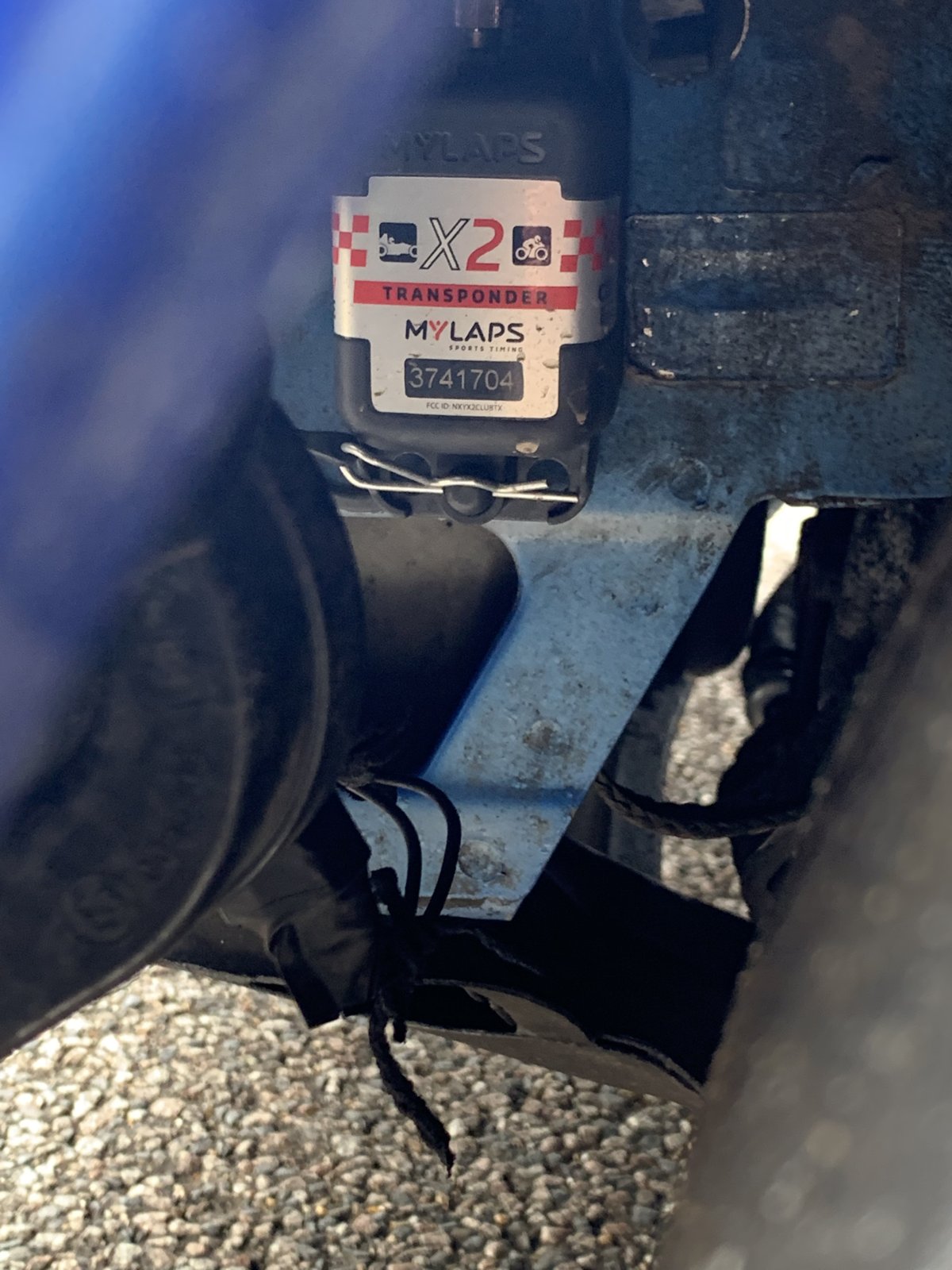

Transponder position.
Mine is in n/s wheel arch liner
Does it need line of sight to floor?

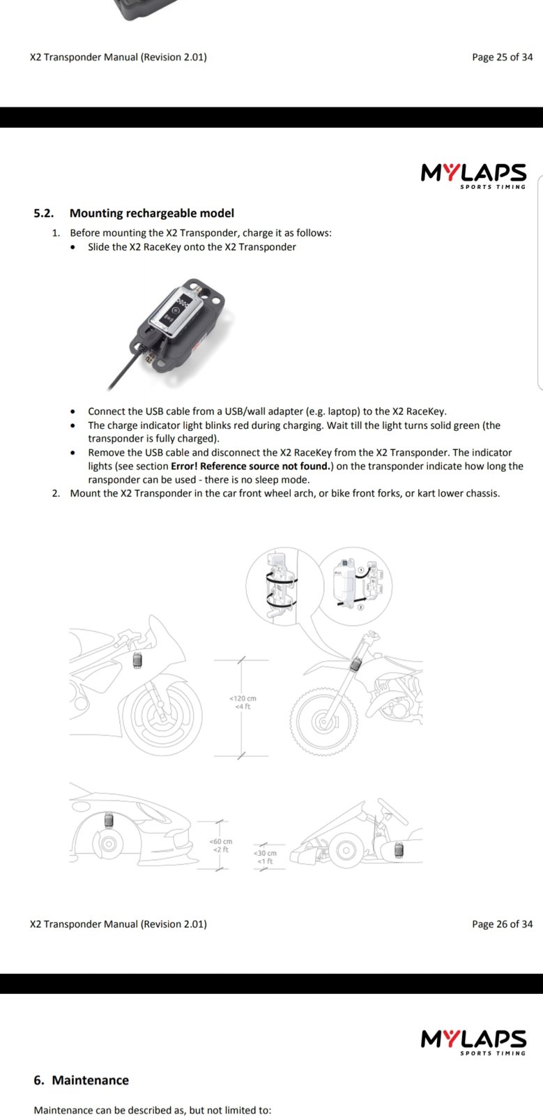

Not as far as I'm aware, I've seen a few mounted in odd positions shall we say, needs to be within 2 feet of the ground though according to the manual (for the newer x2 transponders)
