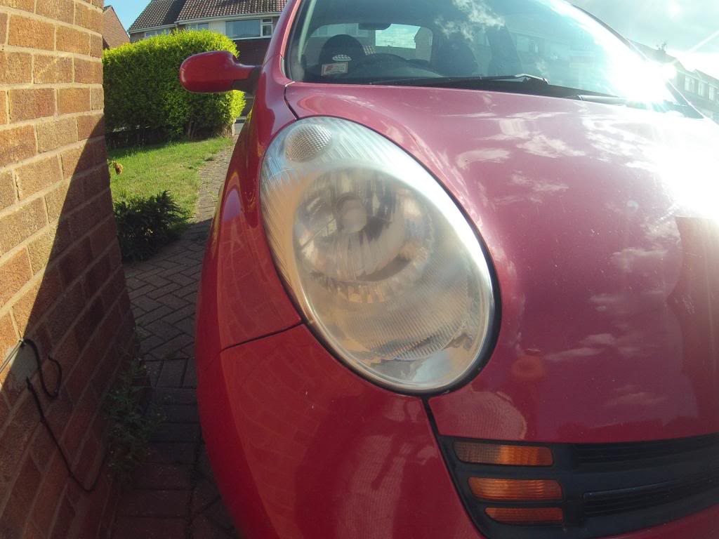

A before of the passengers light (the worst of the two..)
(Also showing some faded red paint to rival a Trophy's...)

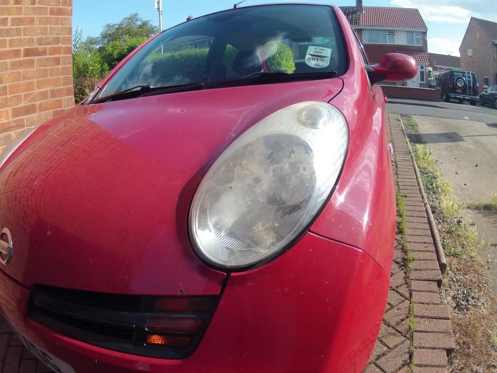

And the drivers side (better, because I had a go at this one before but ran out of f***s to give..)
I attacked them both with some 800grit first to get the raised abrasions off, then 2500 then some 3000 (had some lying around). Finally I'd invested in some Meguiars scratch x - the stuff is incredible! The 3000 grit left them quite cloudy (still better than before) but the Meg's stuff made them look like new (nearly..)

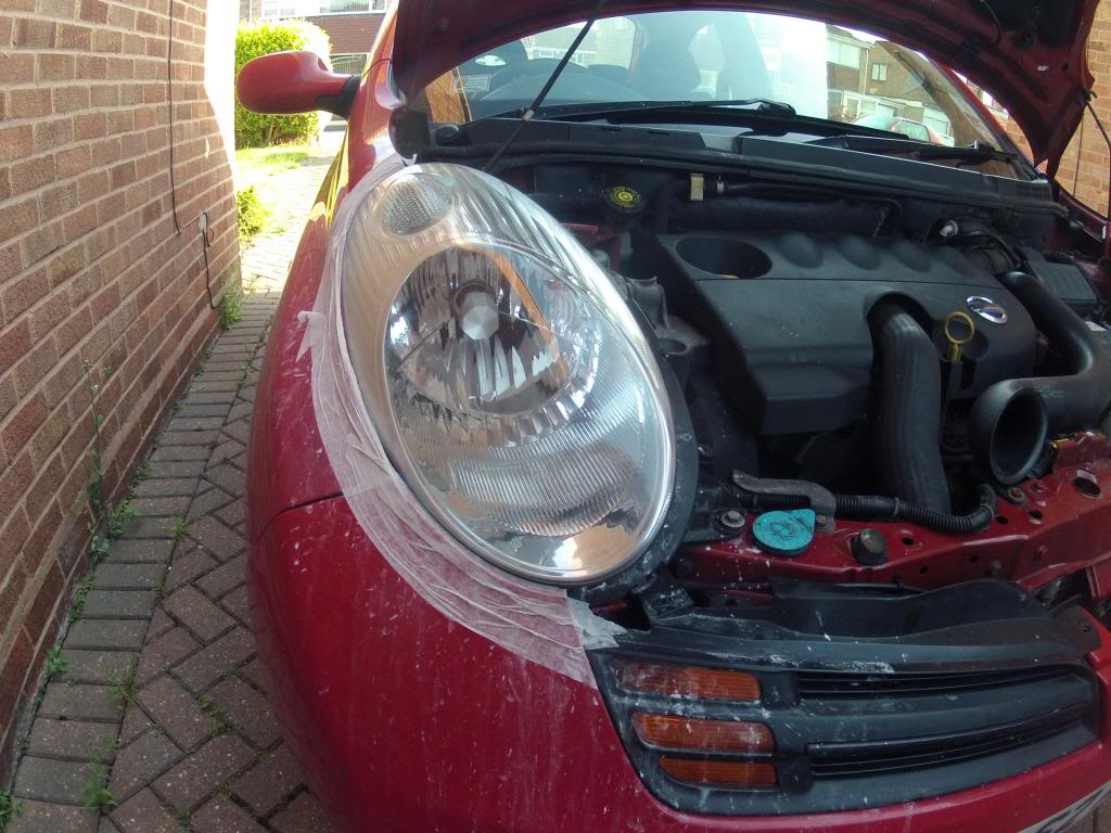

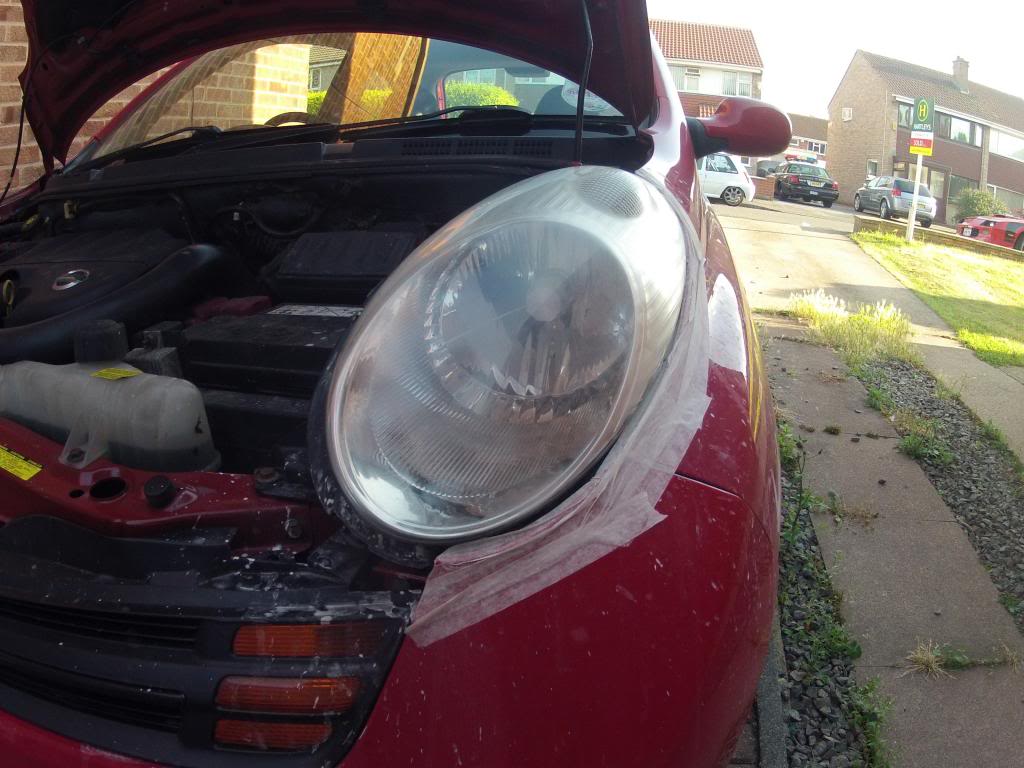

Some durings...
(yes, that is masking tape, yes it was a bi*ch to get off in one piece, and no, I didn't do it with the bonnet closed - I had to nip out to get the Meguiars... got some funny looks!)

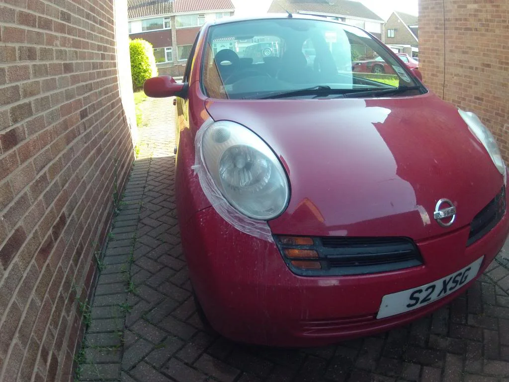

And finally, the only after i got, but a visible improvement. I've also whipped the indicators/grille out and gave it a dusting over with some satin paint (will get photos when its all back together)
At least now the front looks average, shame the rest is a couple of shades of pink/dirt (any volunteers...?)
