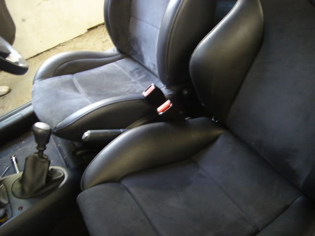

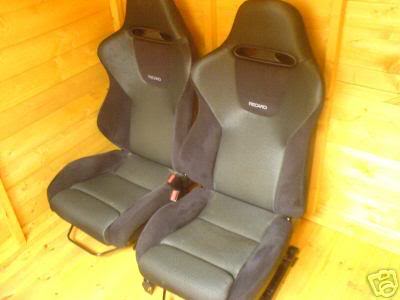

The Recaro Trendline seats out of a Honda Accord Type R are basically the same with similar colour scheme i.e. black and grey. I have just bought some for my Clio V6 and they cost me £350 off e-bay, they come up quite often, here is a picture ...

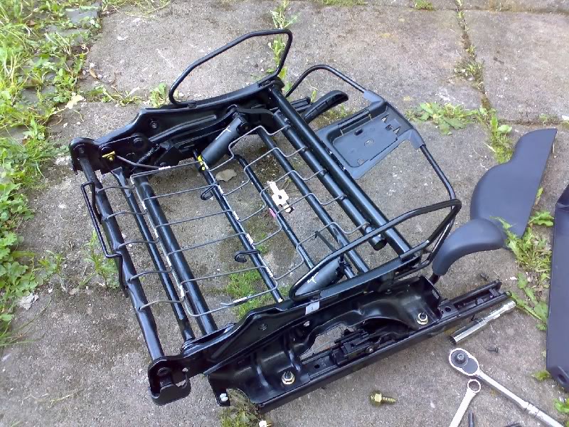

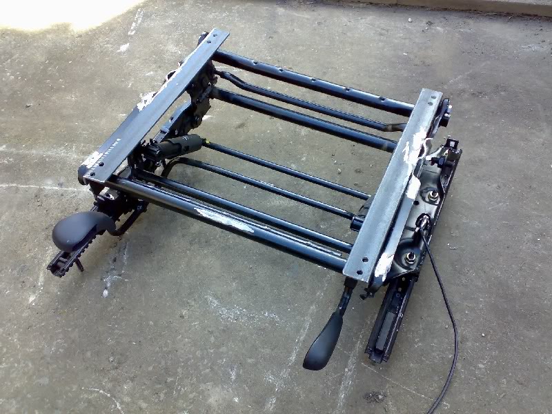

Also tonight, out of interest, I butchered a stock Clio subframe and the bolt holes line up with Recaros so without any welding I could, in theory, use the stock subframes and sliders to retain the adjustment and OEM look. If I finish the prototype I will post some pictures - took about 2 hours so far. In fact having seen how the stock sliders can be removed from the Clio seats simple adaptor brackest could easily be fabricated to mate from the Recaro side bars to the Clio sliders - has anyone done this ? In factr I think the Recaro subframes make use of the stock Clio sliders.

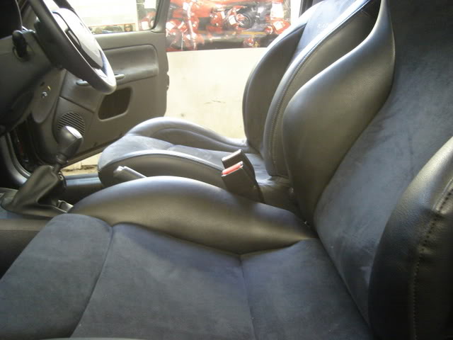

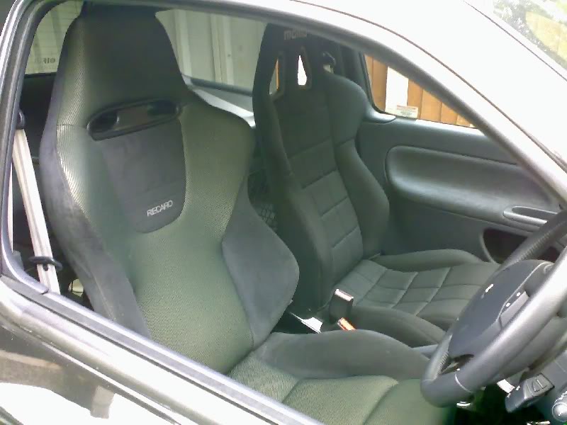

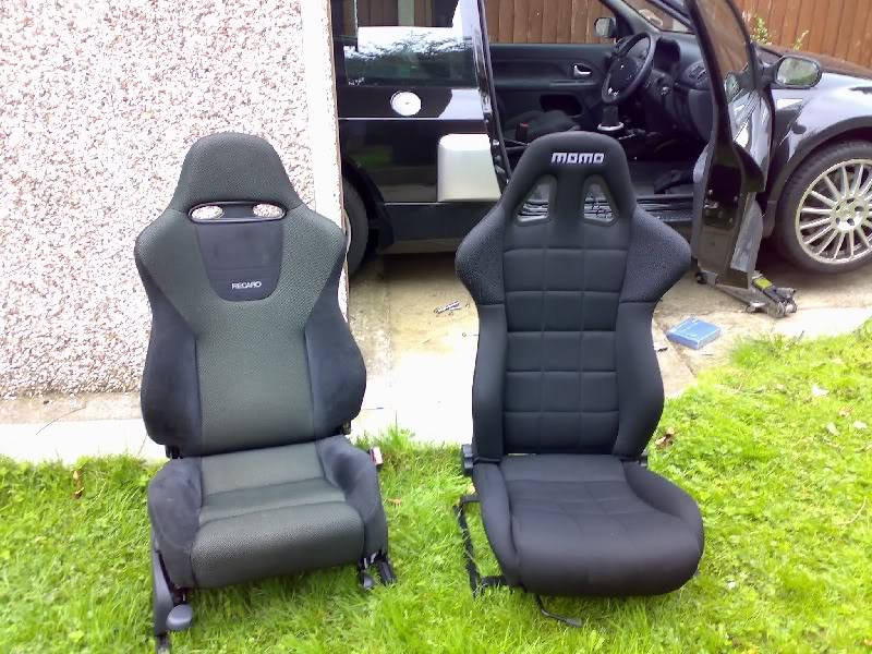

Wont sit you as low as yours, but here are some pics for the doubters. They are lower. some during pics lol ;)
  Clio V6 Mk2 255

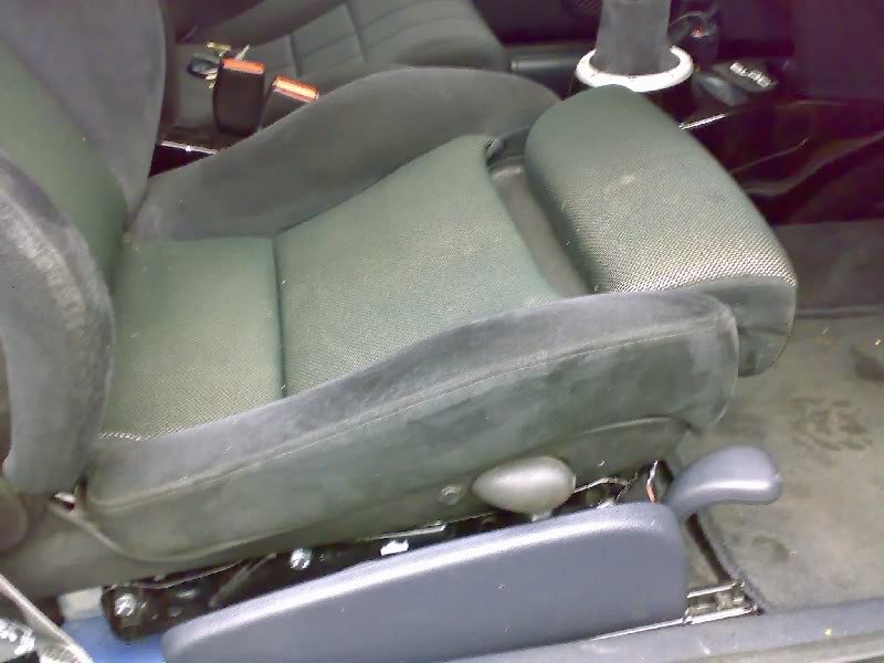

Here are some pics of the Trendlines (one anyway fitted).

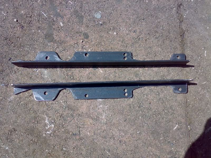

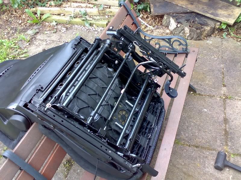

As I mentioned before fabrication is all that is required for subframes so here is the OEM subframe modified for a Recaro - very easy to do ;-) If you are prepared to sacrifice your OEM seats (you need the sliders anyway) then you can have free subframes ...
Also apologies for the phone camera quality ...

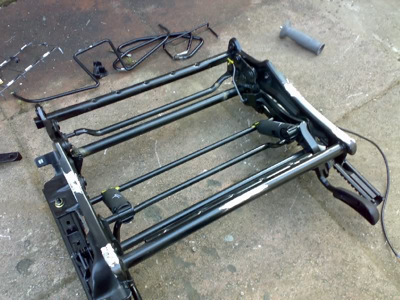

Drivers side subframe removed from the seat upholstery ...
Hair cut ...
Brackets I made ...
Fitted to subframe before painting ...
Fitted to seat ...
Ready to fit ...
In the car (the seat is cleaner than it looks in the pic too !) ...
