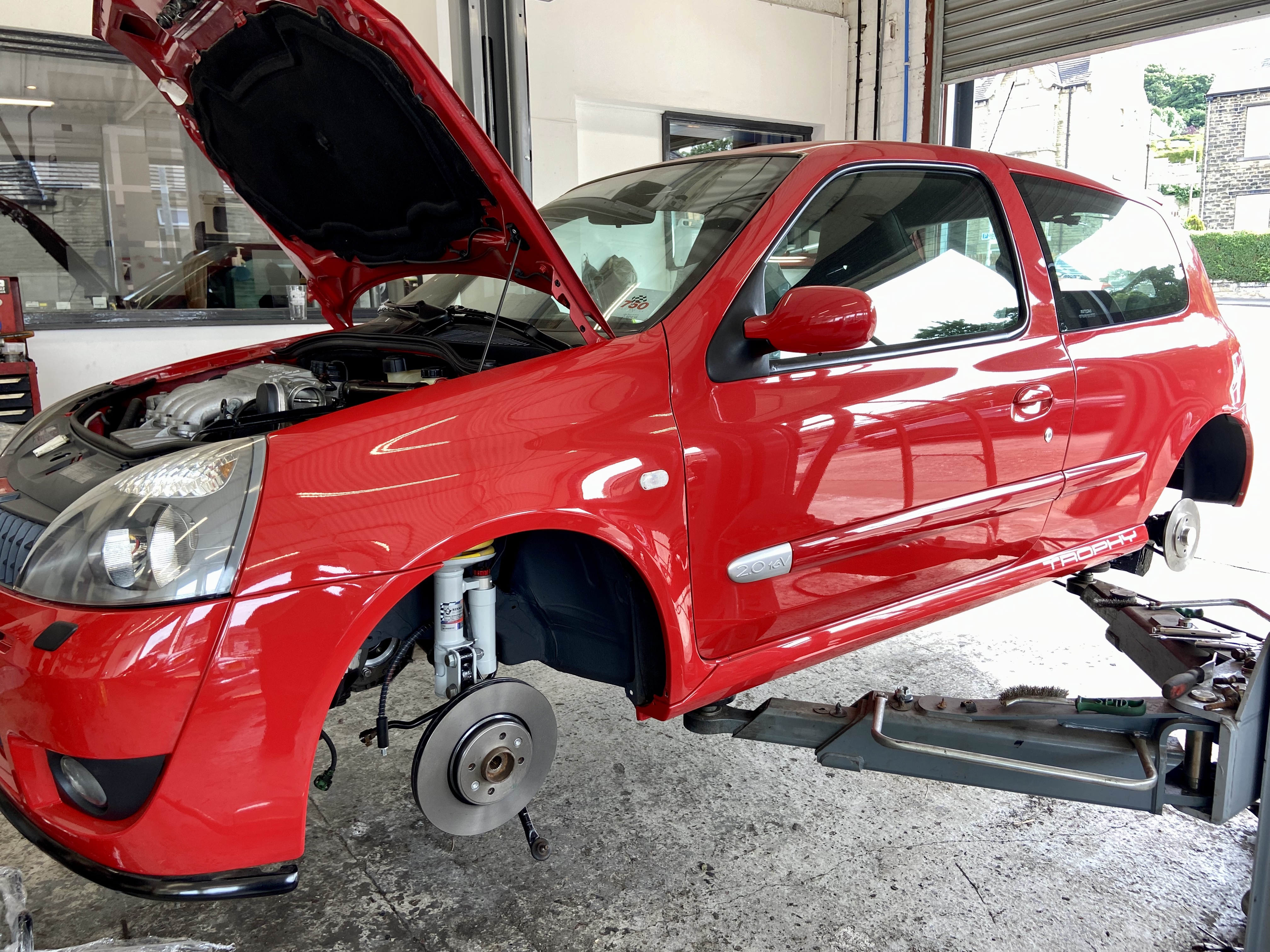

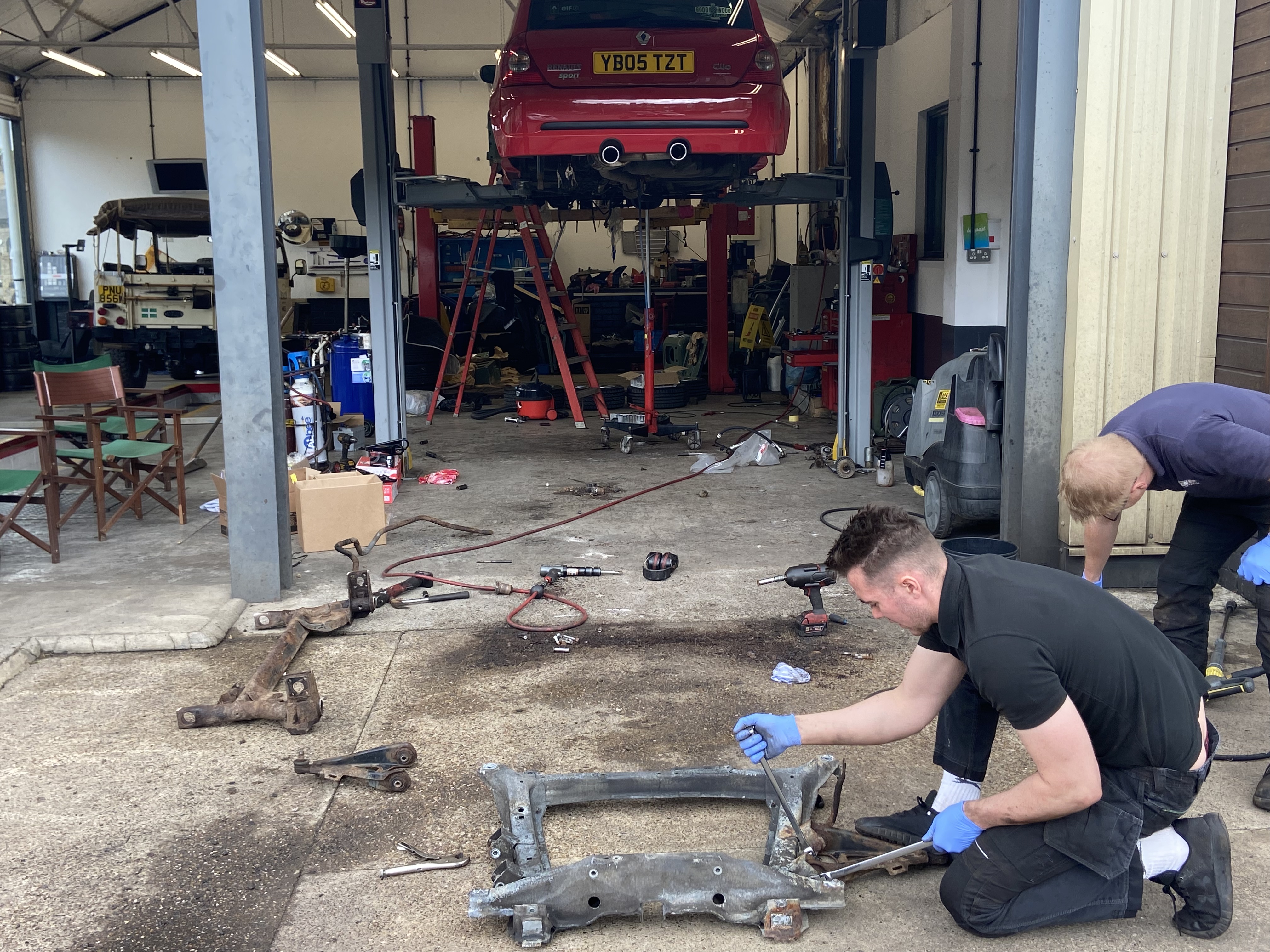

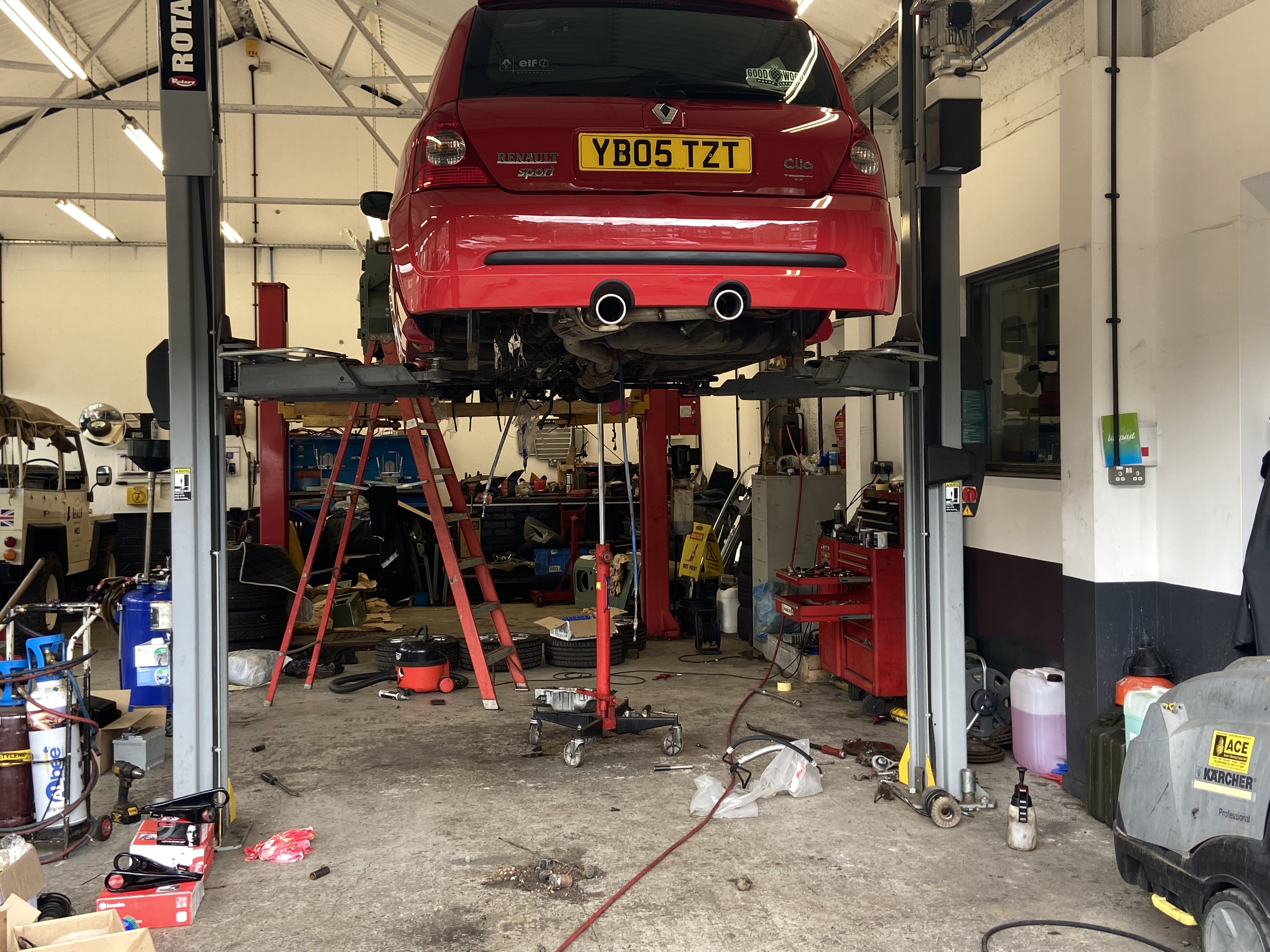

has now begun - made great progress today with stripping everything off

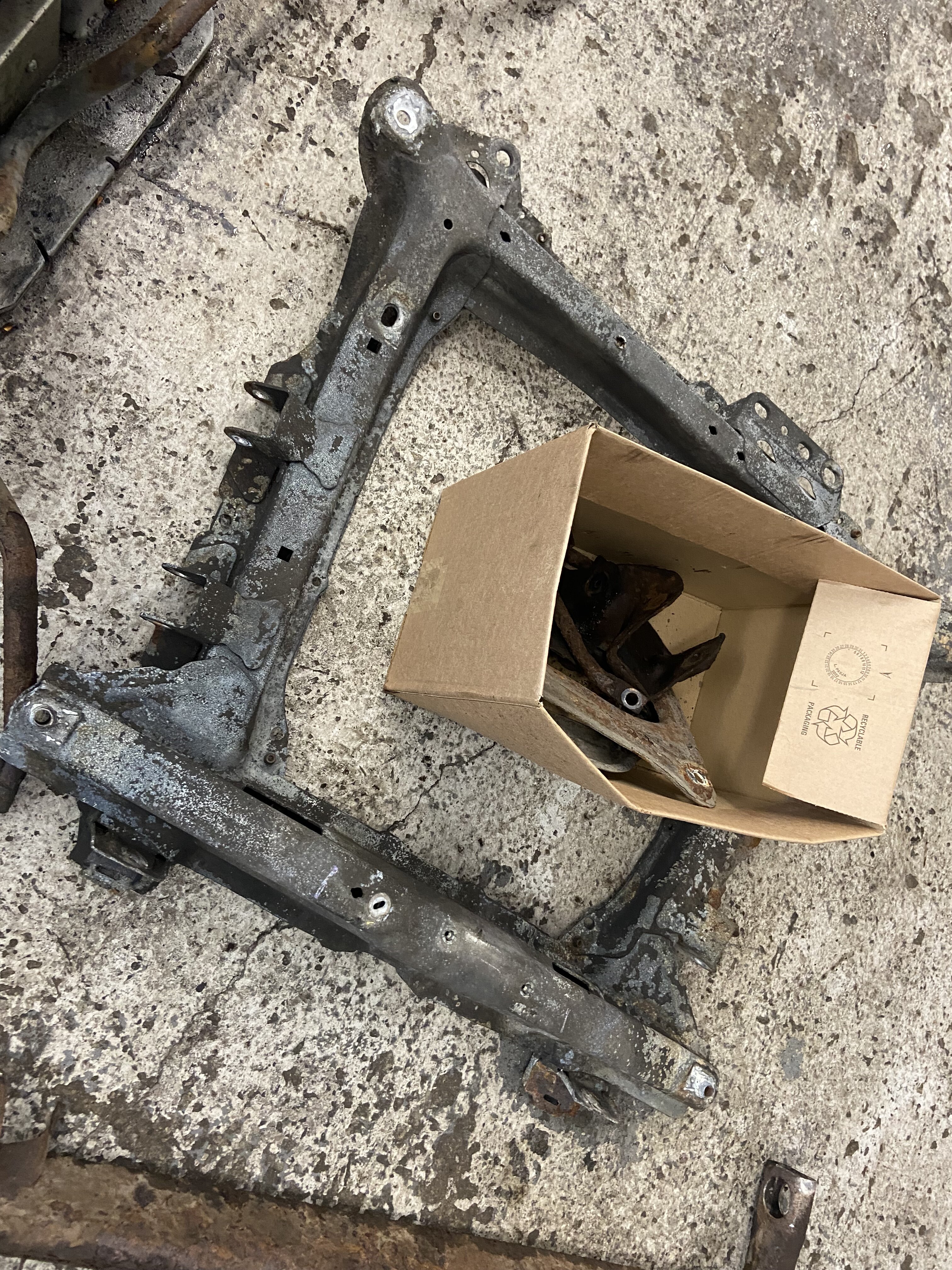

Powder coating bits to take on Monday / Callipers same for a total rebuild and paint.

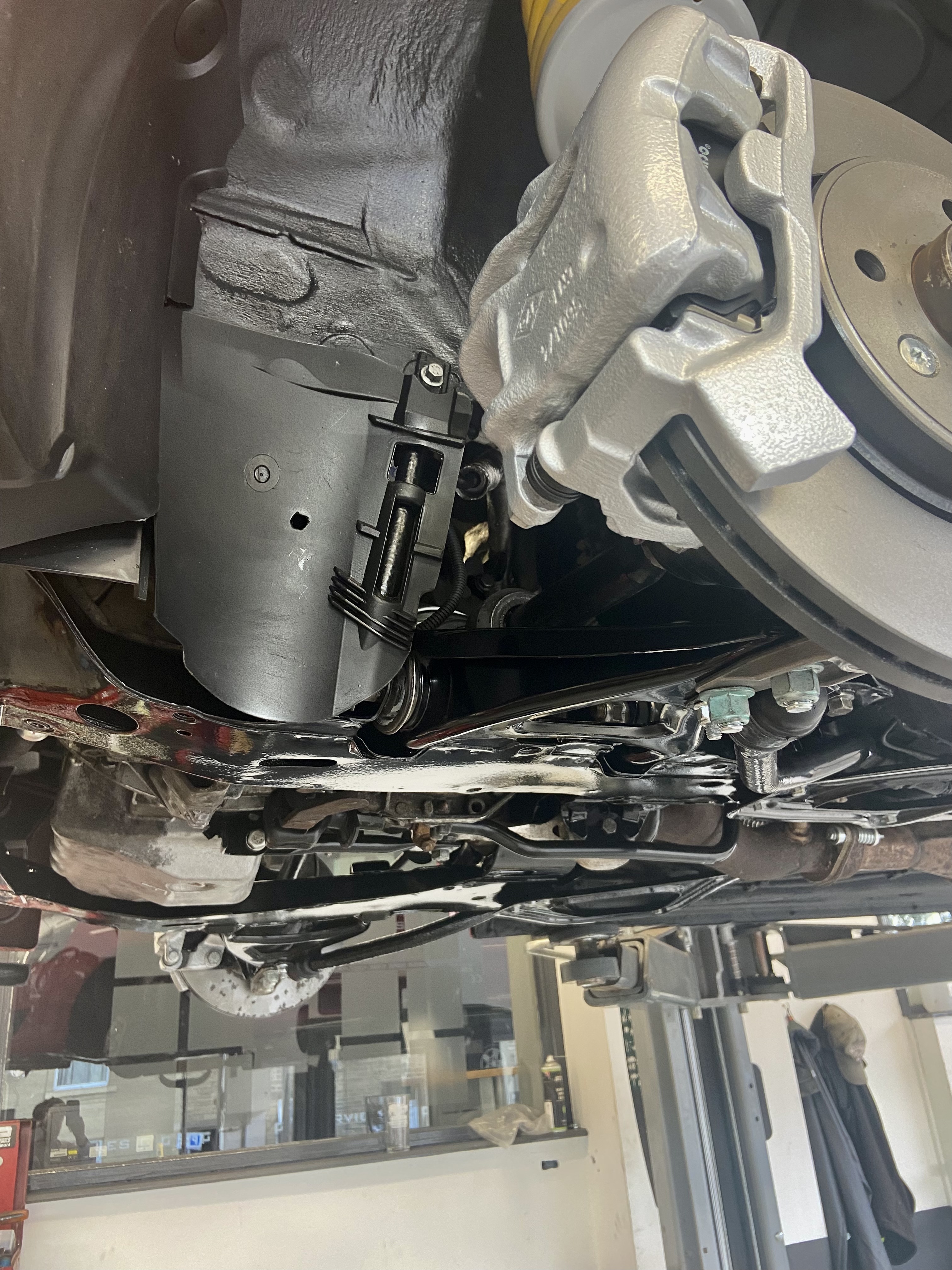

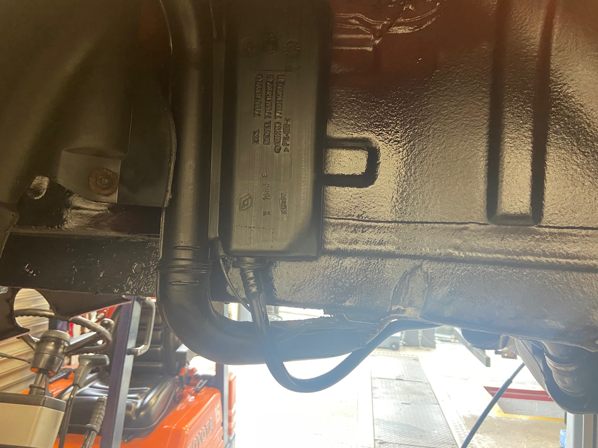

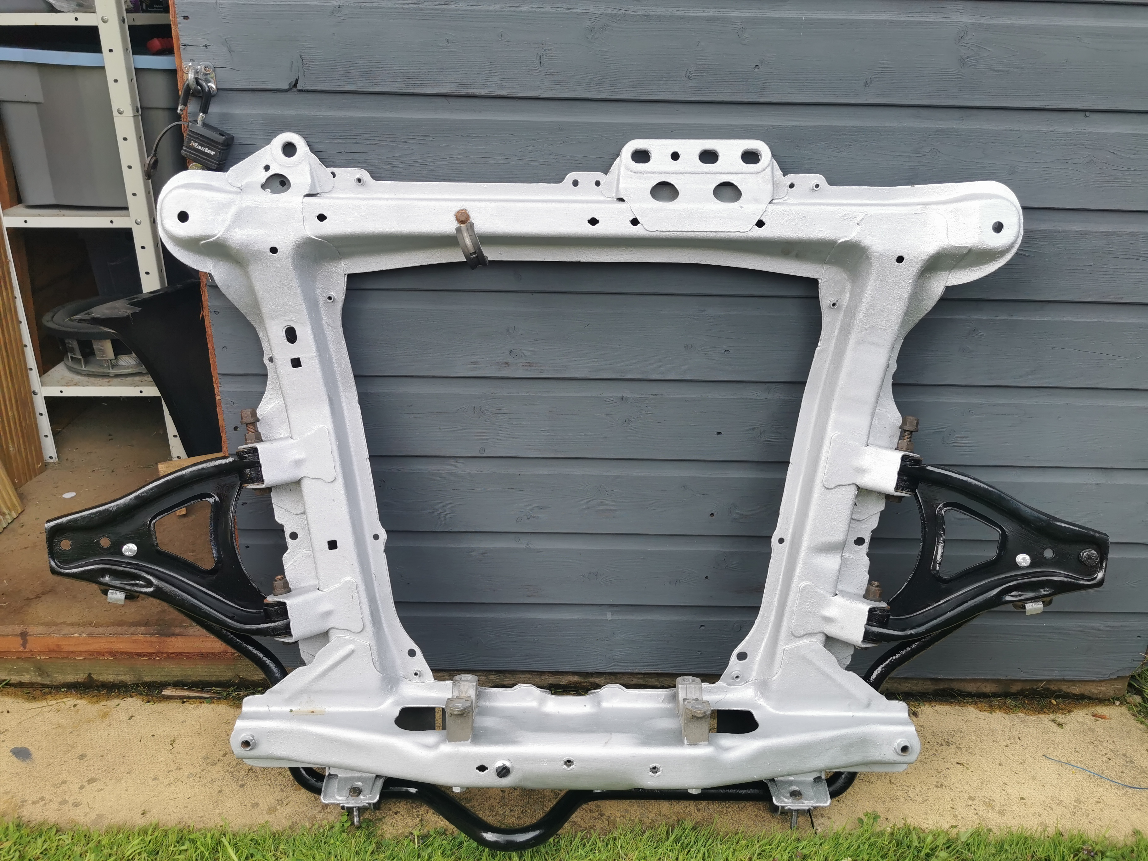

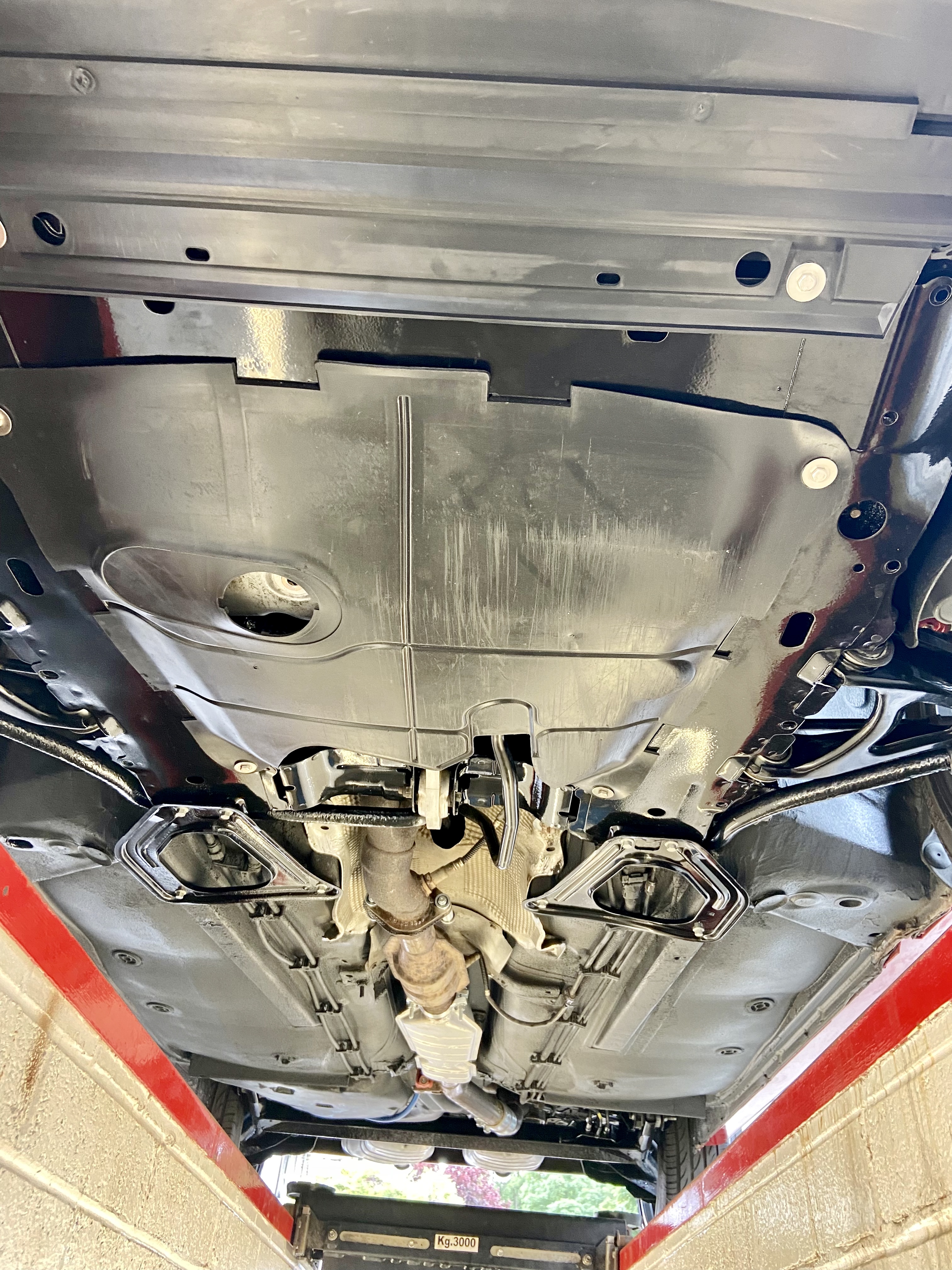

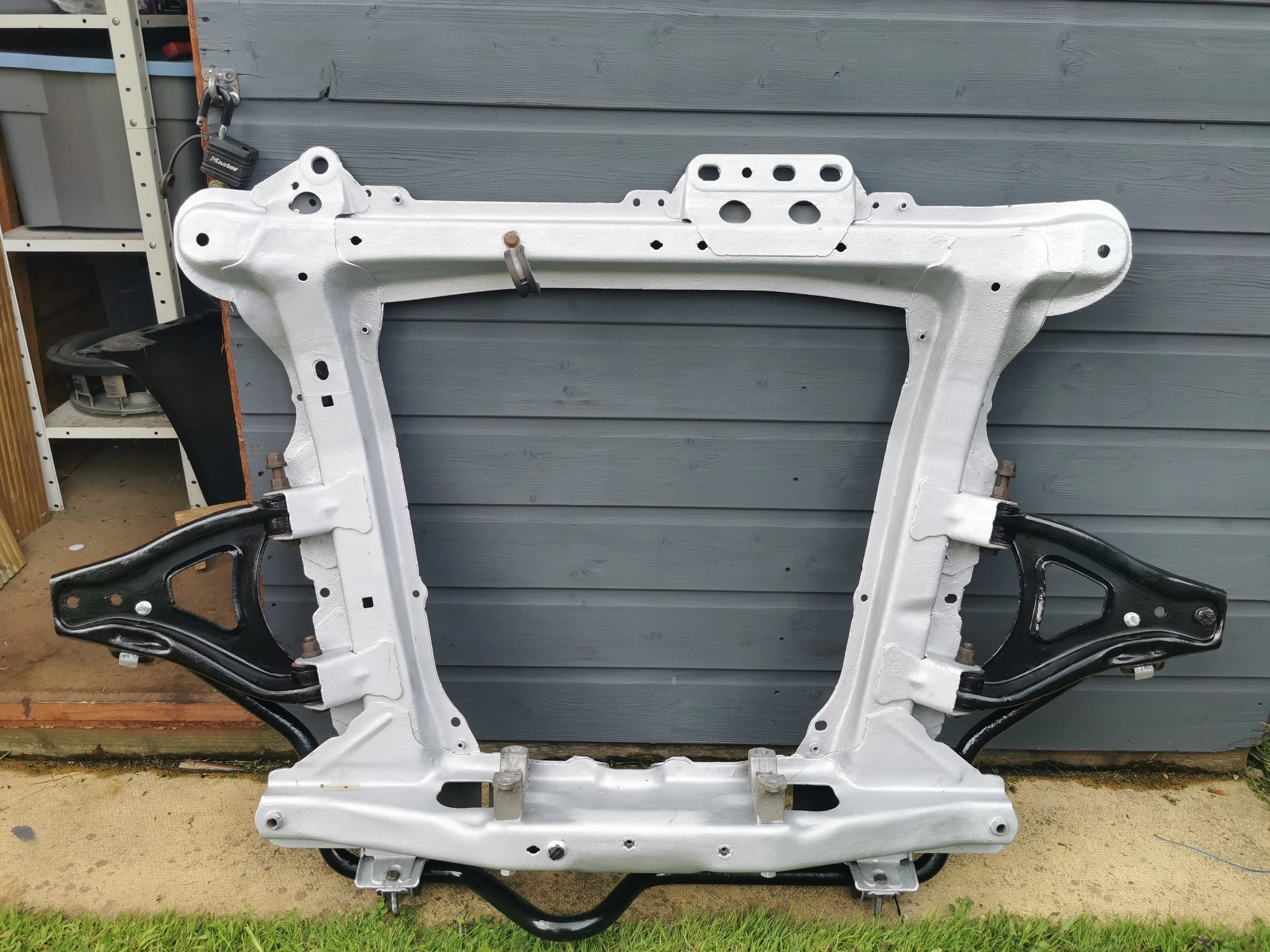

Can someone let me know what colour to do my front subframe - Silver or Black.
Also what colour do I paint the underneath of the car and in the wheel arches and ideas of what to buy.
View attachment 1595038View attachment 1595039View attachment 1595040View attachment 1595041
I'd definitely go black! Any other colour will show up dirt fast and look worse.
@DavidDave recently did all his underside so I'm sure he has some suggestions.

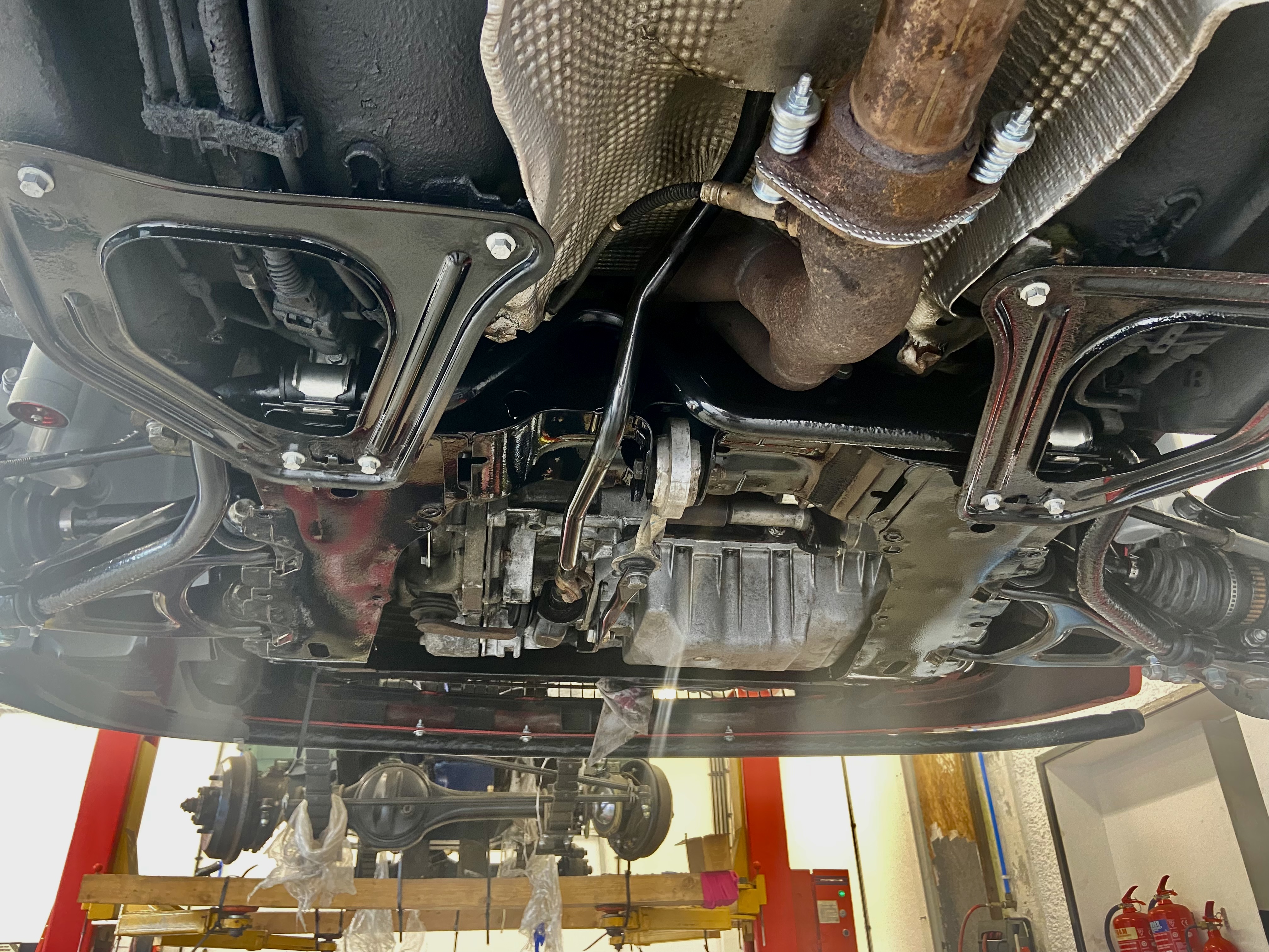

I used pretty much exclusively Bilt hamber products. Key is to remove as much rust from everywhere as possible. It’s a bloody hateful job. Then hydrate80 everything to convert anything that’s left, before hitting it with electrox and then epoxy mastic, I chose black personally. You can then cover with the underseal or topcoat of choice. It’s all detailed in my build thread. It’s now the second clio I have done this to. Wouldn’t want to do it again in a hurry, but you do seem to have a ramp.

Silver ftw😆. Still looked tidy when I was under the car the other week. Or do it trophy pink👍.

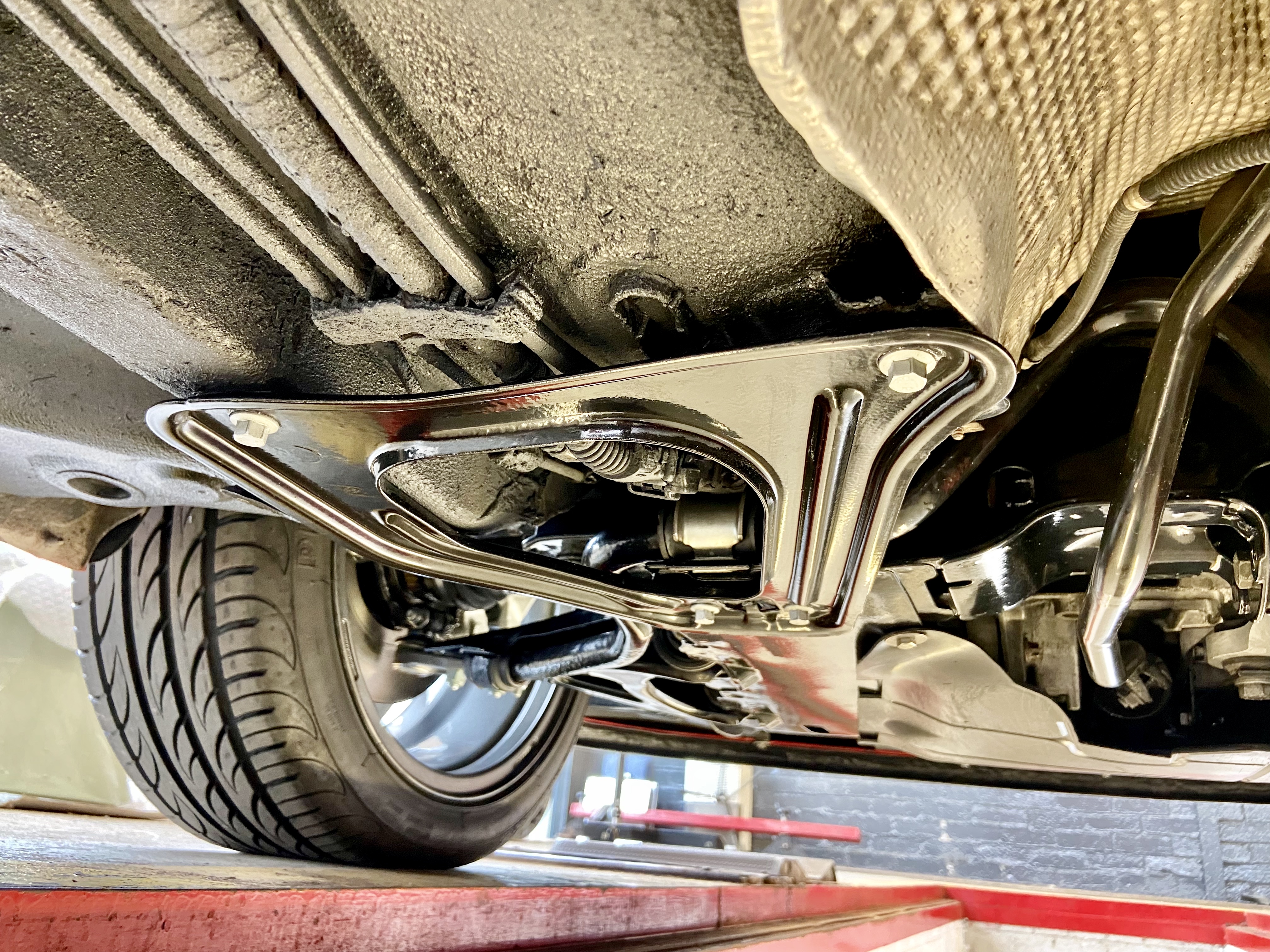

I want what looks standard so Trophy pink is off the menu - yours looks cool all built up - was it powder coated
I had to replace a couple of riv nuts which needed bare metal covering so slapped a bit of hammerite on it, and got carried away. I was shocked at how well it looked after tbh and it won't chip and rust like powder coat will.

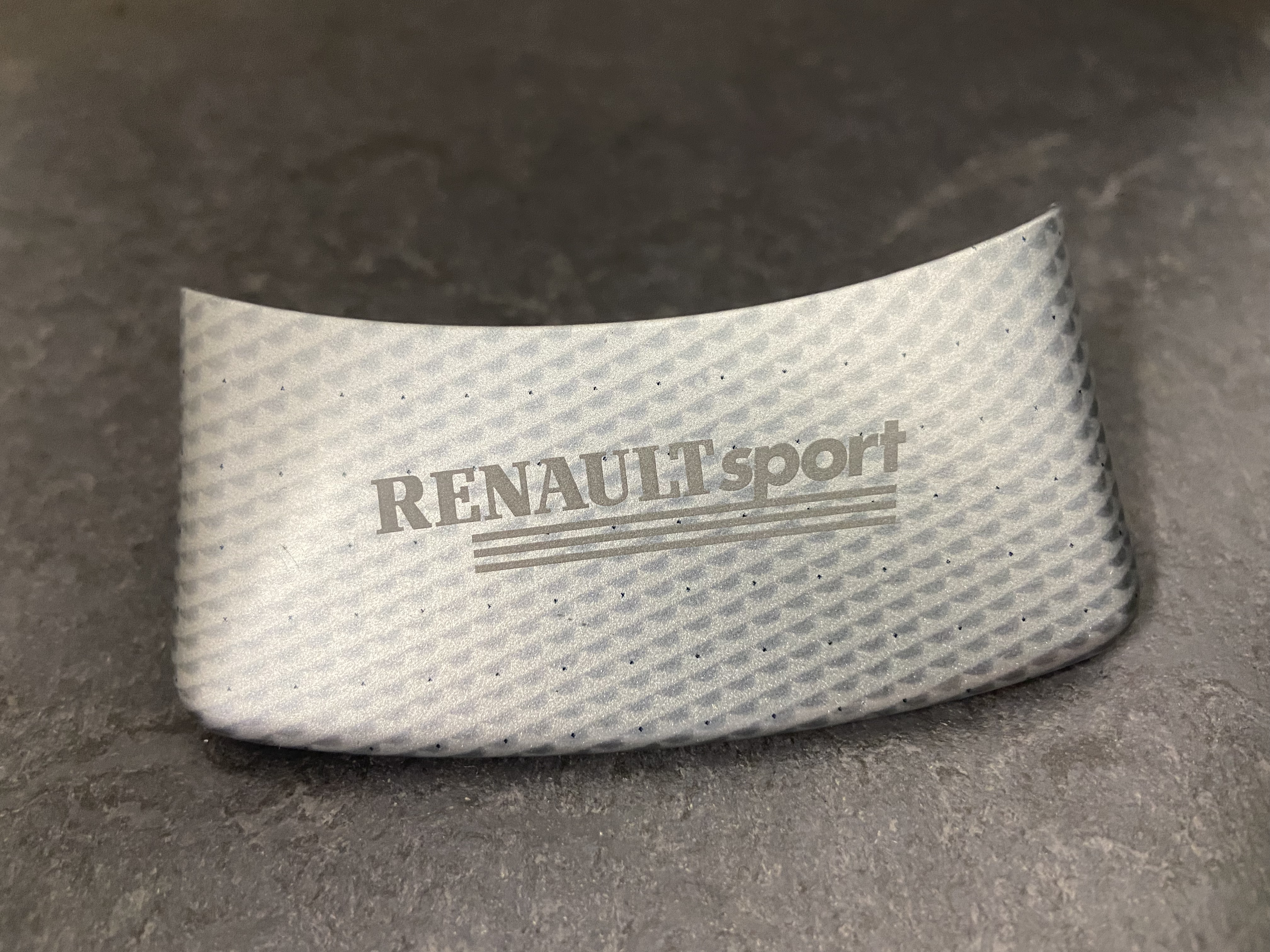

2 x Rear heat shields - if anyone has any for me to buy let me know

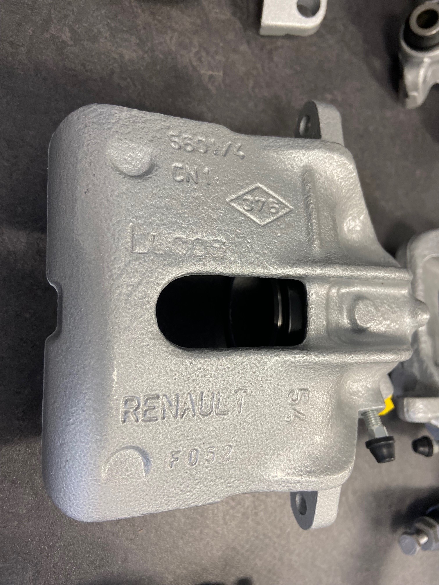

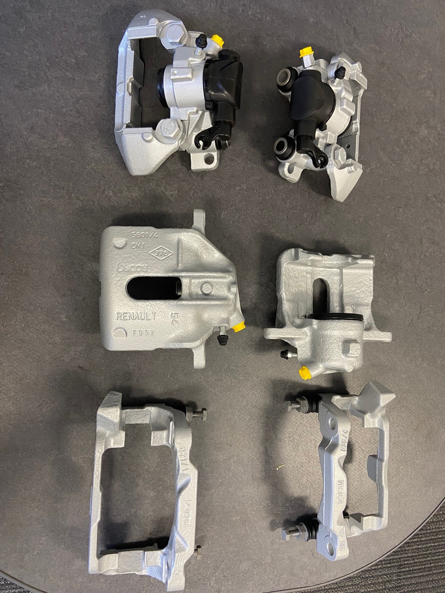

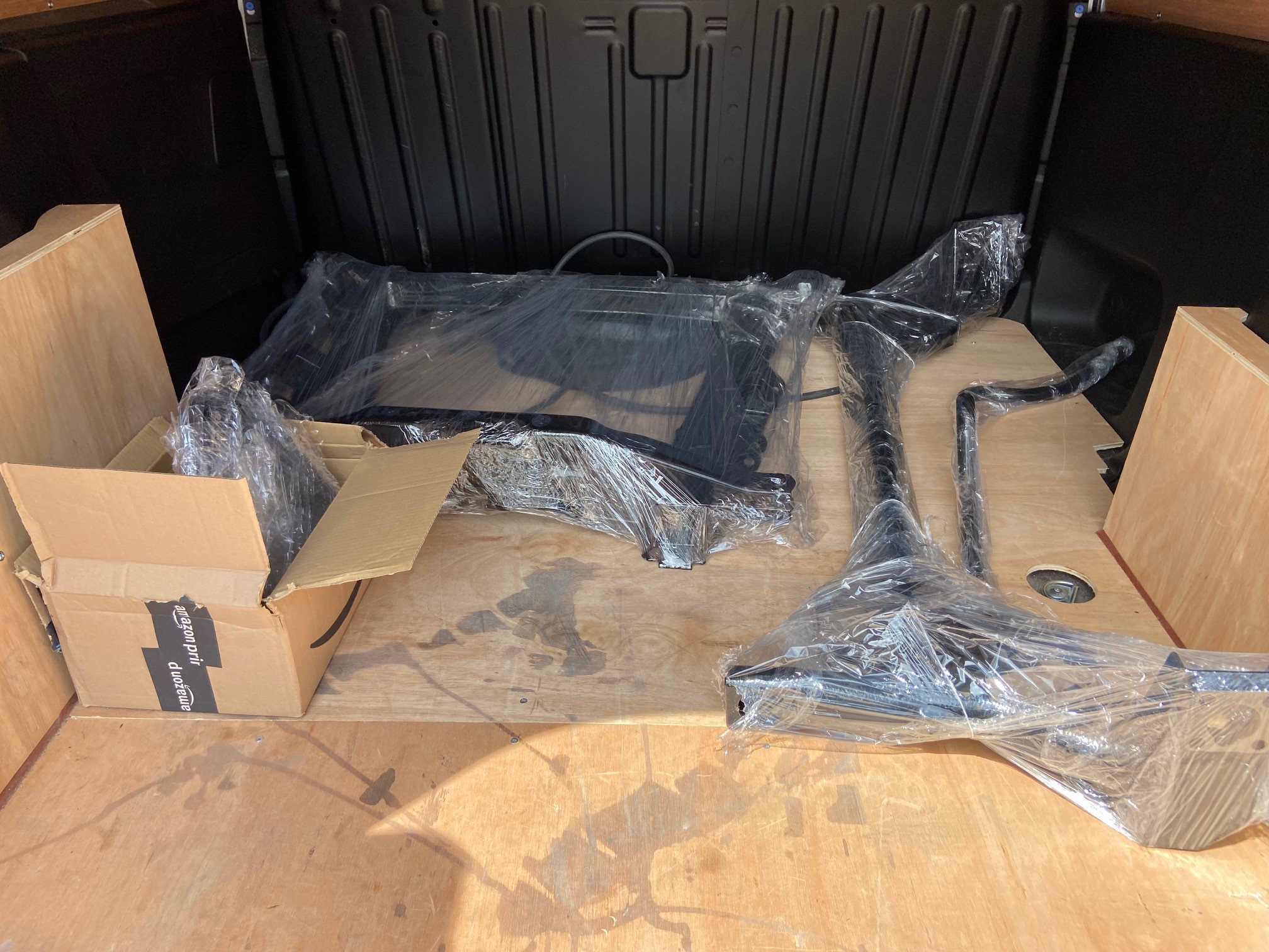

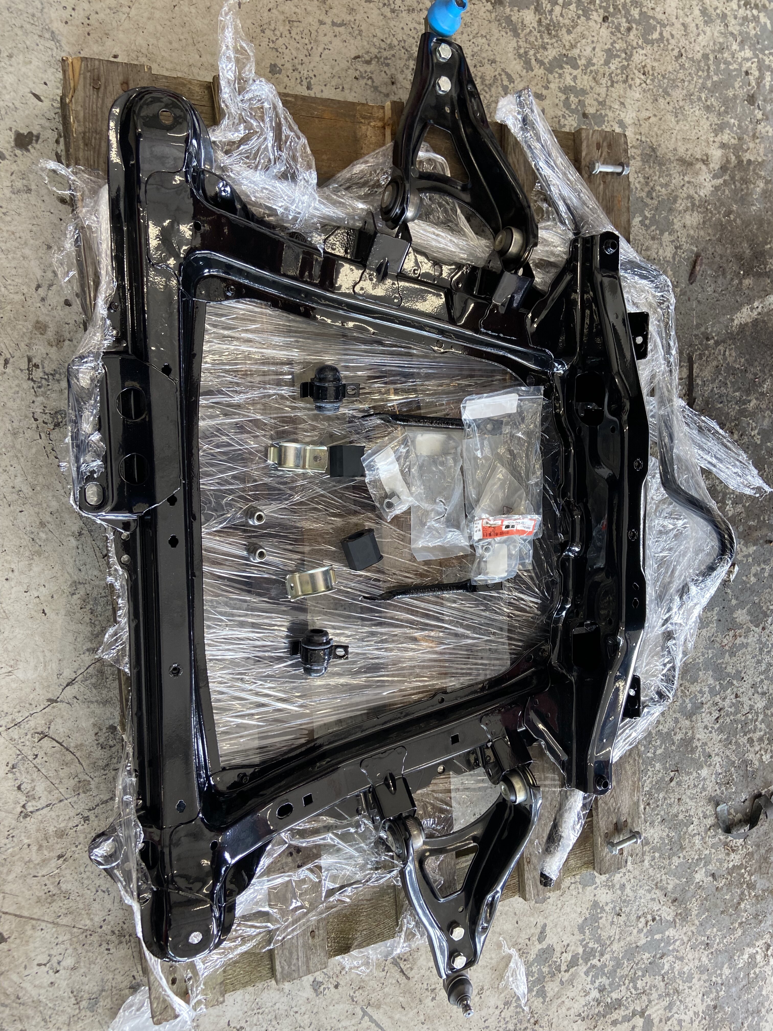

Thought I'd take the advantage of collecting my powder coating and brake calliper's today in an electric van having spent so much on No63 - every little saving helps HaHa.
Not quite like glass but very happy with the results

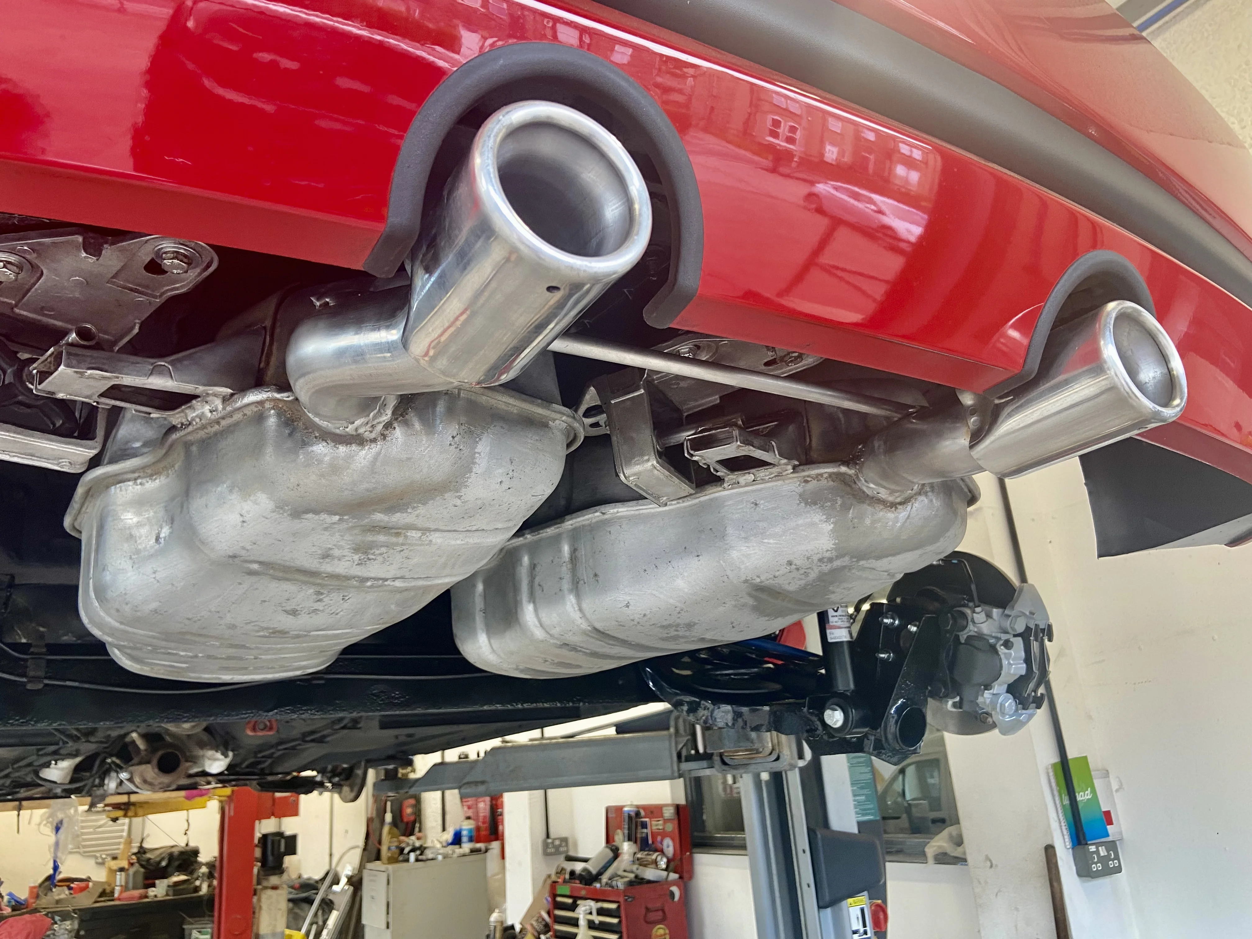

Also this is as good as I can get my exhaust without painting it - hopefully it will be ready for CSF22.

Callipers have been done by SSL Autoparts in Wakefield
Powder coating was done by Pegasus in Milnsbrige Huddersfield
Exhaust was me and took a whole week - my office now looks a right s**t tip with splash marks all over the walls.
Subframe now to build up and put back on early next week -but I’m just waiting for a new radiator to turn up.

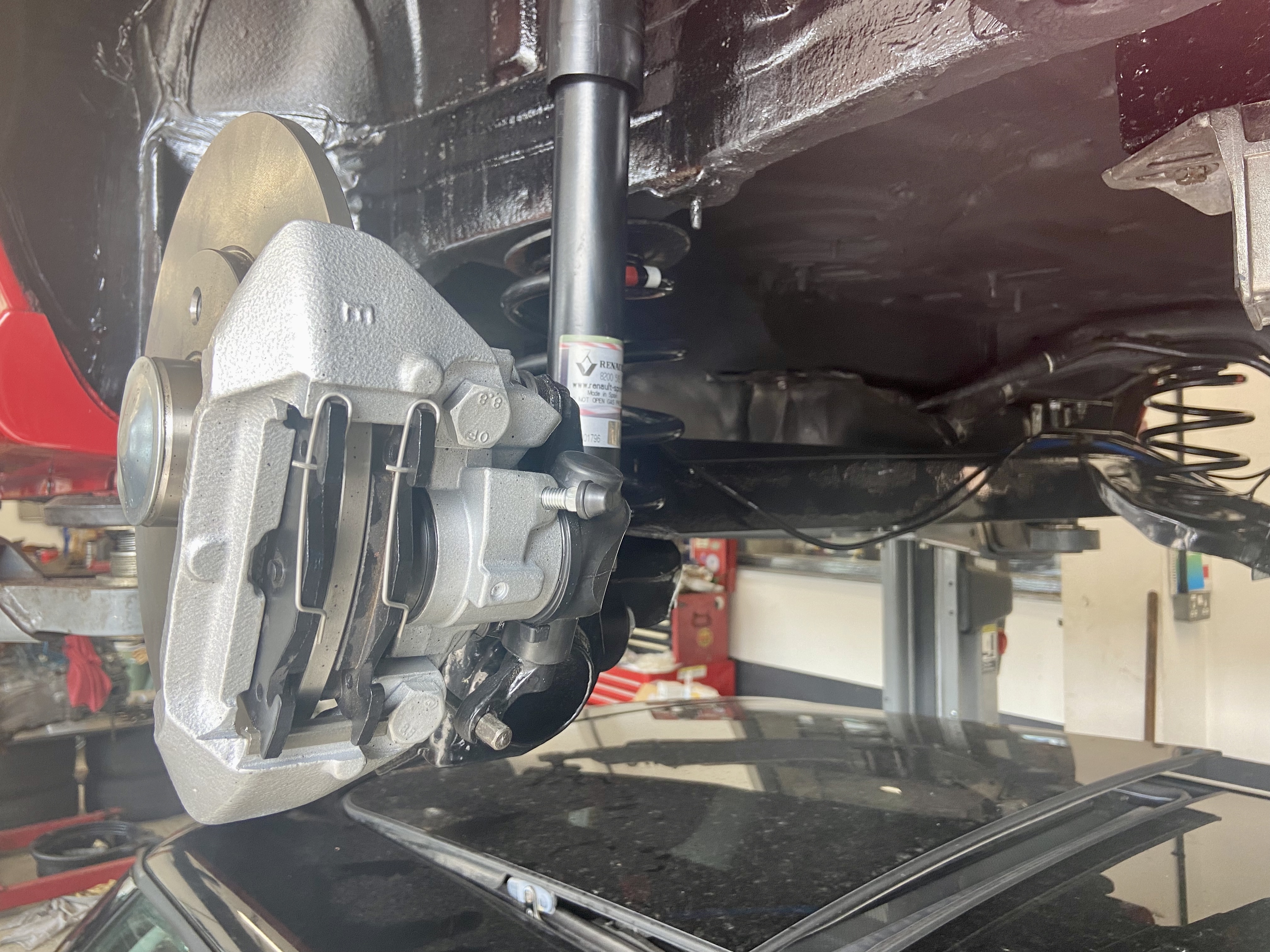

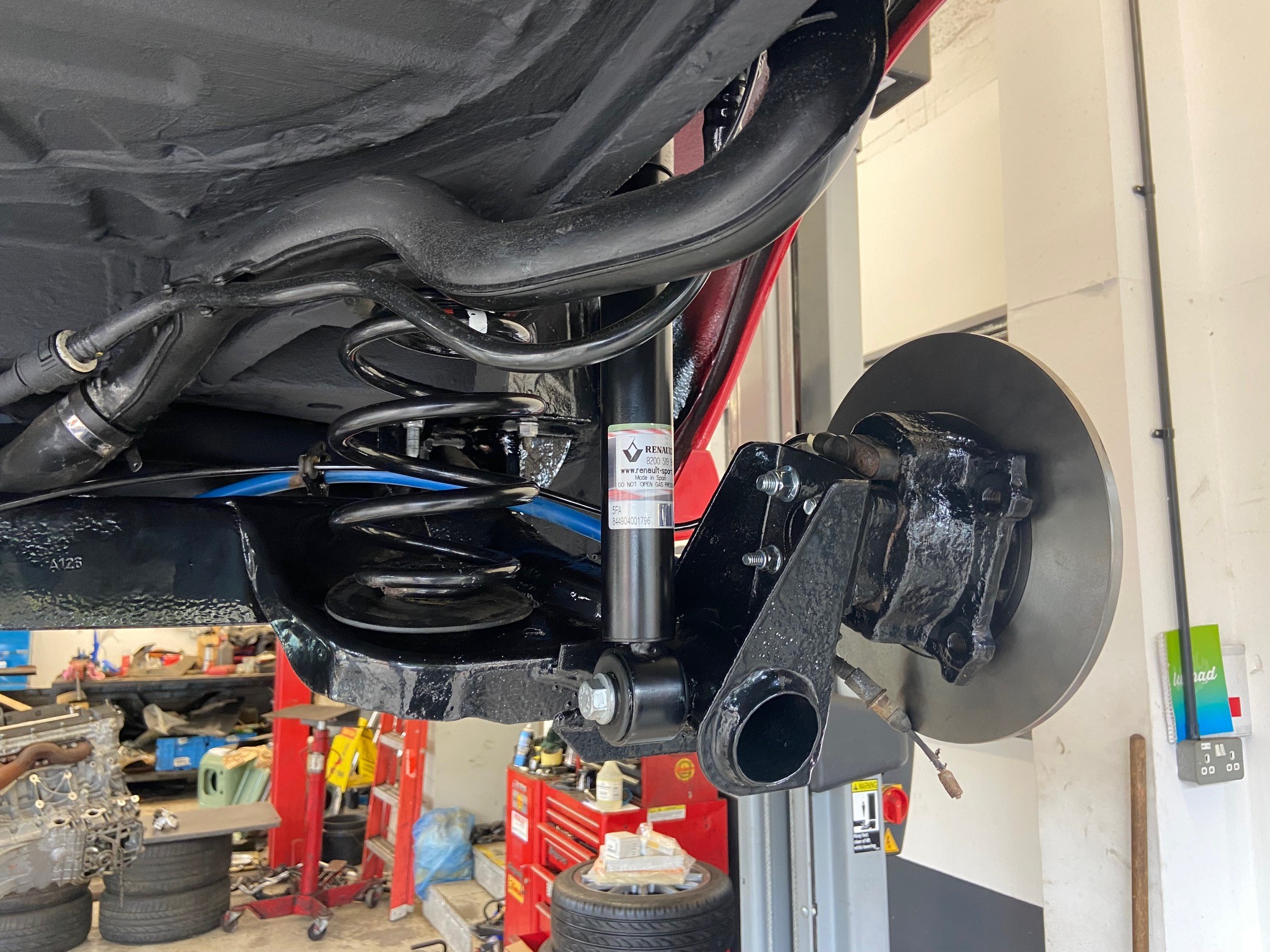

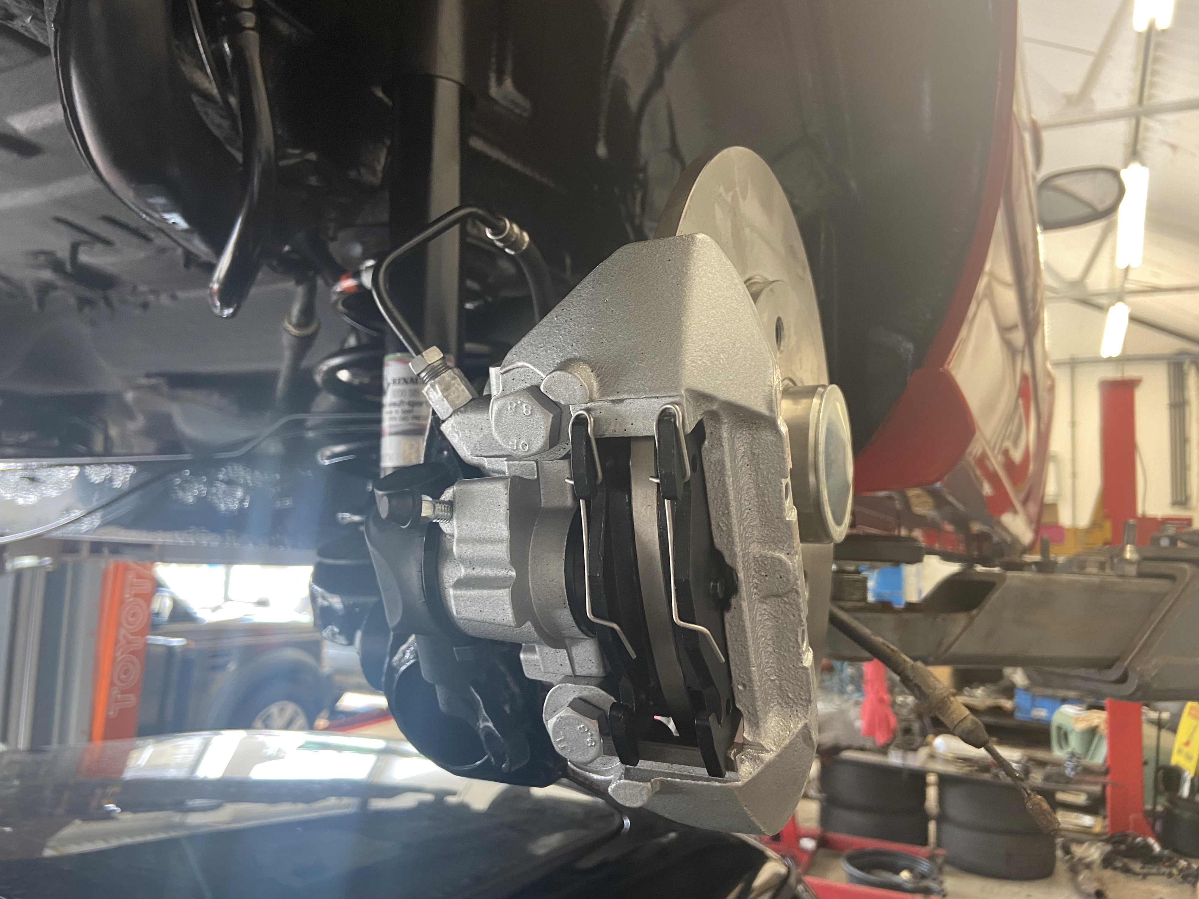

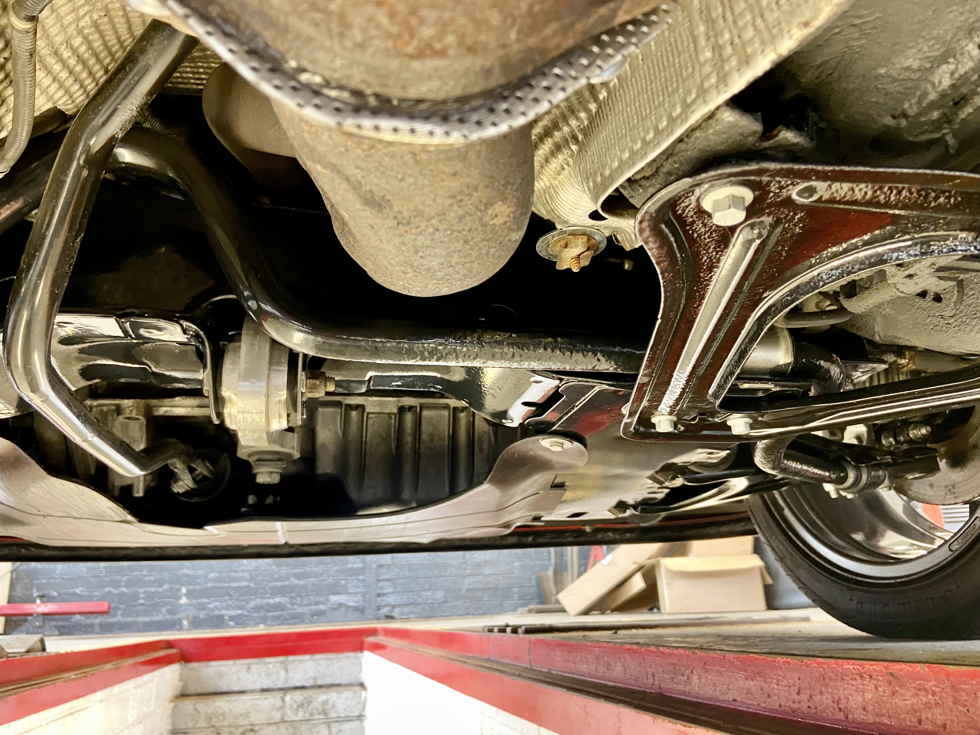

The sub-frame is now built up and just waiting for the new radiator to be fitted - also one of the new rear brake pipes needs to be fitted

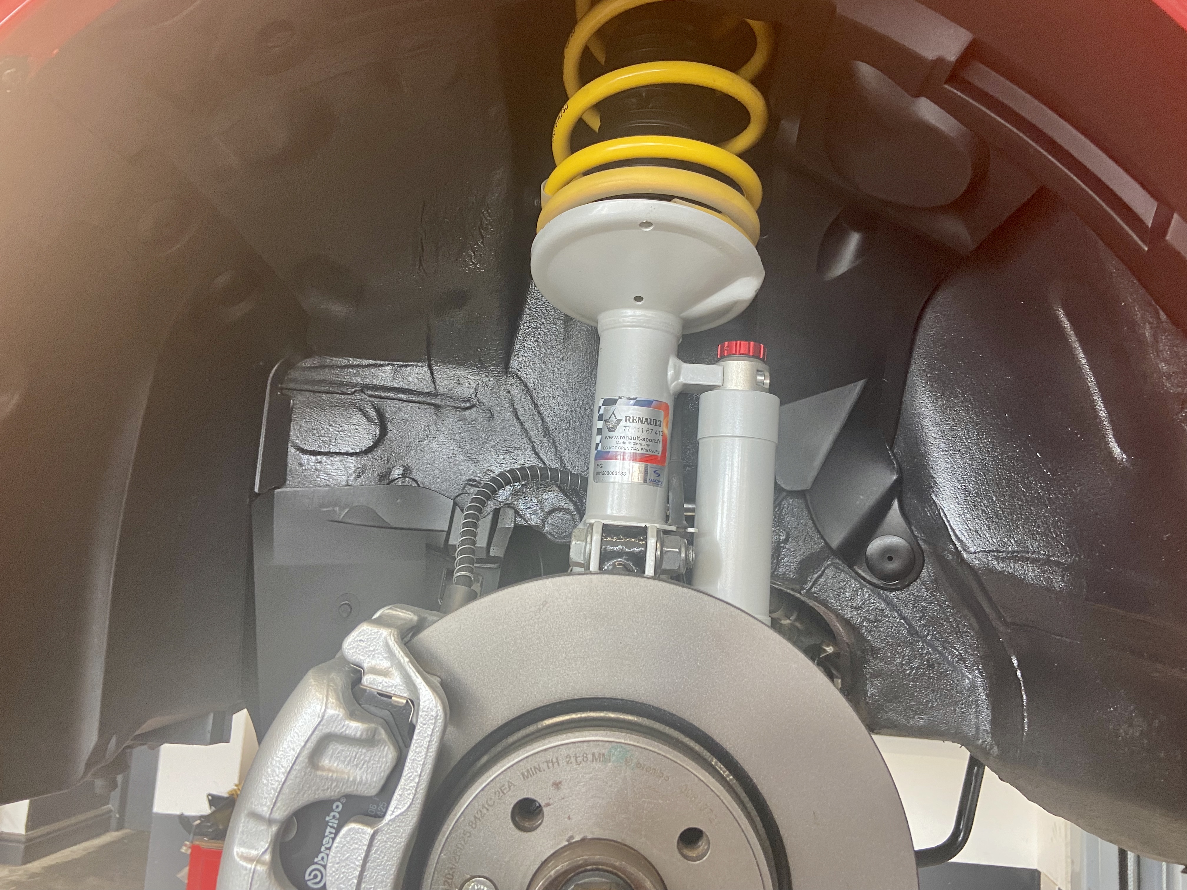

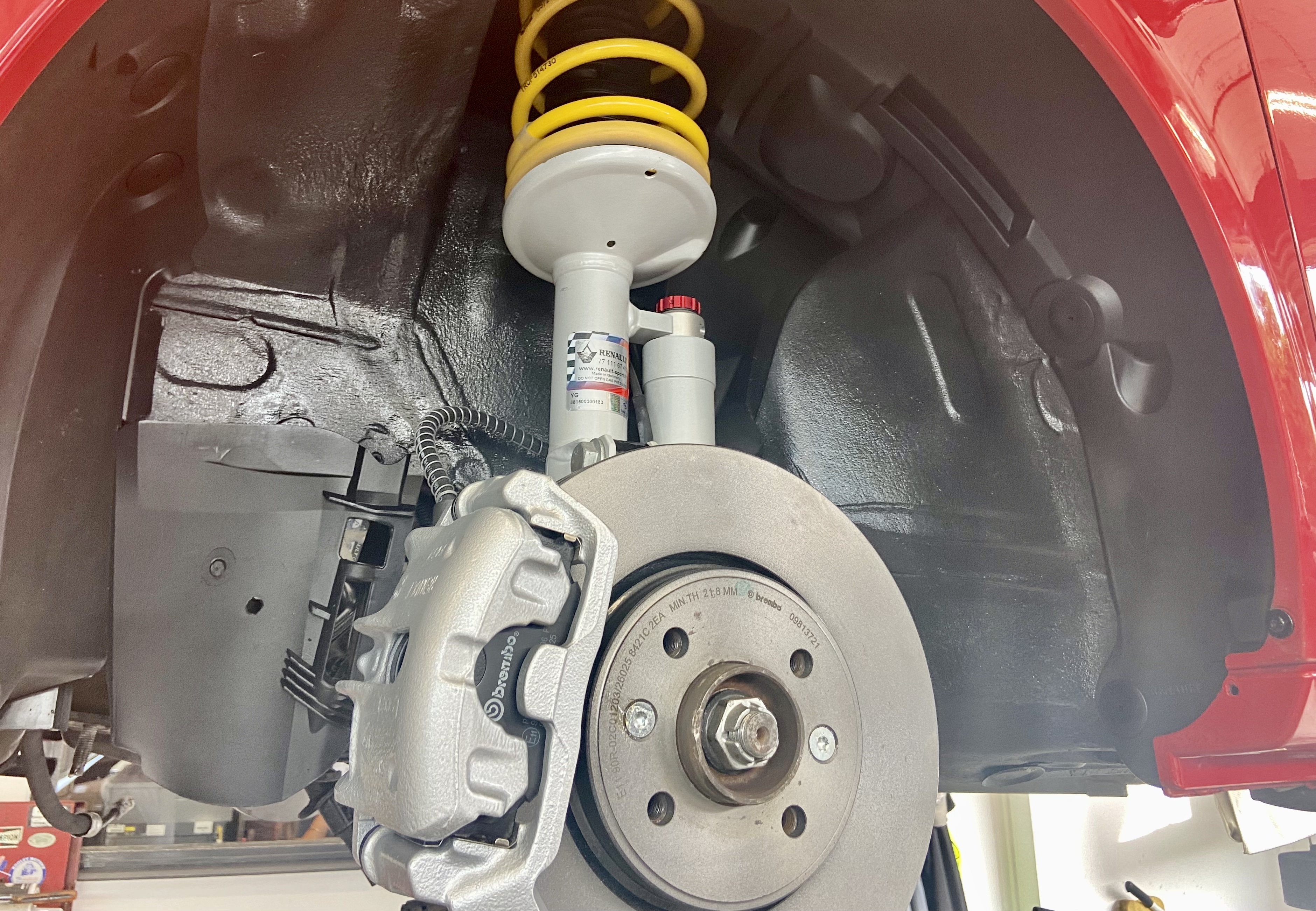

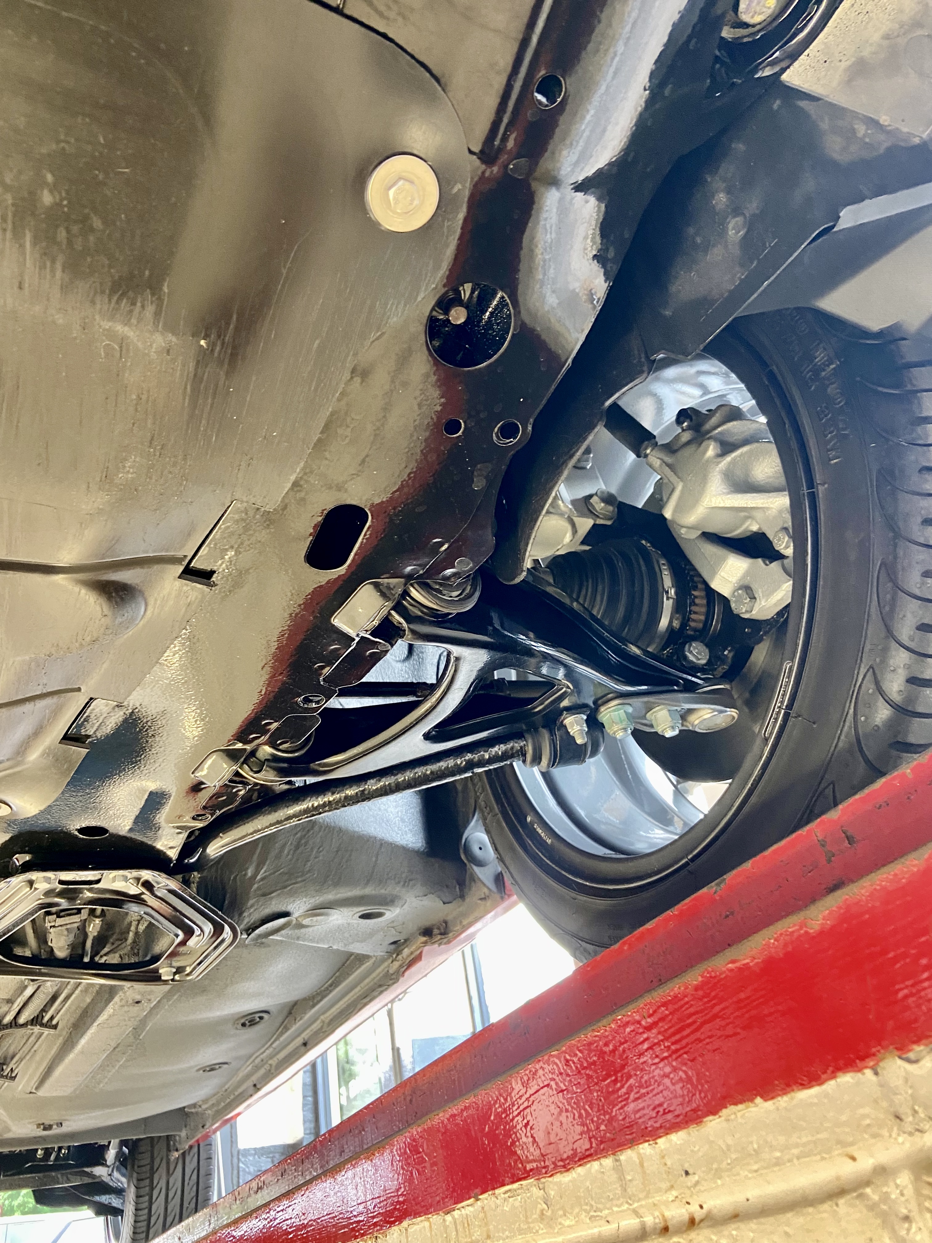

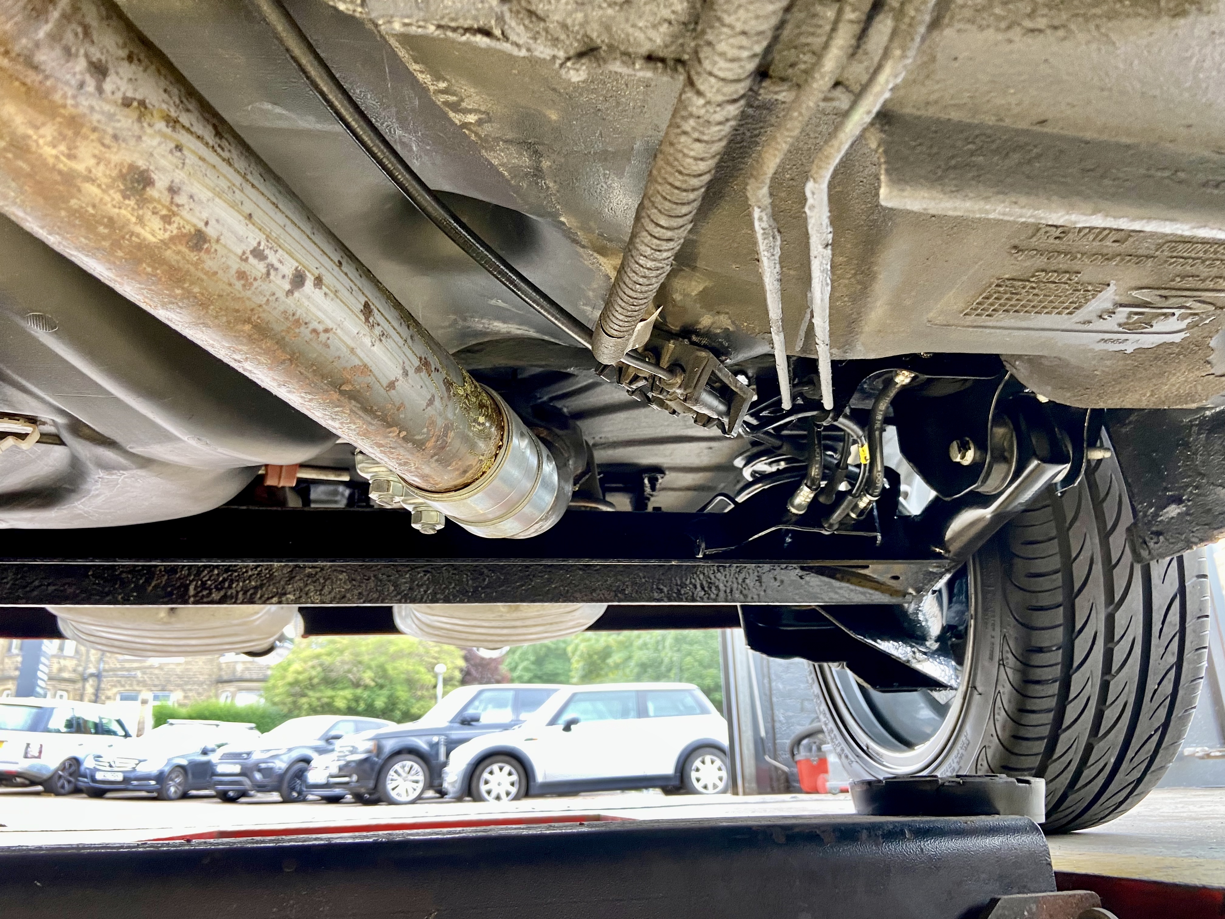

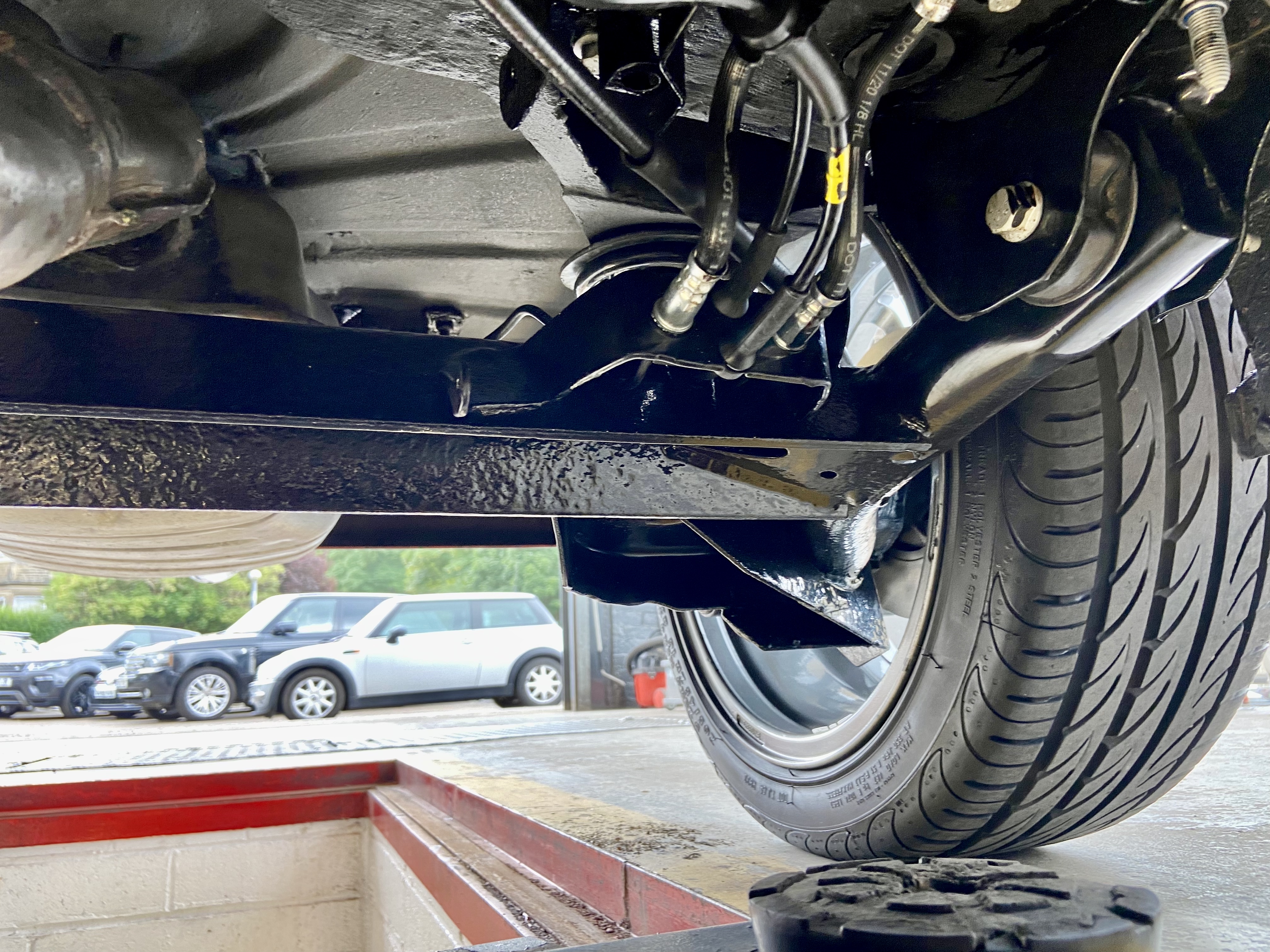

Thoughts on the wheel arch colour/protector please - I think it looks good
but I'm open to criticism

If anyone can help I need the last two pieces of the Jigsaw for No63 to make it a complete original car
I need the rear and centre Exhaust Heat shields - Or ideas how to make them or who makes them.

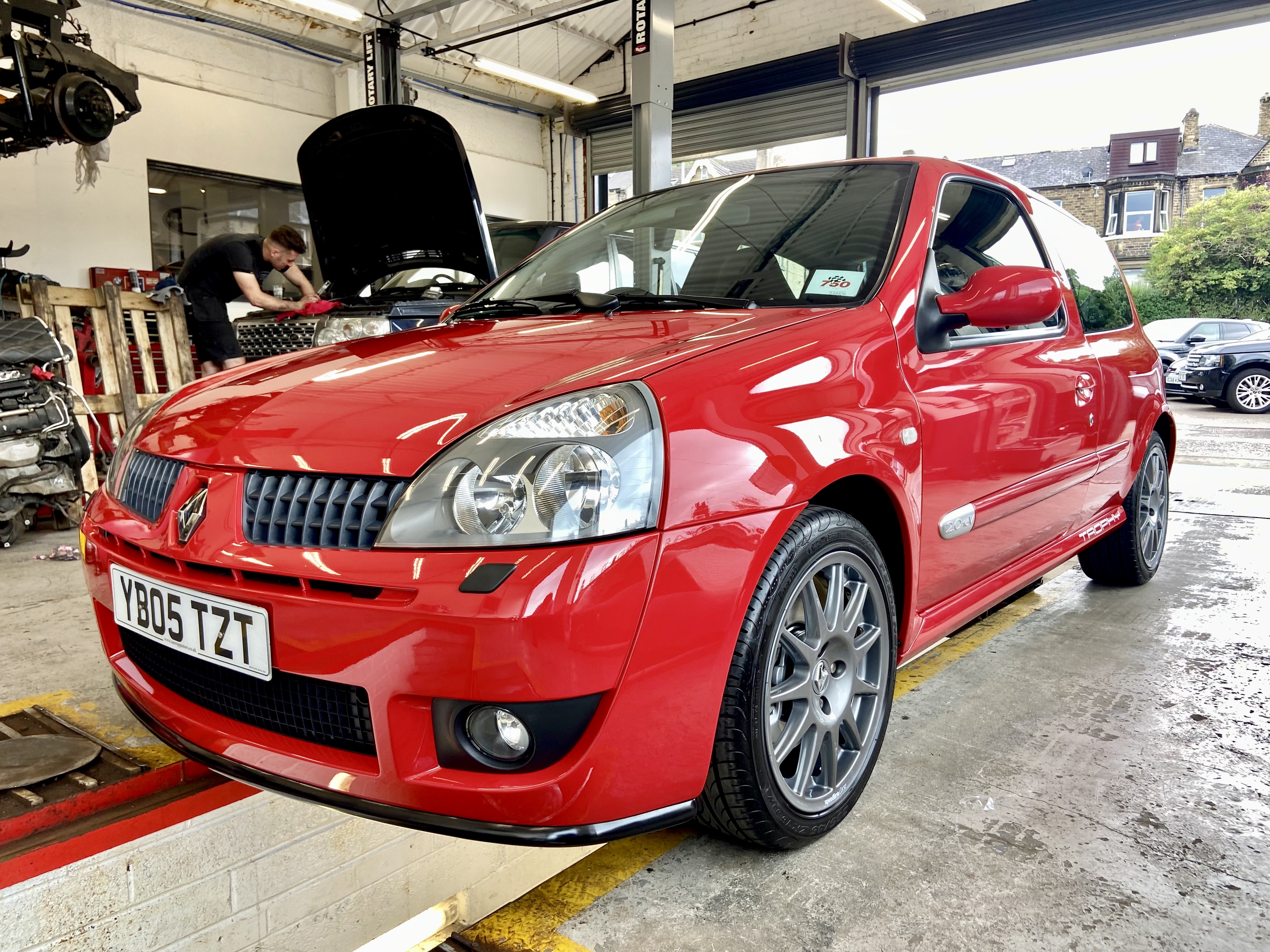

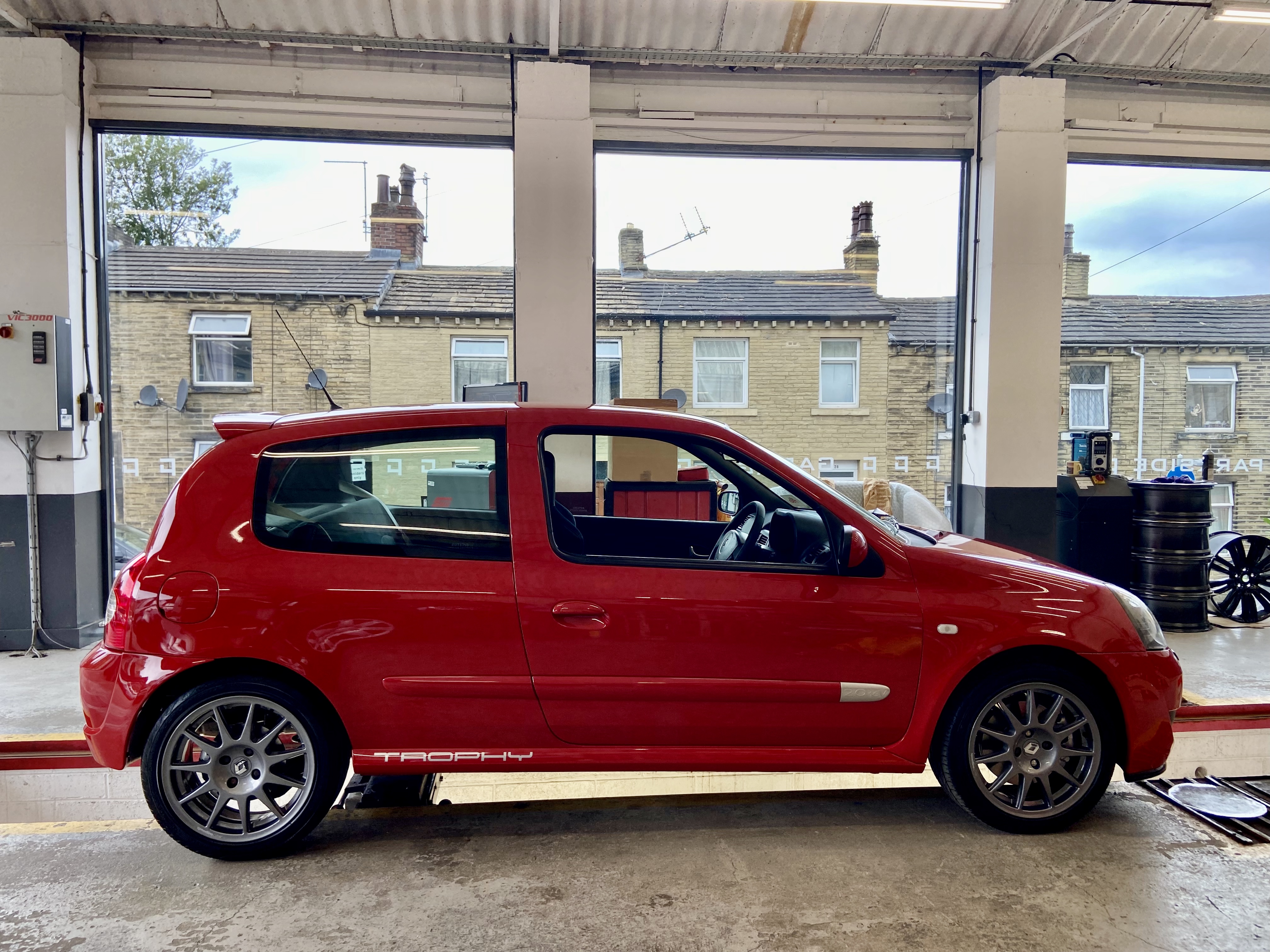

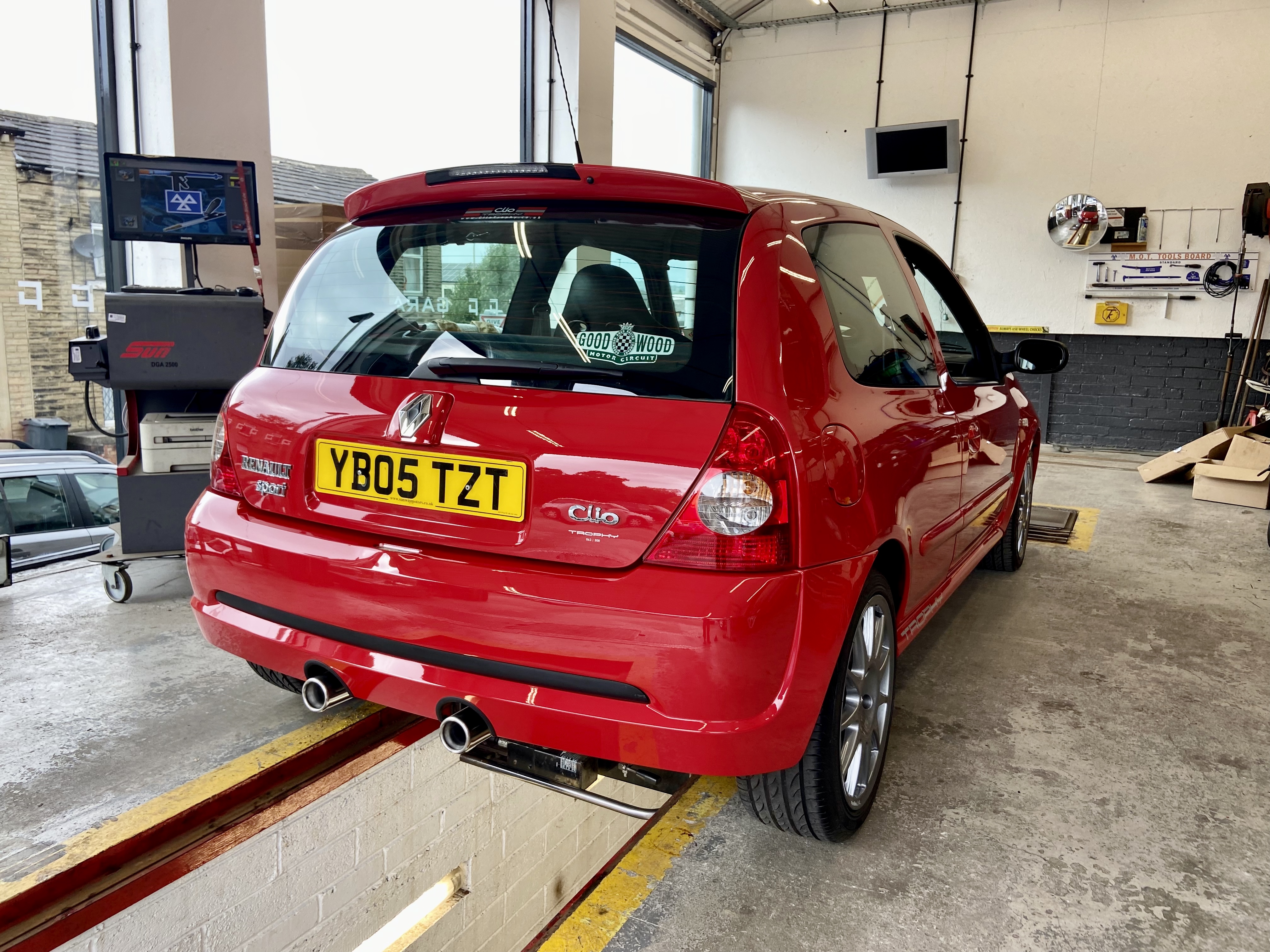

Last posts from me regarding No63 - it’s finished really - just the inside of the bonnet painting and a buff. ( maybe just one then when it’s totally done)
It’s now parked in my garage for the first time having just brought it home - it really does drives like new - Even Sam and Mick from parkside garage who have done the work said it to me when I got there this afternoon, they where both very impressed having both gone out for a spin.
MOT’d today with a clean pass - wouldn’t think anything else having had everything new fitted.

Looks absolutely mega! When can i come see this?!
