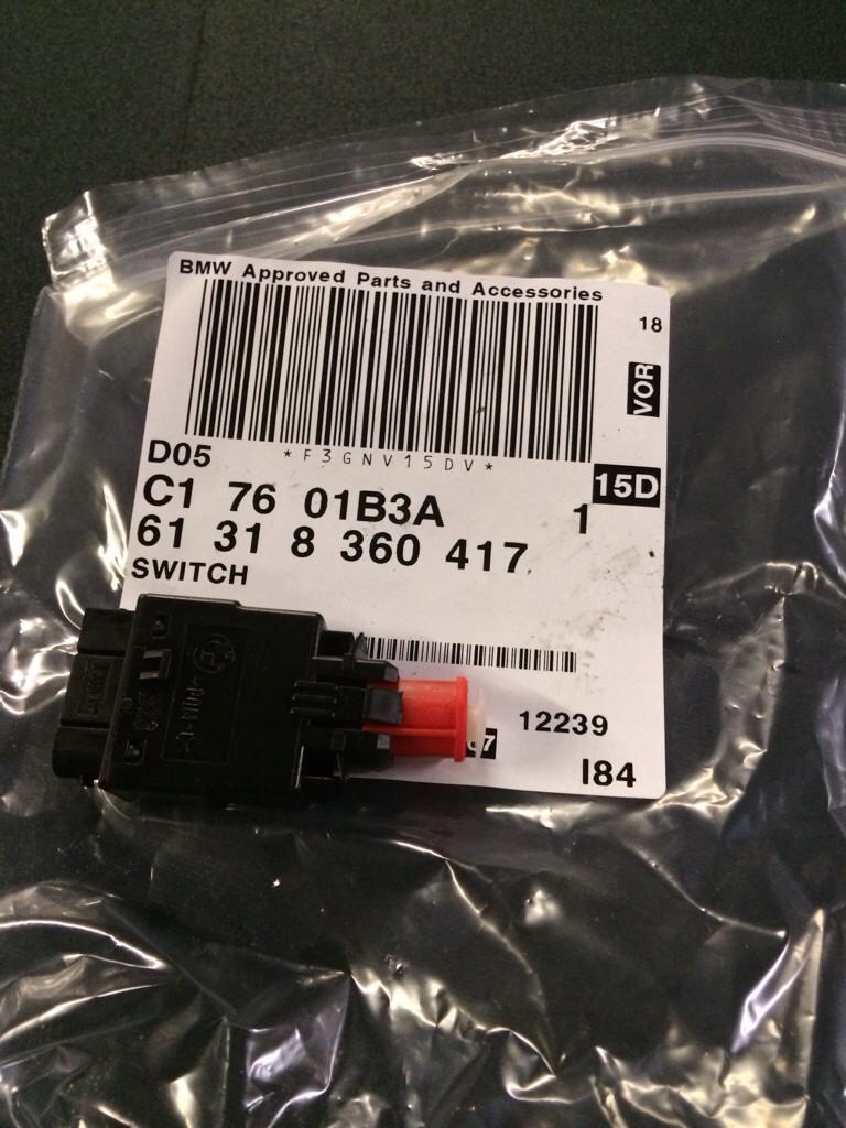

Next up was a "Brake Circuit Fault" on the centre console, after checking the bulbs and finding them to be fine off I went to Google, found out the Brake Light Switches are a common fault, so got one on order for tomorrow!

I fit the new brake light switch earlier and it sorted it for about 5 minutes.. Fault is still there so now il have to strip down the rear lights and check for cracks in the metal citcuits... Either that or its a faulty switch..

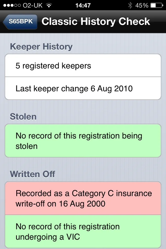

Also found this...
We didnt hpi it, due to the price we got it for, but im suprised haha..
Tunst
  Focus ST225, Focus E
Not sure, cant see any evidence of previous damage tbh.. Drives great etc...

Must have been a fair bit of damage to write off a 2 year old M3 though!

Quite like these, the green suits it.
Yeah thats my thinking! Its been repaired well because i cant see any evidence of damage anywhere..

Cat C could've been stolen and recovered with bits stripped of it at 2years old.

Probably find like quite a lot of cars at the time it was written off on finance. Was very easy to get quids in back then with insurance fraud. My mates 200SX was written off less than a year old, and you'd never of known otherwise. Car was immaculate.

New Brake Light Switch
That cured the 'brake light fault' on the centre console..

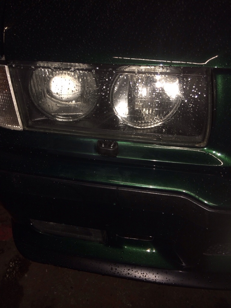

Then another thing that annoyed me was a headlight washer was missing... So got onto BMW and £54 later I had a new one...
