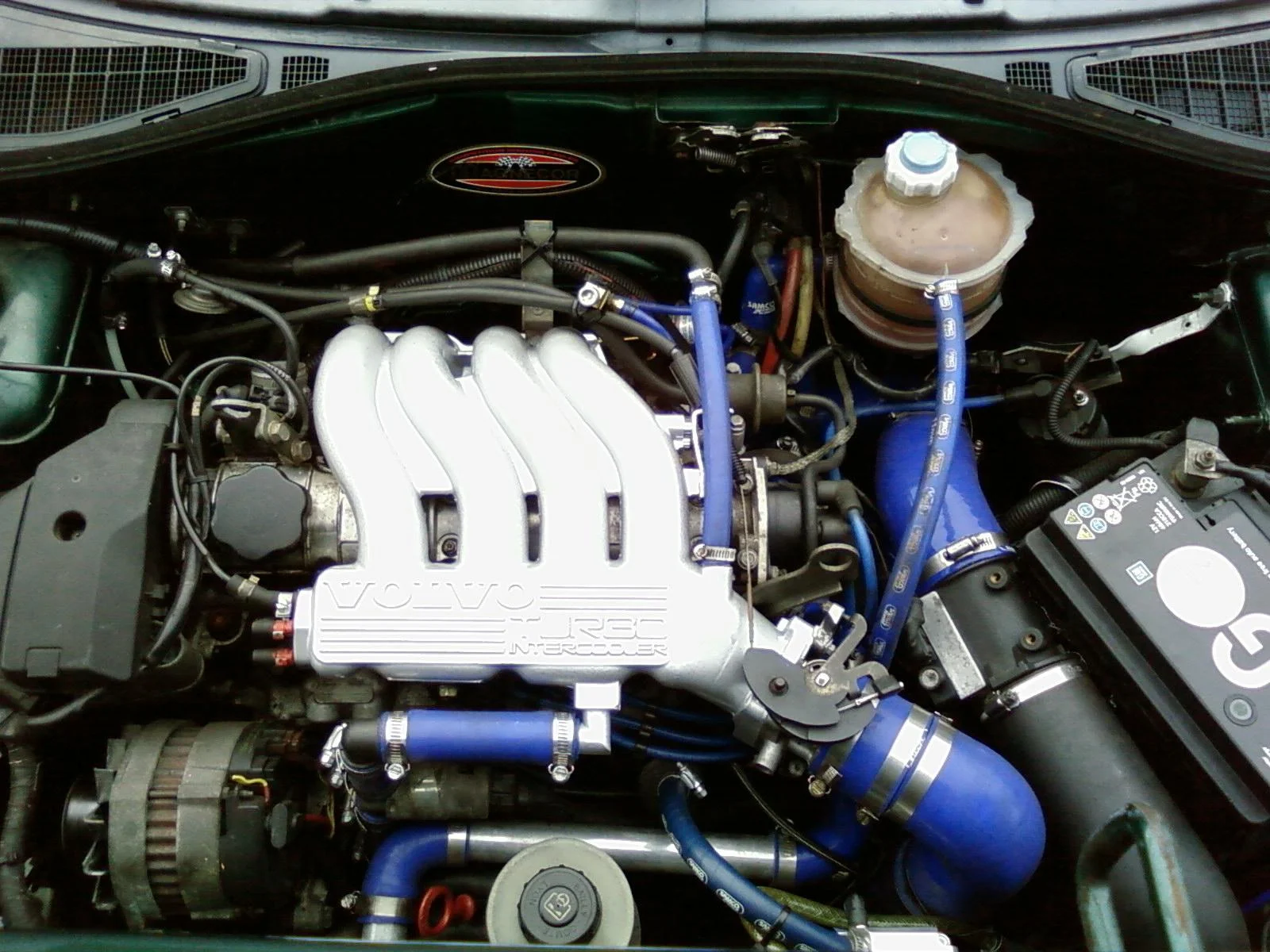

the rsi is a good strong engine but would cost alot to put a turbo on it your best bet is to do this it would be cheaper. you can get a doner car of ebay for cheap 440t/460t/480t

how much trouble is the conversion mate? what box did u use? are the engine mounts a straight swap? anything you think i need 2 know if i wanted 2 go down this route?

Its pretty much a clio engine with a Volvo badge on it matey..
all the mounts are in the same place, just the same as an RSi block apart from the turd blower and different manifolds IIRC

didant think it was to bad, i used the rsi gearbox and the engine mounts and altinater bracket have to be swaped over and if you are going to do this conversion dont bother with any of the standard hoses make your own and pay attention when it comes to the wiring, can fry your head!

what is wrong with the turbo's on them there good for 200bhp and there is no turbo lag from a t2

Nothing is wrong with the standard turbo.. i was comparing the RSi engine to the volvo one, stating that there essentially the same apart from the turbo and manifolds

all engines are good if you look after them and yes you can uprate the turbo for a t25/t28

it would fit but you would have to make engine mounts for it i thort about it but seemed to be alot of chew

Never had any dealings with this personally but it would seem the volvo engine is the way forward when it comes to renaults. I've seen them in 5's and here in this MK2 PH1.
The wiring would put me off though. I imagine you will need a Haynes manual for both cars so you know what wire does what.

correct that is what i did

It looks like actually quite a big job! Im gonna give it a pass for now and just stick with a manifold and exhaust, ill be happy with that i think for year or so then when ive got enough money saved up ill get the volvo engine sorted. RichRSi...your car looks lush! One last question which might make me change my mind about doing the Volvo engine sooner...How many BHP can i get from this Volvo engine if i uprate the turbo to the big T34 i think was said (which ever the biggest one is)? Thanks for all the help ive had though, has saved be a bundle!

with a t28 and .60 exhaust side the most powerful one to date has just over 250bhp but have not been tuning this engine for long so still finding out what works
