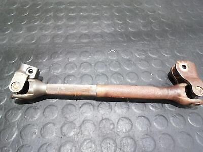

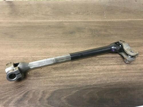

Column joint is to replace to a completely solid version. From electric columns, twingos and some dacias.
That one looks a little dirty but only one I could find on a quick search, I think there is a part number for it but I won’t be at my computer till tomorrow to find it.
Still for sale...
@Dutchie Found a cleaner one

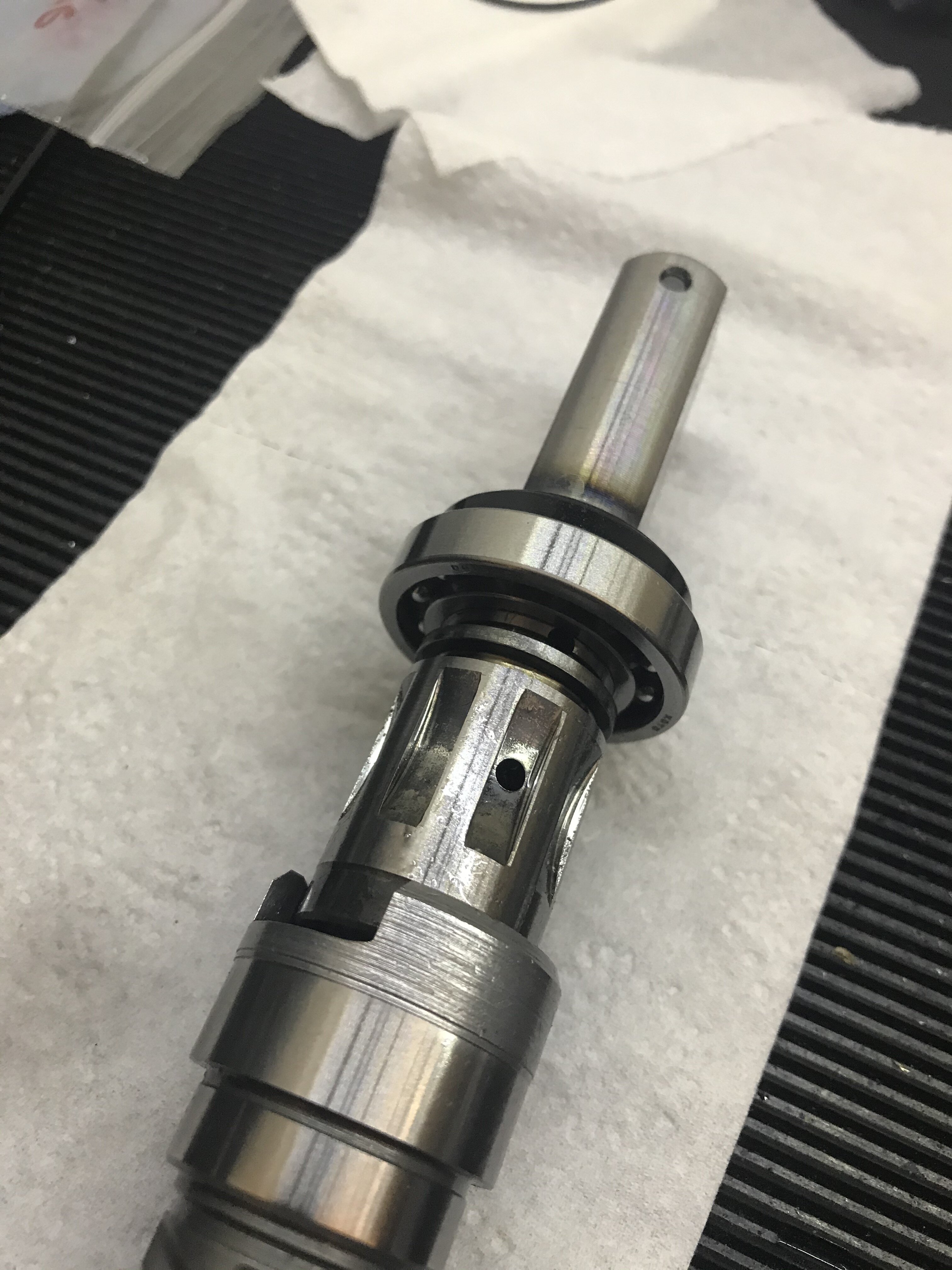

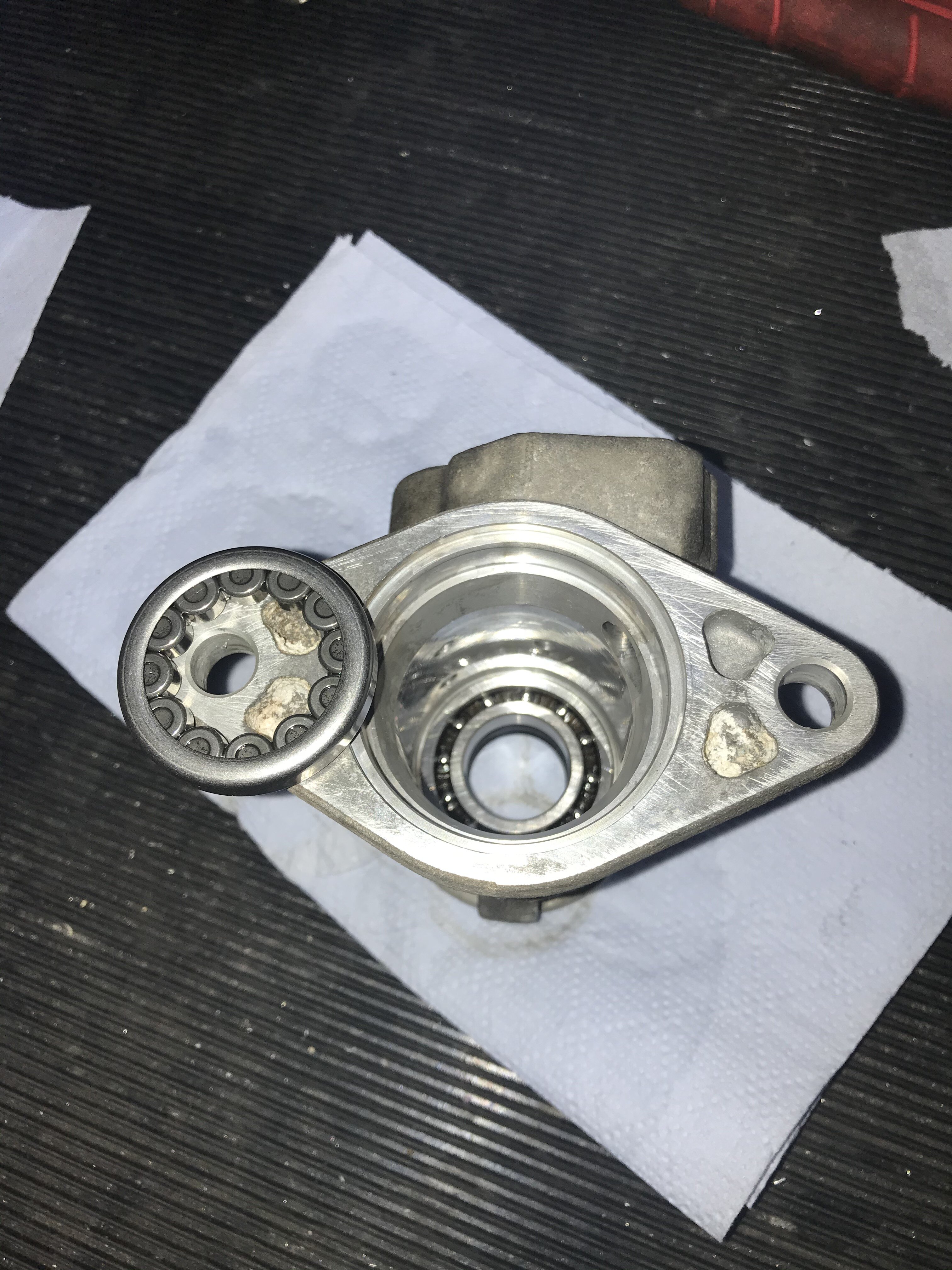

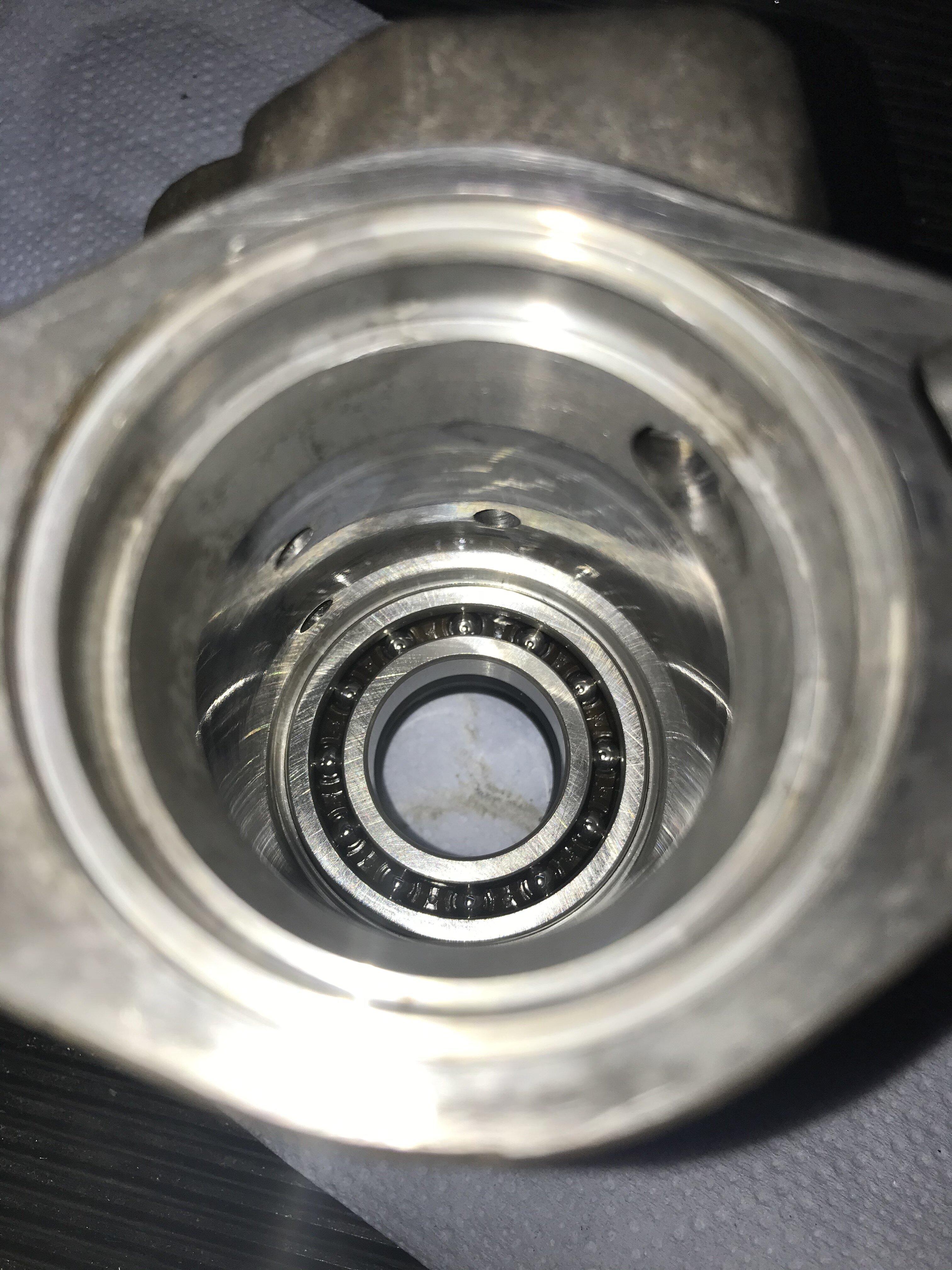

Fit the solid rack mounts, solid lower joint and machine the pinion housing for a press fit bearing. Or just fit tyres with less grip and get a mechanic to glance over the suspension and say he cant find anything wrong.

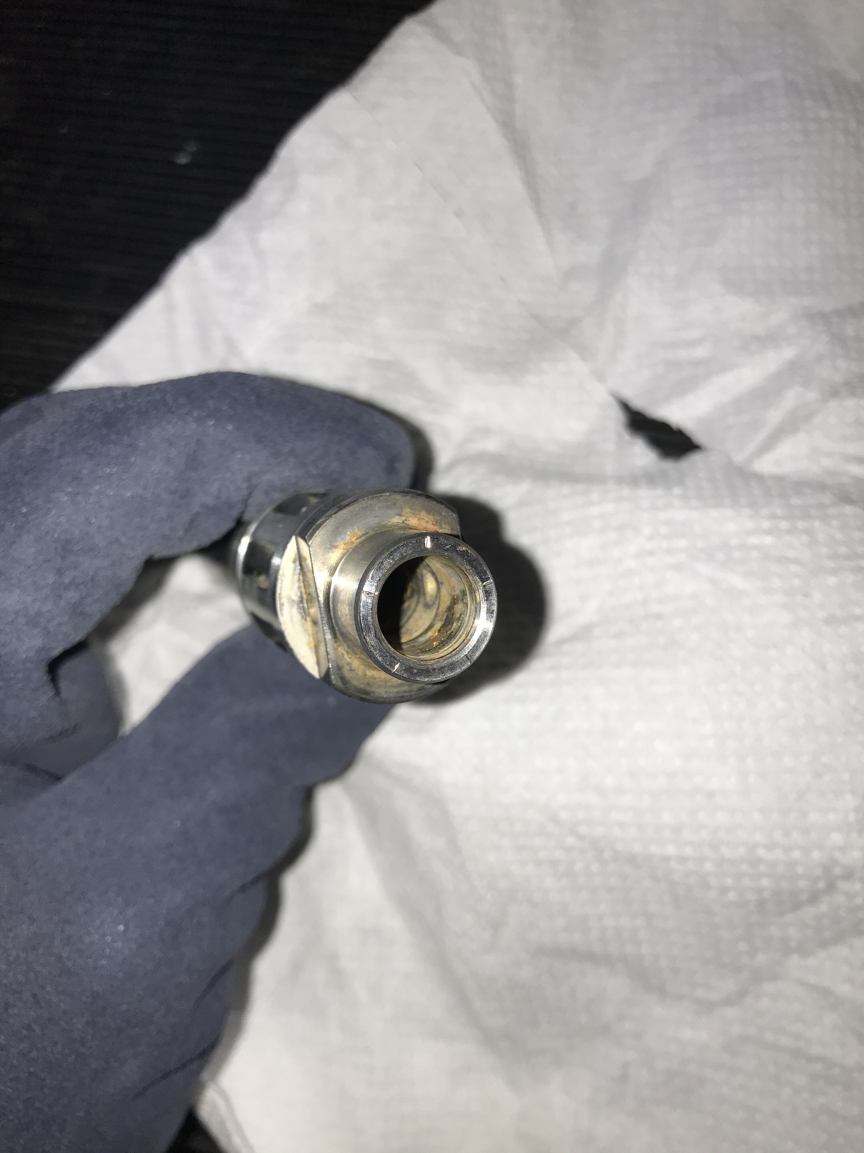

Pics for ref. One thing to possibly bare in mind is only half would be clamped in vice but It does seem a better option than welding as no possible warping.
@Beauvais Motorsport cheers for the pics. I did consider welding too. I have a spare rack, would you consider doing it for me? Also interested in bearing upgrade.
I have a spare machined housing with bearing pressed in so could send you that, Ill double check tomorrow at my unit and get pics. Regarding the pinion itself, Id need a couple bits to do the job and things are a bit hectic at the minute. If you want to weld it I have spare pinions so if anything happens you still have yours, wouldnt want much for the parts..
