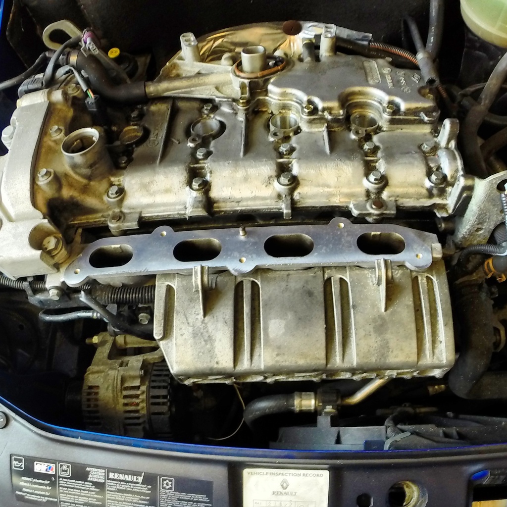

First problem went to change spark plugs and the hole that spark plugs 3 and 4 are in were half filled with oil and im not sure where its coming from any ideas?
Also wondering how to take this part of the side of the lower inlet
It seemed to me like the oil was leaking out of that hole at the back of the engine because all the top of the engine was covered in oil aswell, and are there just two nuts in them holes thats it ?
Needs a new seal in the breather pipe... I can see yours stuck to the top of the engine. Also... Change the dephaser solinoid seal
