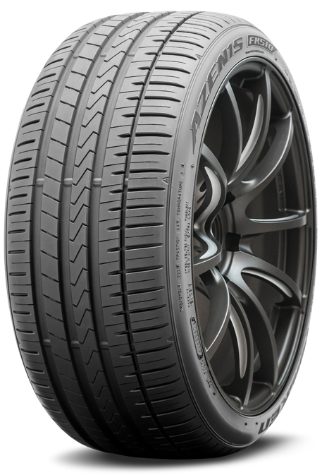

As @imprezaworks mentioned the FK510 are fantastic for the money....£249 delivered.
Check out the reviews.

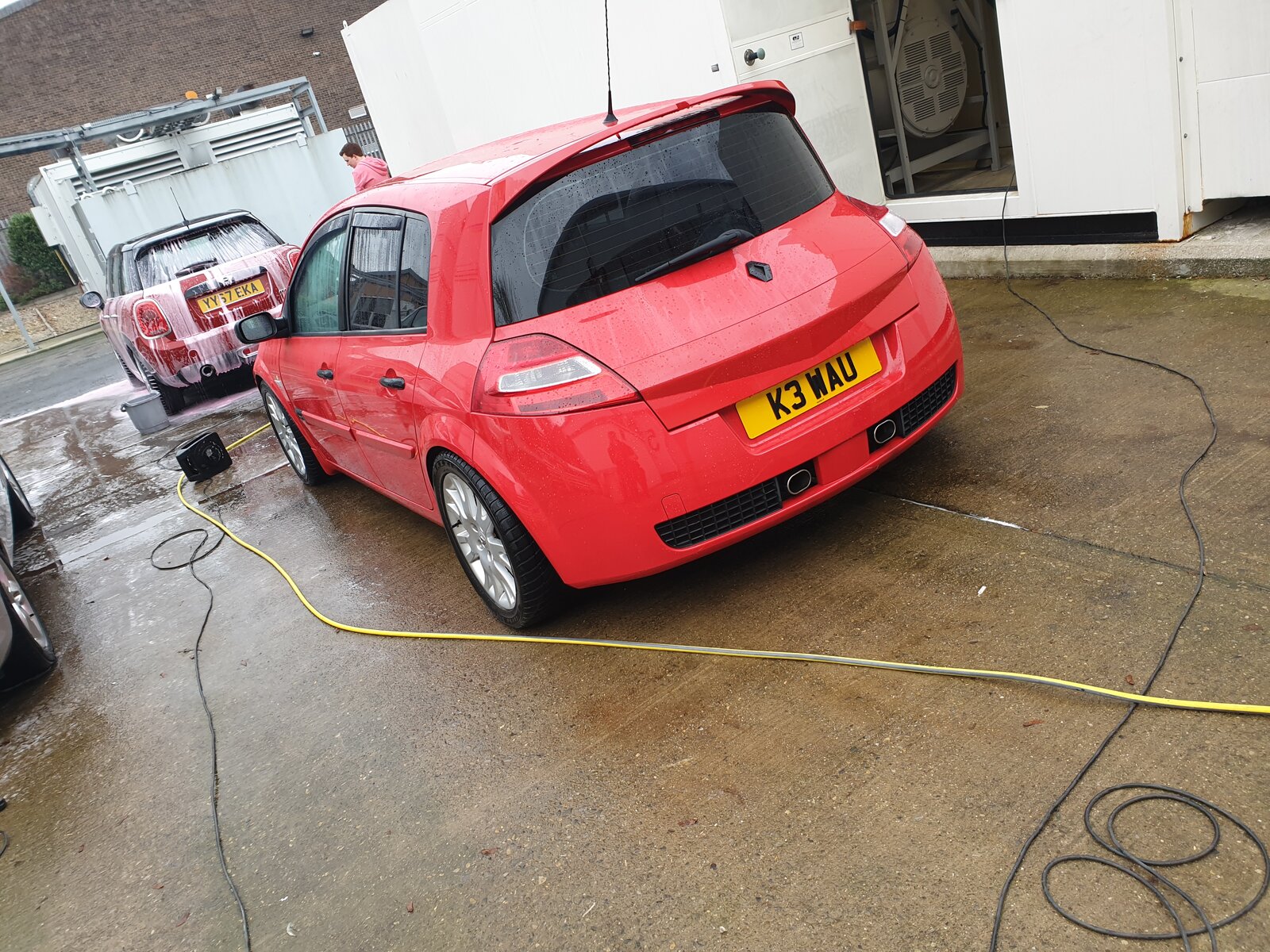

If you zoom on the pic you'll see that 225/45/17 are quite wide for the wheel. What wheels have you got on your 197? These Laguna Silverstones are 17"x7J so would probably suit 7.5J wheels better
But go for PS4's, rainsports are only good in hurricane weather and feel like you've practically folded the sidewall in half if you hit a corner over 10mph. Only experience I've had with Hankooks are when one nearly blew out on my old dCi as the sidewall delaminated 😂
