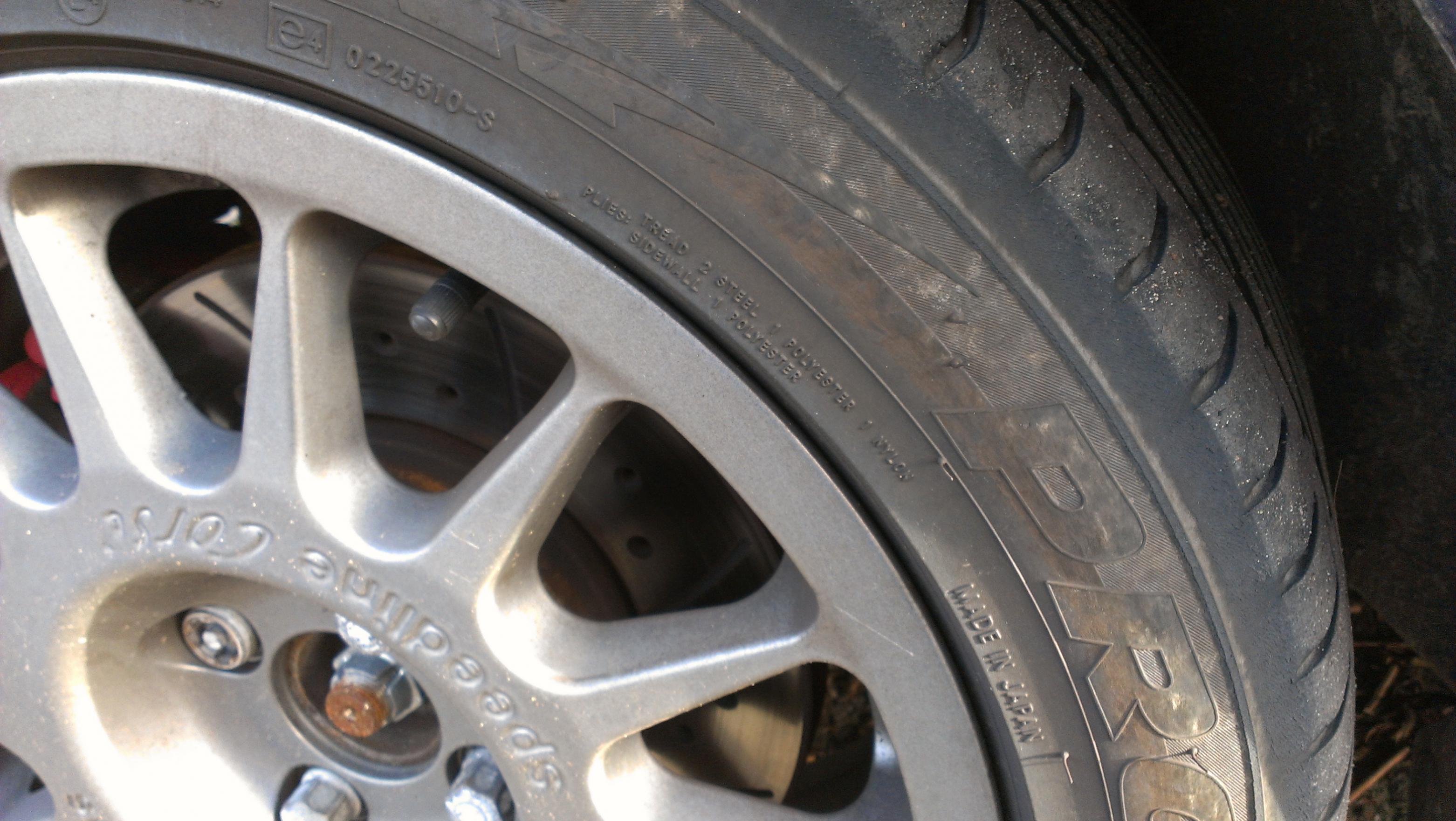

Please see the attatched photo. Is this because of my poor driving? Or is this because of poor tracking? I have had the car tracked 6 times this year alone. Lots of new parts on suspension and steering.
This is drivers side (lhd car), passenger side is not as bad as this side.

This, plus they look like Toyo T1R's which are a pretty soft tyre.
Do you use the car on track at all?
They are TR1's. I have used the car on track... however these particular tyres have not made it to track yet. I'm pretty gutted as they have massive tread right up to the wear on the edge.
Coming off motorways here in the Netherlands they have lovely big sweeping bends, i suspect this is there I have lent on them a little too hard.
  172 Phase 1
Get some negative camber on the front. I put 1.5 - 2 degrees neg camber and solved my problems. Helps out a lot on track too.
You can machine the top hole of the hub to shock mounting point and take it to a decent wheel alignment shop who can get it right for you.

I went through a set of t1rs on the front of mine like butter. I won't be buying them again.
