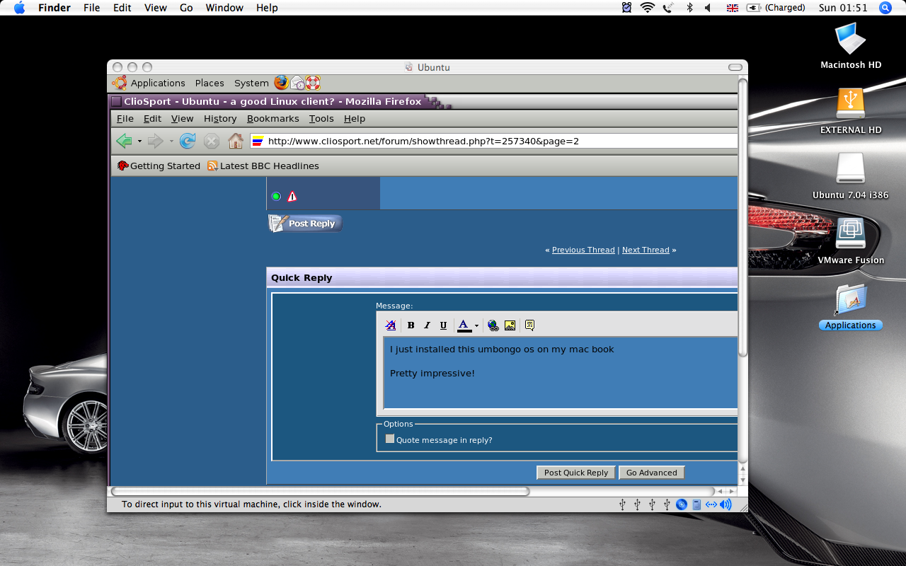

I just installed this umbongo os on my mac book
Pretty impressive!
