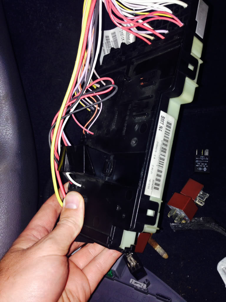

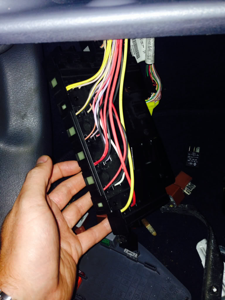

There are wires on the other side if this unit stopping me from removing the unit from the car.
Picture hopefully to help

Have you taken that picture now? Can you take one from a bit further away? You're a bit too close and i'm on my phone.
Bluebeard
  Whichever has fuel
That's not the UCH?? or if it is, i've never seen one looking like that, and i've removed/refitted a fair few.

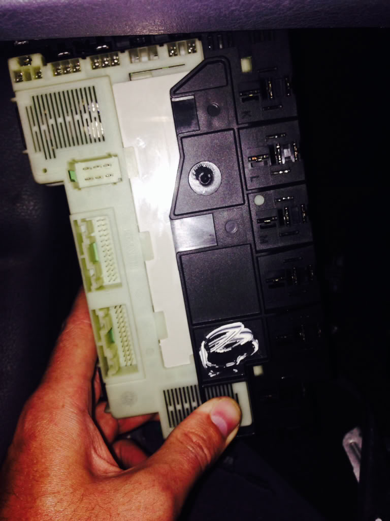

Thats a Ph1, Its more a relay box than a UCH.
You can't remove the wires, but everything you need to see/get at/test is on the bottom visible side
  172 Ph1
It's out!! 2 tabs on the top to release the white plastic cassette.
