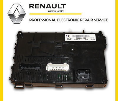

I have a few minor issues with my UCH which will need sorting out sooner rather than later. Has anyone used this service, or can you recommend anyone else who's good around the Manchester area as I use the car daily and need as little down time as possible?

I'm sure these are all related to it but the car is driving fine at the mo....
Only the bottom half of the heated rear window works
Sometimes on intermittent wipe the wipers just keep going
Sometimes the heater control lights on one side are dim
The lights left on alarm doesn't sound (sometimes it will)
Seatbelt unbuckled alarm doesn't sound (sometimes it will)
Indicators don't 'click' (again, sometimes they will click and then stop again even before the signal is cancelled)

I don't know but I checked mine and couldn't see anything wrong. It'd take an auto-electrican to suss it out, I guess.
Only the bottom half of the heated rear window works - rear screen bars are damaged.
Sometimes on intermittent wipe the wipers just keep going - poss uch
Sometimes the heater control lights on one side are dim - bulb needs changing or fitting tighter

All the above sounds like issues with the clocks as sound comes from them from memory. Might be wrong
