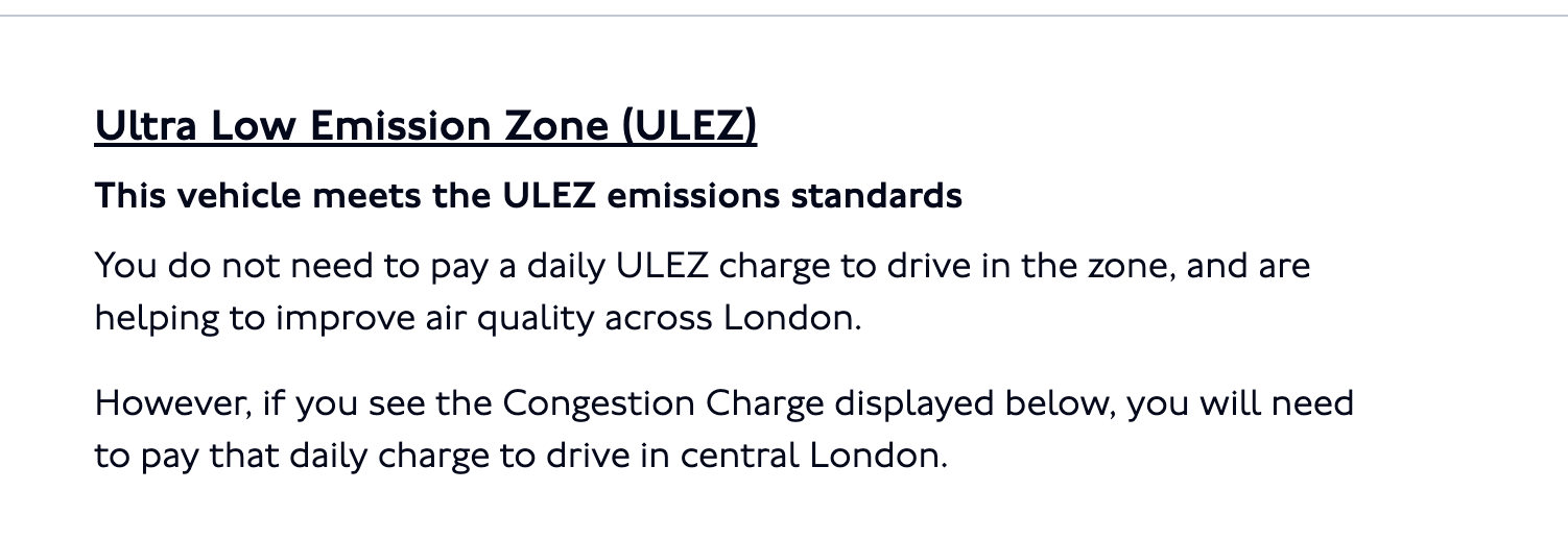

Has anyone regularly gone in/out of the ULEZ are since September 2022 as I believe that's when it was changed to Euro 4 for petrol cars ?

I'll still keep a screen grab of the TfL web site though ..... :)
