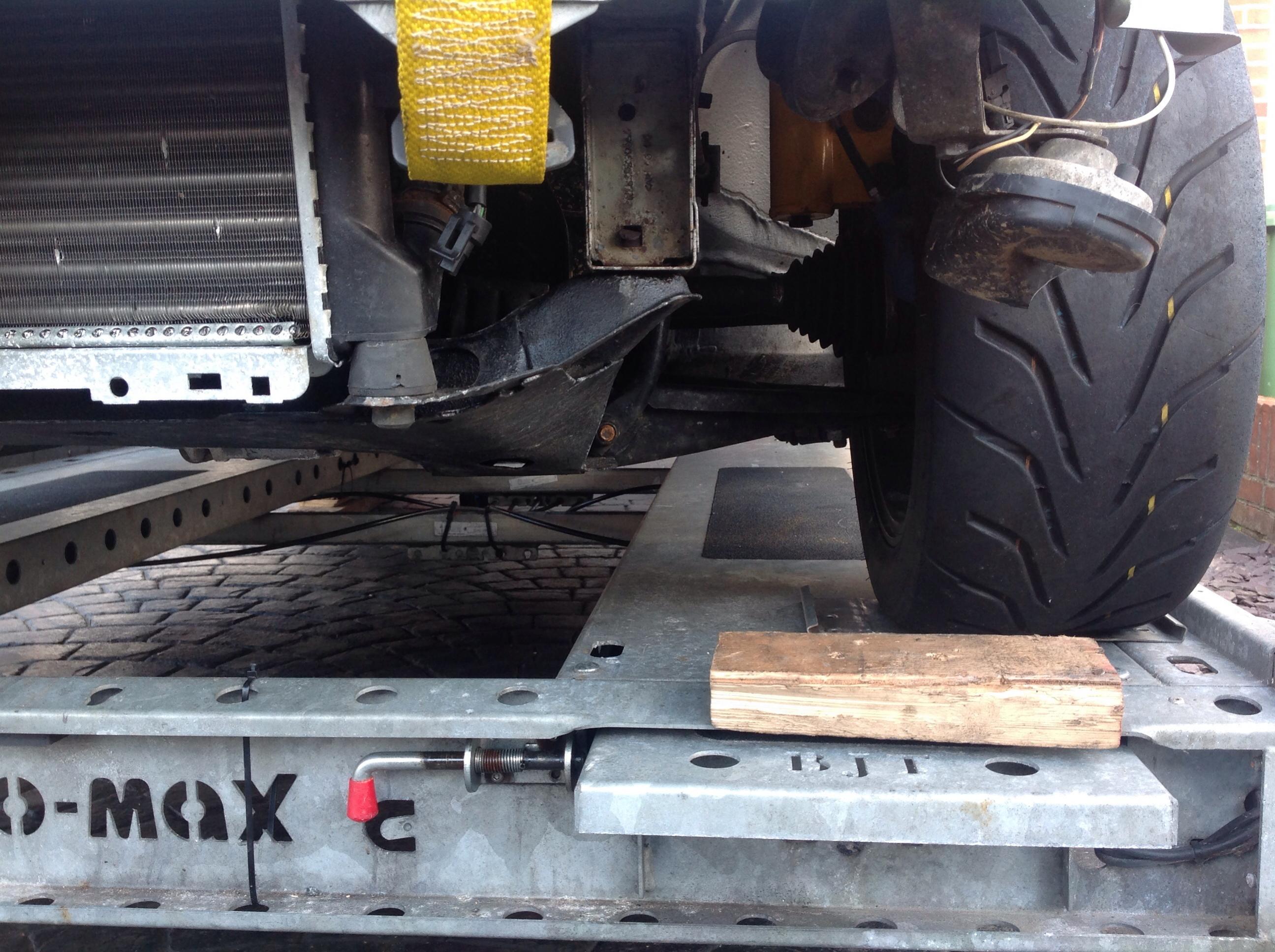

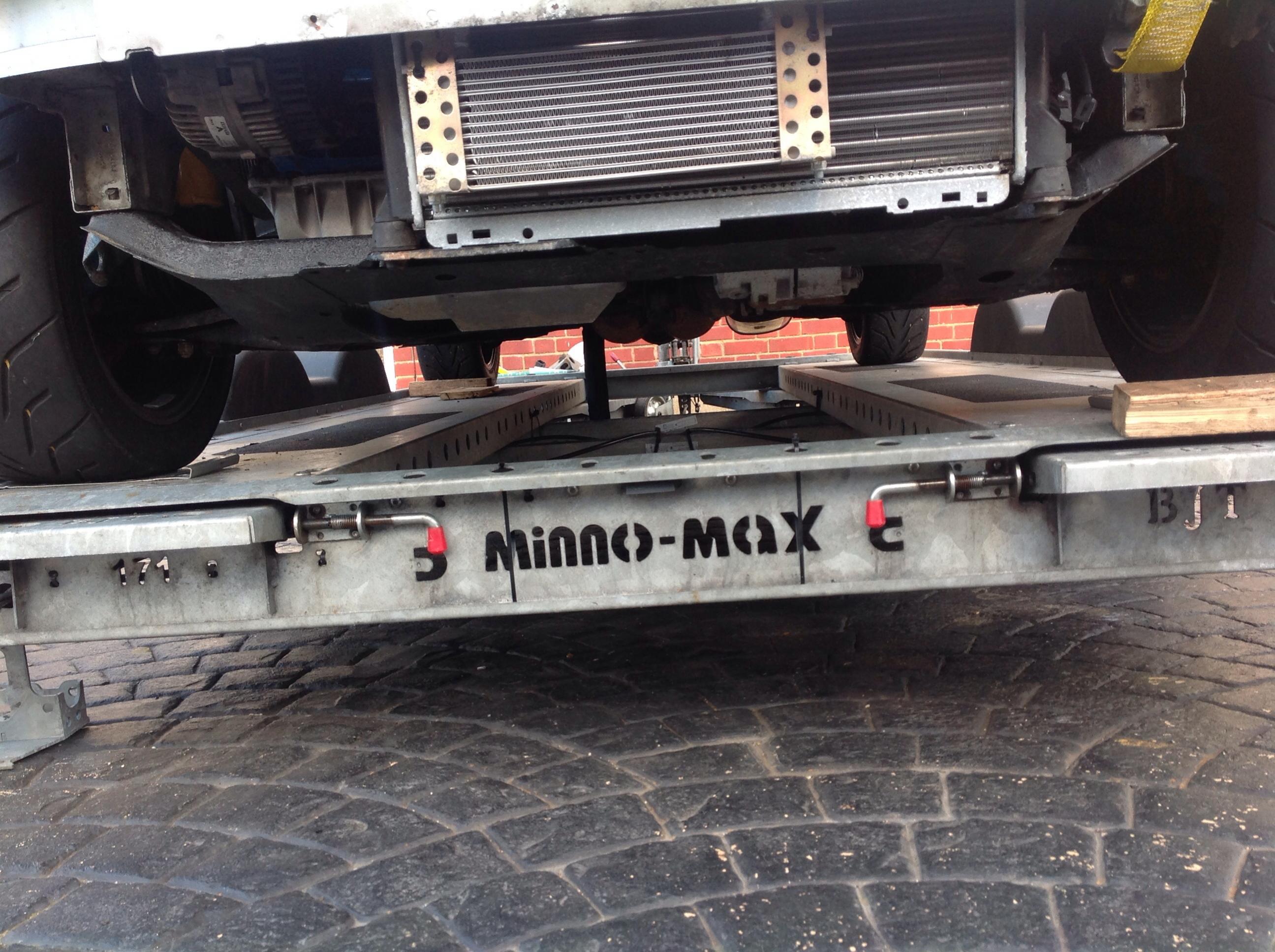

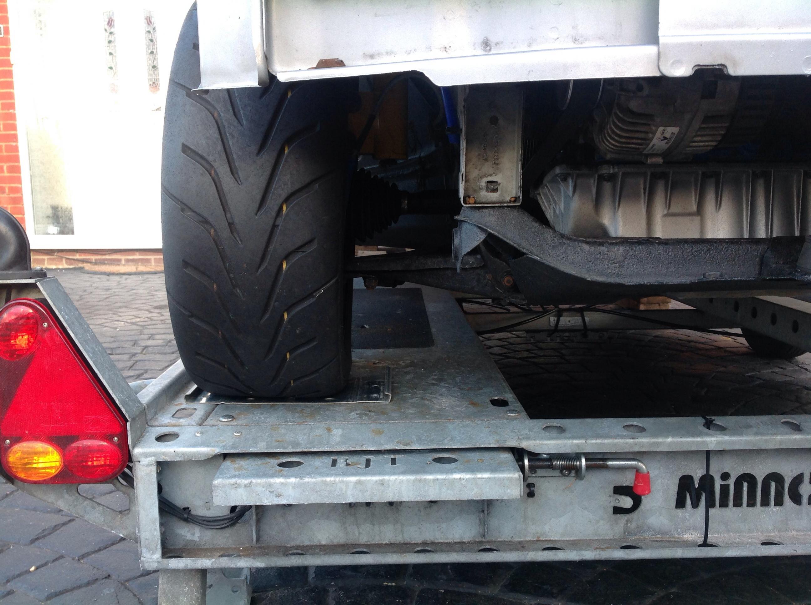

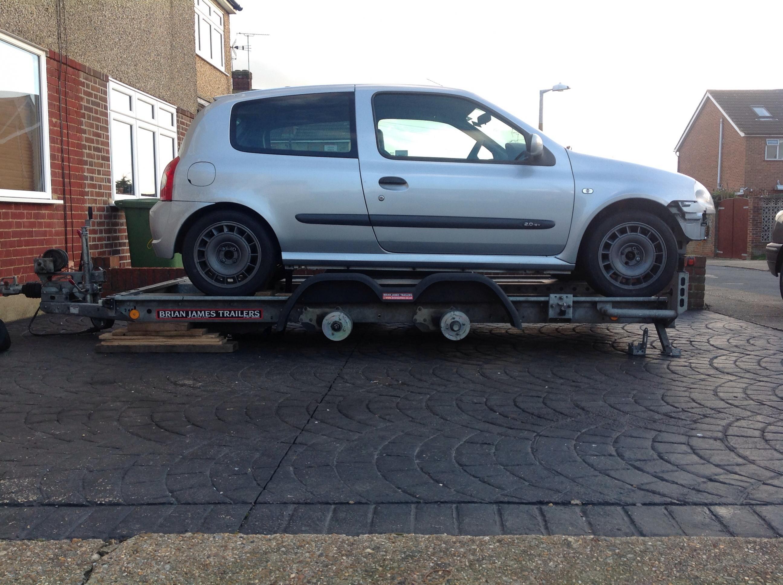

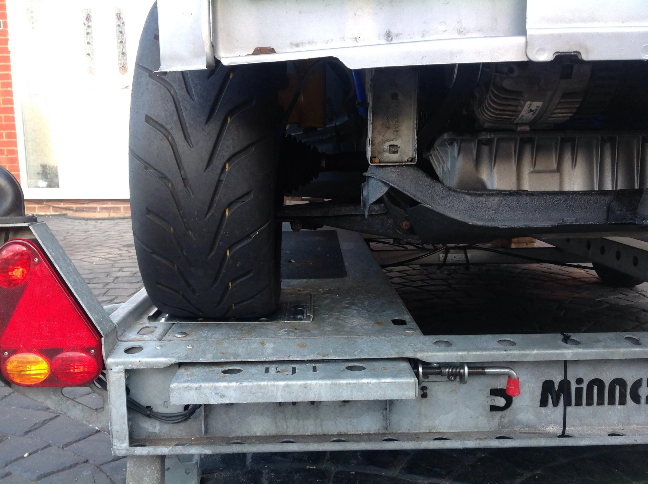

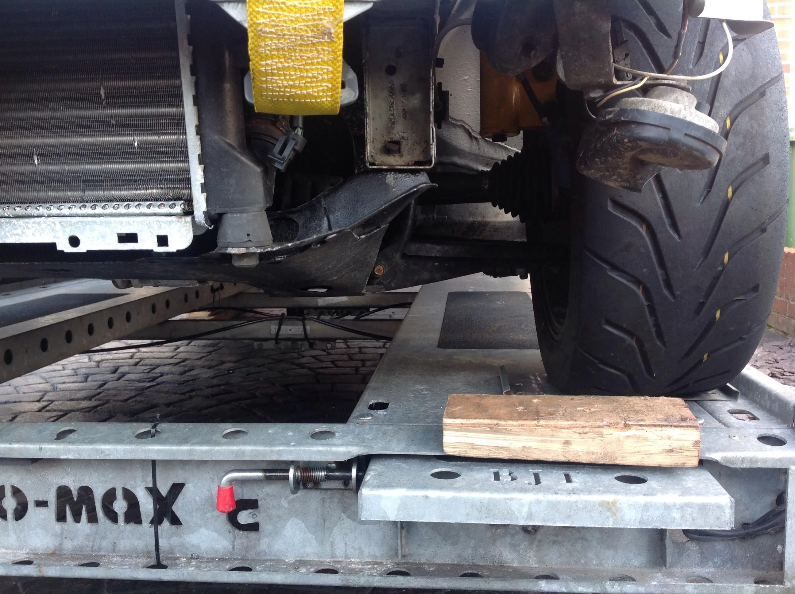

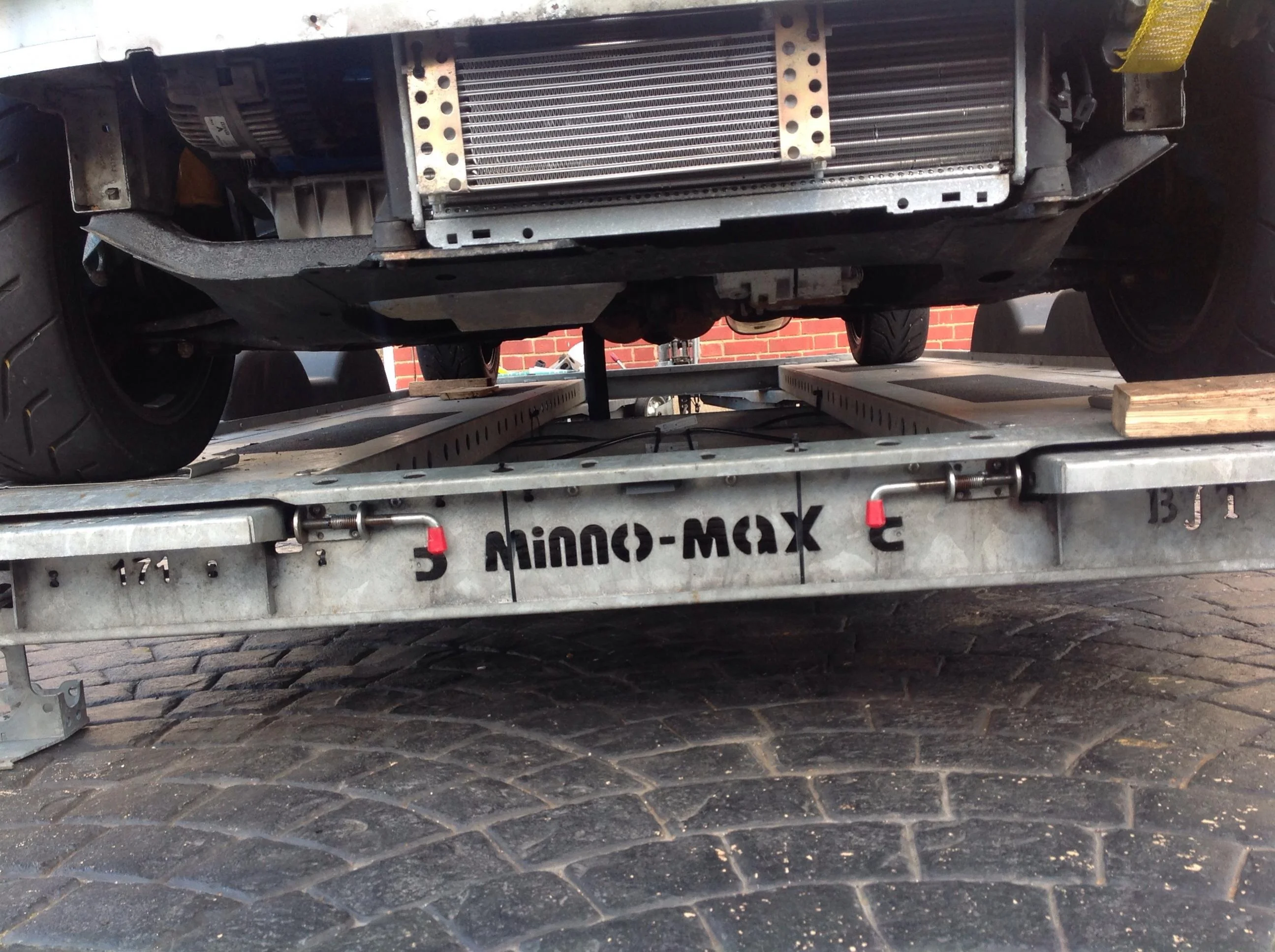

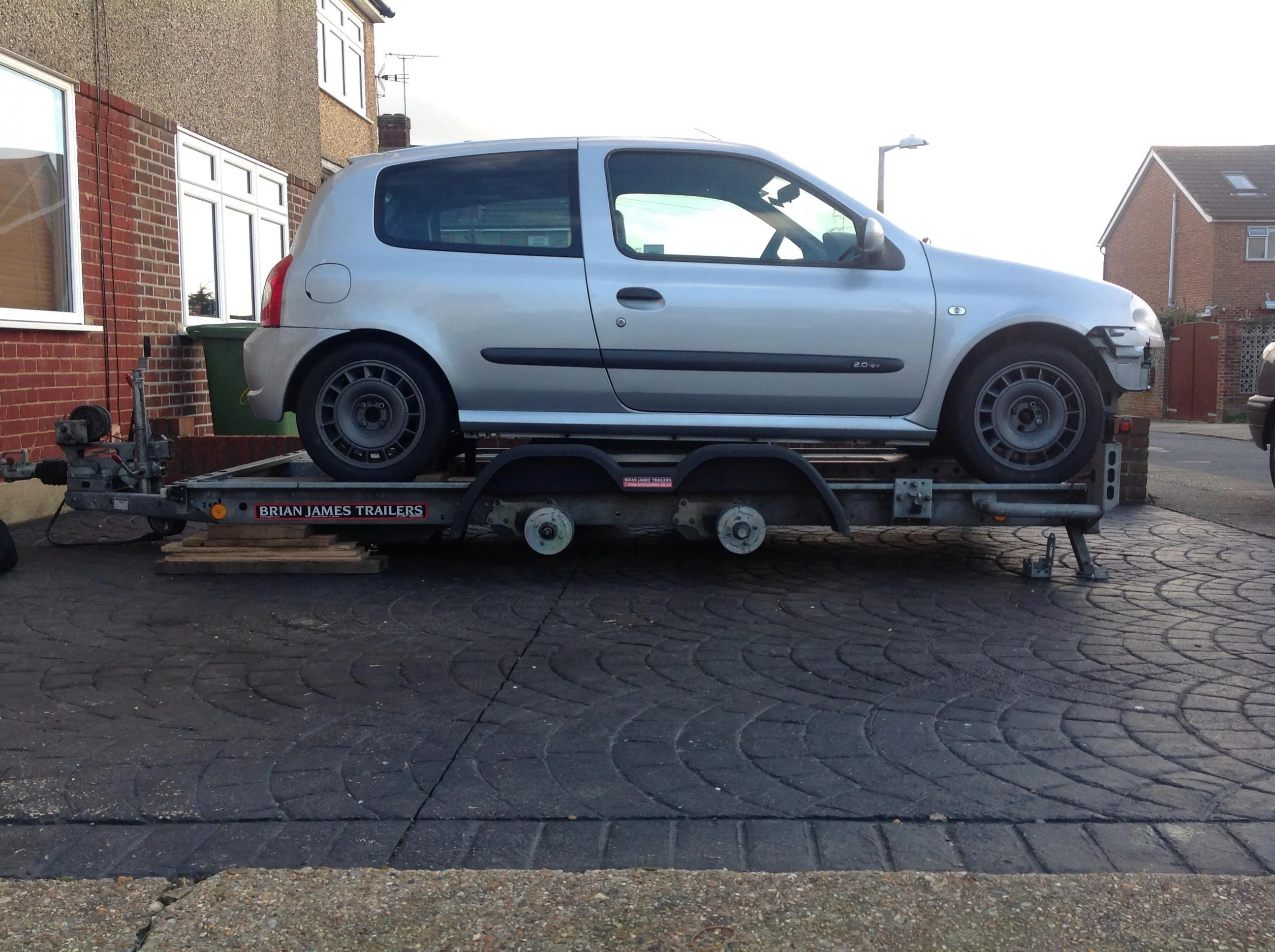

I have now raised the whole car up. The front took quite a lot of winding to make any noticeable difference. The wishbones and driveshafts now look to me to be at a more suitable angle. Measuring from the sill there is a 25mm rake although it doesn't look it in the photos. Front camber -2.25, Rear camber -1.7,I haven't set toe yet. What are your opinions now guys?
View attachment 108414View attachment 108412View attachment 108415View attachment 108416
Wishbone angle looks loads better mate. You'll definitely feel a difference from it. Personally I'd be very tempted to run a tad more camber up front as well. No more than 3 degrees though. My wishbones look similar to that, but I'm lowered a good 50+mm ;)
Set the tracking and get it on track for a shakedown now. Report back with how it feels and what it's doing and we can go from there. Does it have adjustable dampers? I can't remember now tbh. Is it on Gaz?

Cheers mate. The wishbones look better but the whole thing looks so high now, it will be interesting to see the difference it makes. It's got the half coilover spax kit with adjustable dampers. I might look into changing to a full coilover set up later on because I don't like the rear spring set up that much. Will probably go to brands on 17 February to try it out and I will report back.

Yeah I'd say your about 10-15mm lower than standard at that ride height now mate tbh. Did you ever post/find out what the spring rates are on the spax setup?
