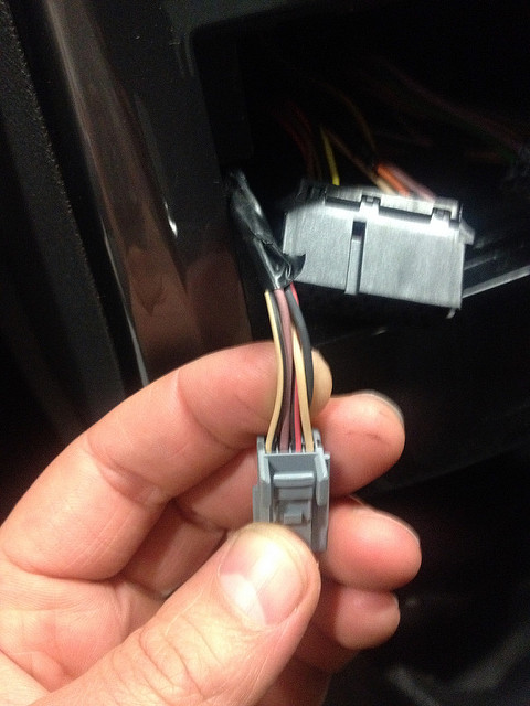

So I've searched through the forum - and despite a lot of other unknown plugs, I can't find any info on this one.

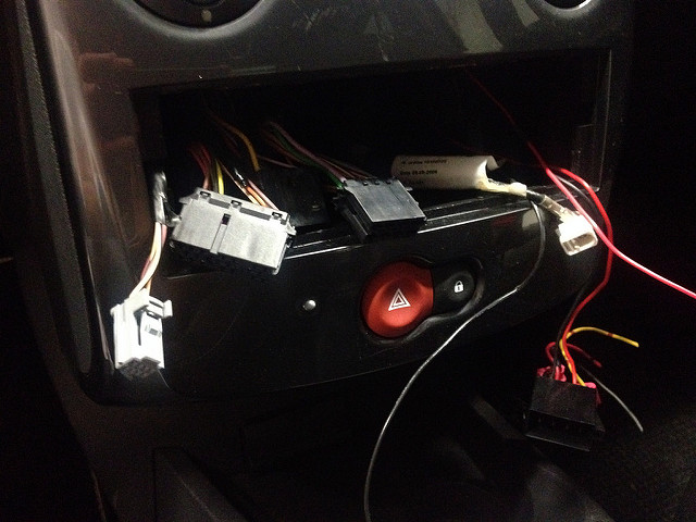

Previous owner had an aftermarket stereo (which he removed) so now I'm going to connect a factory Clio radio - and I have the following plugs:
3 black plugs which connect to the standard radio
1 white aerial plug
A home-made connection for his aftermarket stereo - to get power I presume? I'm hoping to ignore that plug (on the rhs of the photo)

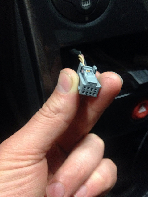

But what is the grey plug for on the lhs?
I don't know if its something to do with the display (I haven't had that working yet because I don't have the radio sorted)?

Quite possibly the display/stalk control connector, it's yellow on my Ph.1 though.
If it doesn't connect to the radio - where would it plug in? This may sound like a stupid answer - but its not long enough to get near the steering wheel, and comes from the left, from the glovebox direction...
BoatNonce
Should plug into the back of the stereo.
Could also be the CD Changer connector too at a guess.
If you plug everything else in and turn the stereo on, does the information show up on the top dash screen?

thanks everyone for your advice...I'll ignore that plug for now as it seems to be suggested its an optional extra.
I can't seem to get the radio working though - whcih is odd. I can get power (the CD slot ejects), but no sound/stations/display...

Looks like u got a mk3 onwards from pics - u will need an ignition feed to aftermarket stereo - spur fuse or tap off cig lighter (if its ignition fed)
