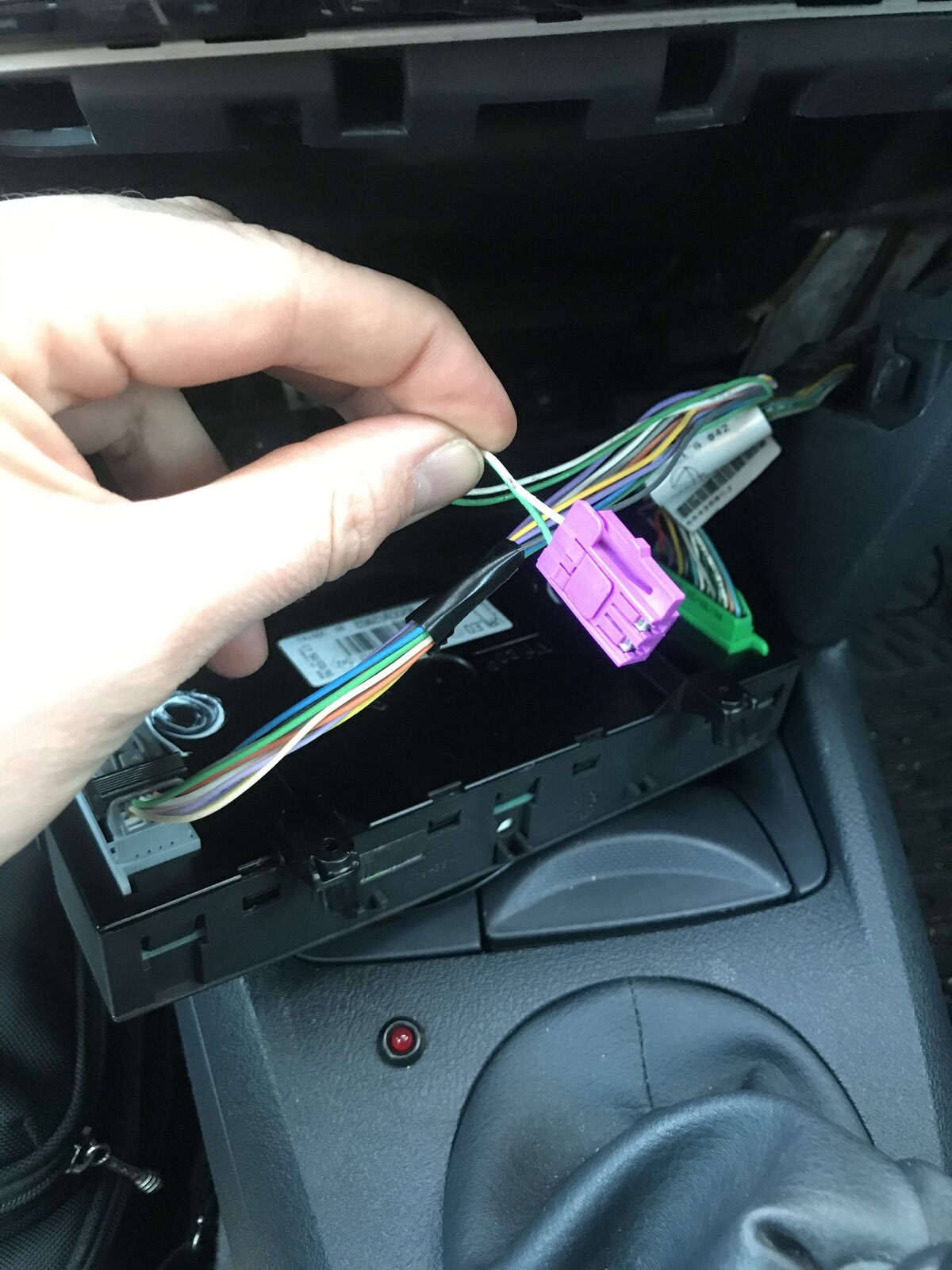

When re-fitting the climate control panel in my 2005 182 I noticed two wires that were poorly taped up by a previous owner. I unwrapped it and the connector is blue.
It runs with the bunch of cables that connect to the Auto / Off side of the climate panel.
Just wondering if anyone knows what it is supposed to connect to.

Well I did not explain the details, but there was a piece of tape-backed foam wrapped around the connector as well as electrical tape. Certainly looked like a diy bodge rather than factory.

Bodges don't use fancy foam covered tape.. it would have been sellotaped to the bulkhead.
There would have been one loom available when they were being built to save money, especially if the only difference was one connection.

Thanks, although actually I’m just curious.
I recently removed all interior soft touch plastic for refurbishment and now re-fitting
Clio_fool
Yeah the faom is factory protection on unused connectors. There's probably one behind the panel where your cruise button is that would adjust the headlamps on other models.
