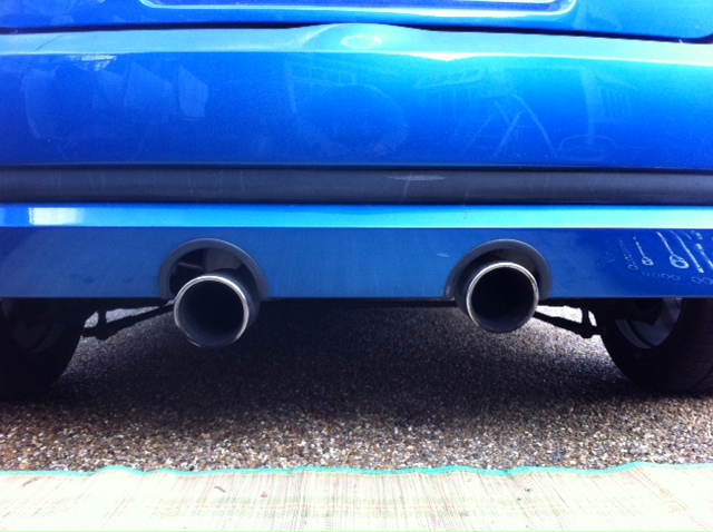

Mine before:

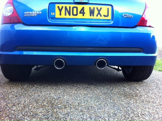

And after:

i did the above with just a cheap halfords universal exhaust hanger, worked pretty well!!
but now that the mot station have pointed it out, they might try and insist you get a proper replacement! :(
